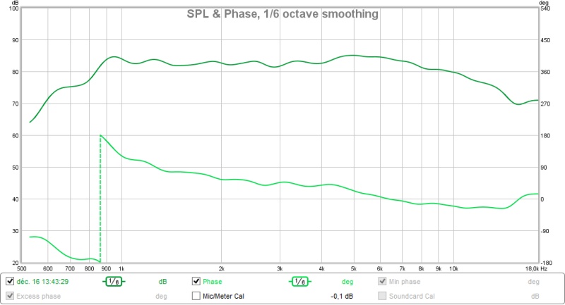

Fabrice,
This sweep of yours ( JBL 2426 on PRV 152i clone );
Is this without EQ?
Also, how much ferrofluid was added to the gap?
Do you have any before & after sweeps that show the effects of adding the ferrofluid ?
Here are a pair of my ( raw horn/driver ) REW sweeps ( 2 different vertical scales ).
I'm now wondering if the addition of ferrofluid might actually knock-down ( flatten ) the 1K-2K hump that's seen in my pics.
- Your trace is very flat ( by comparison ) over this same area.

Yes the sweep is made without any EQ , the amount of ferrofluid is 0.450ml per driver .
I have made some mesurement before and after but it was without the horn , main differences were , lower distortion and an cone like sound with ferrofluid ,an "flatten" curve at 1.5 khz and - 5 db at 12 khz.

Fabrice,
Thank-you for your response.
Your results are consistent with info I was given ( many years back ) from a contact at Radian ( when I asked about ferrofluid ).
( Thinking Outloud ),
- I'm not sure if I could afford a minus 5db drop in the UHF since the 2426 is already challenged in it's top octave when compared to more modern drivers .
- If I try ferrofluid I might first try one half of the amount you've used.

Fabrice, do you still have the 'raw' sweeps without smoothing? This looks quite good, I wonder what the impact of the 1/8 oct. smoothing is.

here you'll find mesurement made with and without ferrofluid , 1/6 db smoothing , without horn , at 1 m , less than a watt .
green is with ferrofluid
red is without ferrofluid
here are the same sweep , but without any smoothing .
What ever happens , with ferrofluid is better , sound is smoother , a nice "HIFI" sound ;-)

Thanks Fabrice!
Very interesting.
Since I own scores of 242x type drivers, it's useful to know about this mod.
