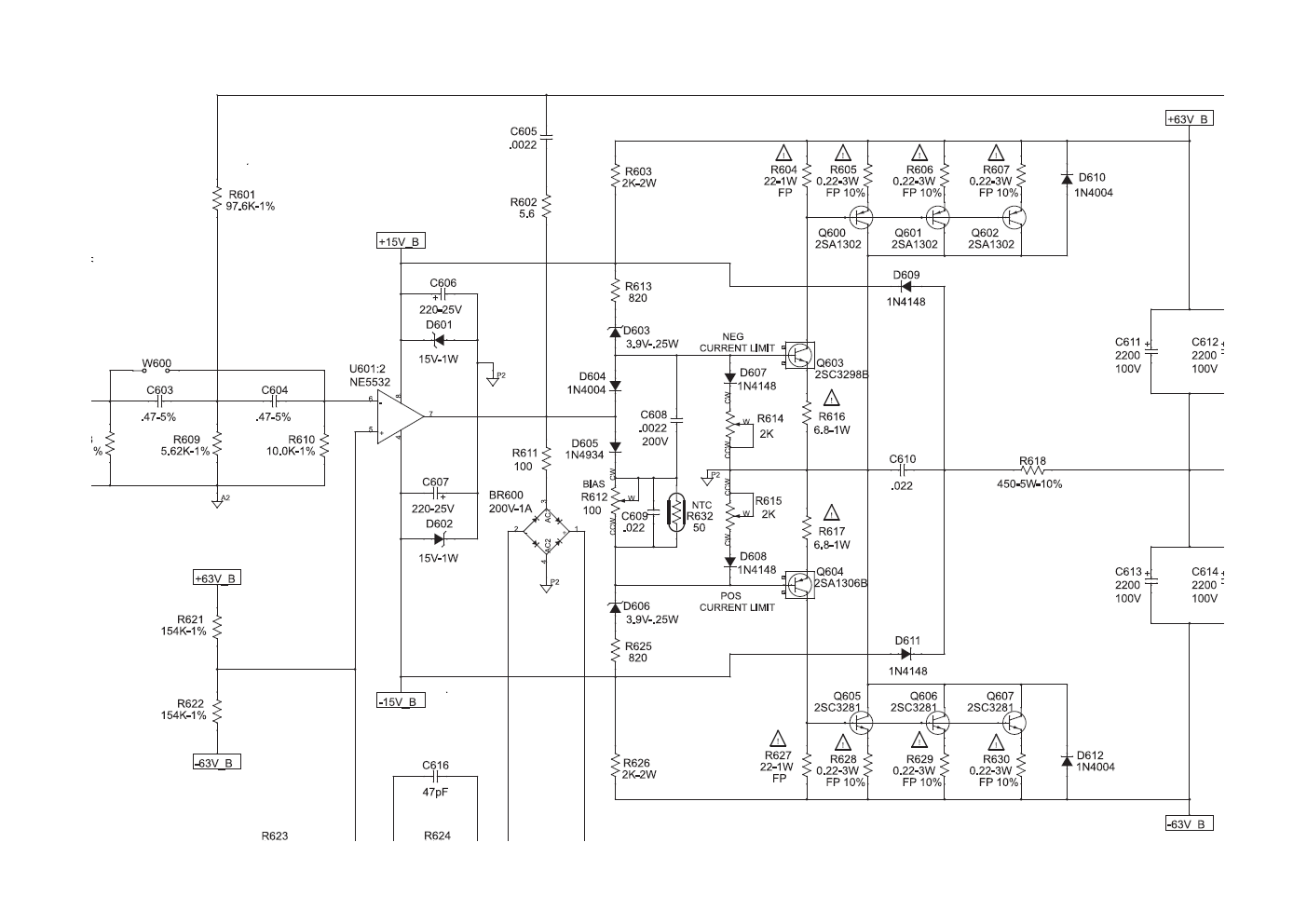

QSC CX4T Help ....
Even though the circuits is very simple i got puzzled ...
I am missing 15V rails from both ch
2K2 voltage drop resistors are fine also getting relatively hot
15 zeners are also fine
220uf capacitors are also fine
Removing op amps in case of serious shorts to relief the rails changes nothing
Even though schematic is available on the internet it seems that the actual amp has more parts on it than exist in the schematic .
Weird is that both ch have the same failure
here is a pic of the schematic
QSC have done lots of weird things starting from USA series ( eventhough weird actually work pretty well )
Please look at the circuit and share your opinion
we have noticed that thermistors that are stated in the schematic as 100R when cold in a room temperature measure 41 and 50 R each
So if these fail regardless the temp of the amplifier Q51 will shunt 15+15 rails to stop the amplifier ...
Be careful, as the protection circuit is related to the -63V rail. So the lower the ressitance of the PTCs are keep the amplifier working, as keep the base of the Q50 close to the ground. High resistance let the base to be negative, and trigger the protection, if I understand right.
So 40-50 ohm would be OK. Just chech the base voltage of Q50, it should not be lower then 0V.
