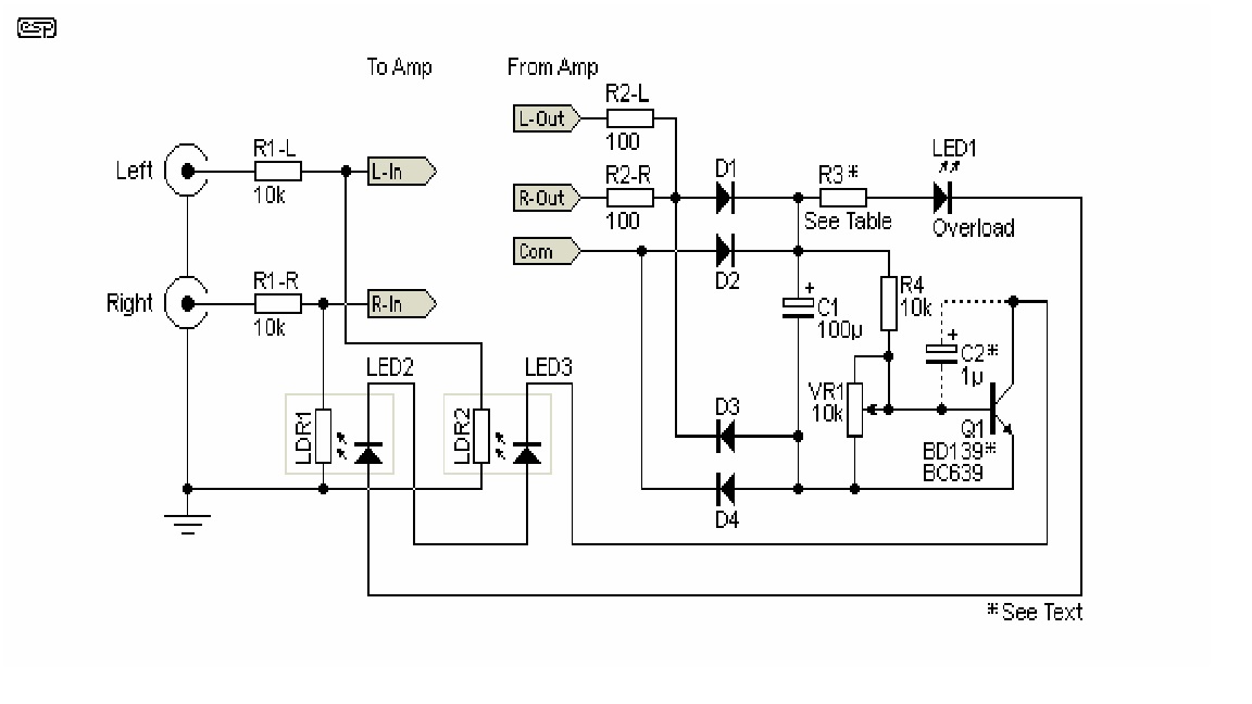

I want to put the clip limiter on my own amplifier. We don't have our amp. You're opening everything from the mixer to the amplifier is burning İndir qsc cliip limiter amf, pdf
I understand you are using your PA amplifier LOUD, are burning speaker components, and want to copy the QSC Limiter to add it to your non QSC amplifier.
It´s not easy, it´s a very good but complex limiter but most important it´s not a separate sub-module, it is part of and fully integrated with the QSC power amplifier .
You can not "pull it" and attach it to a different amplifier.
Besides, we don´t even know what amplifier are you using today.
I suggest you get an external limiter, insert it between Mixer Out and Power Amp In and set it so your Power Amplifier does not clip.
Which by itself is a separate task which requires its own dedication.
