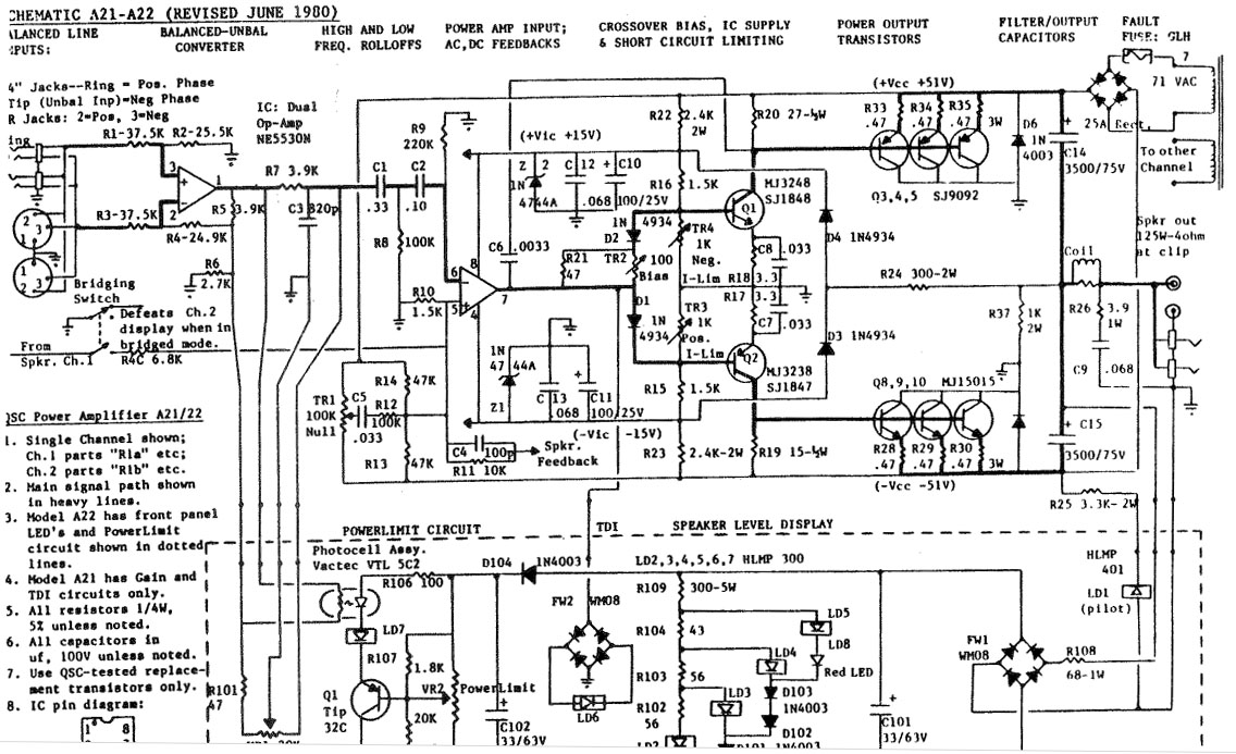

The current limit of the opamp (about 40mA) together with the capacitor C4 (2.2nF) limits slew rate to about 20V/µs for large signals (it can go faster for small signals because of the series resistor), but other effects may limit it further. For one thing, current slew rate is limited by opamp output voltage slew rate together with output stage transconductance and this could become the limiting factor for heavy loads.
But doesn't C4 also swing with the signal (both sides), except for the voltage actually across it? It must be the voltage across C4 that determines the charging requirements, no?
jd
or you could have said: the the time rate of change of the V difference across C4 determines the charging current
since one end swings with the output signal V you have to push "Miller multiplied" charge into C4 from the op amp output - or just do the calculation with the actual V difference rate of change by working backwards form Vsupply and sine wave max slope to get "power bandwidth" which is directly porportional to slew rate
the op amp output V however moves only a few V (if that) since it drives the grounded Q bases through a bias spreader with pretty low Z

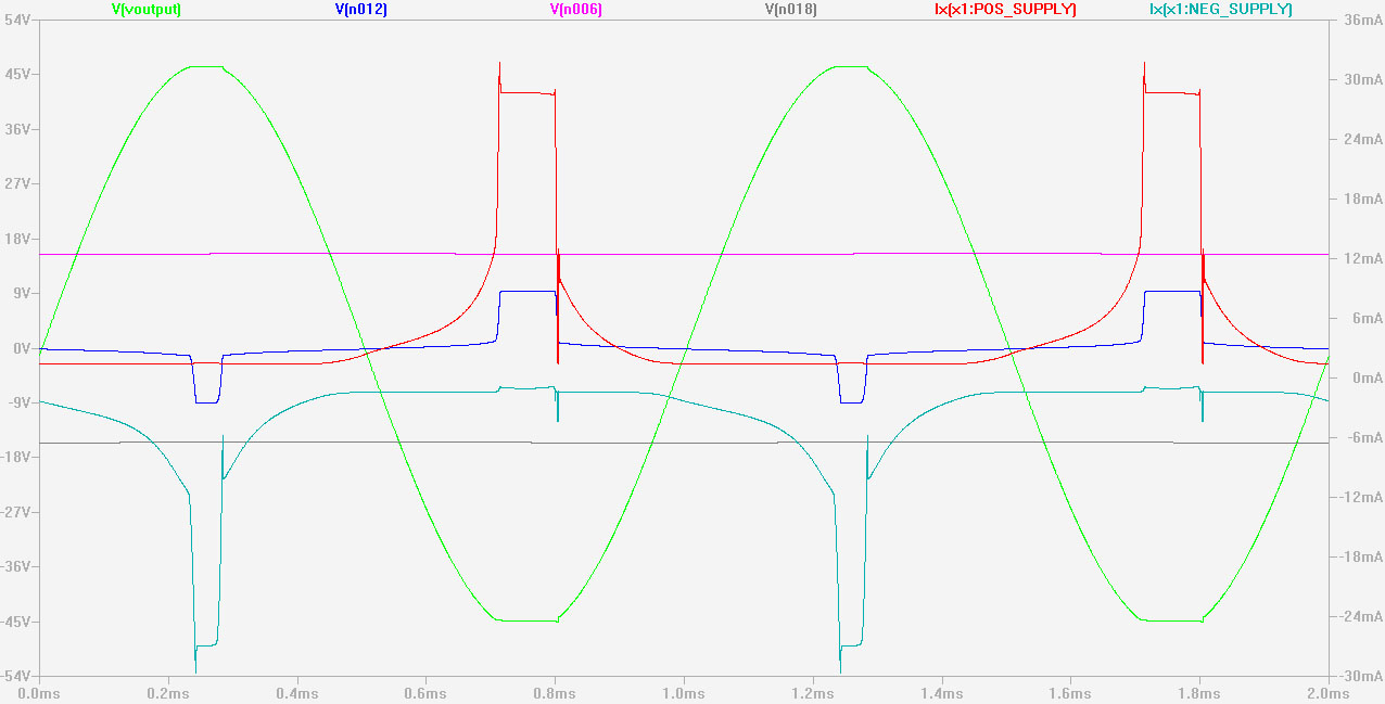

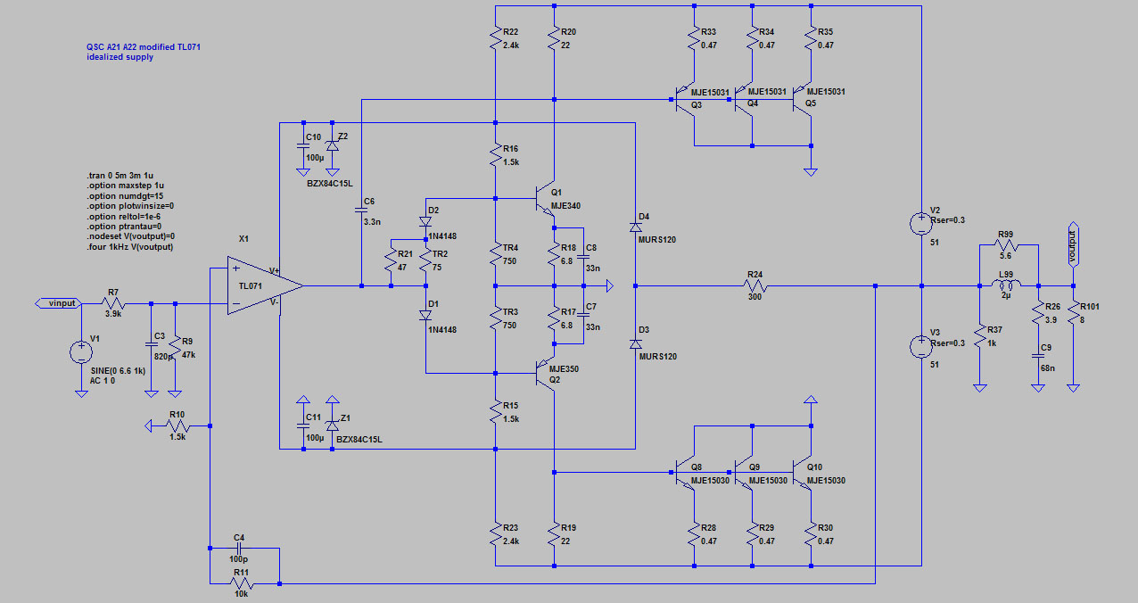

Just completed a LTspiceIV simulation workbench. Working nice, but I needed to idealize the power supply arrangement using two 51 Volt voltage sources in series with a centre tap. The "real" QSC has only one 102 Volt supply without centre tap. See attached files.

If we are talking C6 in Steph's sim circuit above, the far side of C6 doesn't swing much, and neither does the opamp output. So despite it looks like the opamp is heavily cap loaded, it isn't that bad.
Too lazy to do the calcs...
jd
It is connected to a node that is within a volt or so from the power supply which in turn follows the output signal. Remember, the power supply is floating!
The "far side" does have the full output signal swing. Some of the QSC circuits actually have it connected directly to the output node instead.
AX tech editor
Joined 2002
Ahh yes! Thanks,

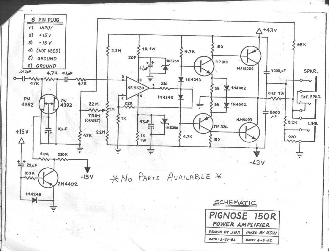

Take a look at Jim Strickland's patented amplifier the TNT 200 marketed by Acoustat.
Quilter Sound has been around since 1968 and as far as I know, Pat Quilter was making grounded output amplifiers already in the mid / late 1970's. They aren't well known designs because back then Quilter Sound was making guitar amplifiers.
Versions of Pignose Crossmix 150R predate TNT-200 and the whole design is a descendant from an earlier Pignose 30/60 design, which was OEM product from Quilter Sound.

Like mentioned earlier, a Dutch high-end audio manufacture "van Medevoort" (Audioart producent van de van Medevoort geluids apparatuur) had a concept with a one capacitor floating power supply. However non of the sides of the bridged amplifier is grounded. They just had the whole circuit floating above ground and referred to the opposite phase. (the DC power supply rails and the audio lines). e.g. A compensation capacitor was connected between the + and - line input lines instead of signal and ground. I wonder why they choose this design approach. The benefit I can think of is no heavy pulses in the (now non excisting) ground line.
With kind regards,
Bas
With kind regards,
Bas
It's probably cleaner that way from an audio perspective. BUT - the Crowns being commercial amps, one side of the speaker and one side of the input must be connected to earth ground.
But the whole power supply was also floating and no centre trap from the trafo. There was only one big philips cap between the + and - of the bridge. Even though different then the crown I wonder why they did that.
with kind regards.
