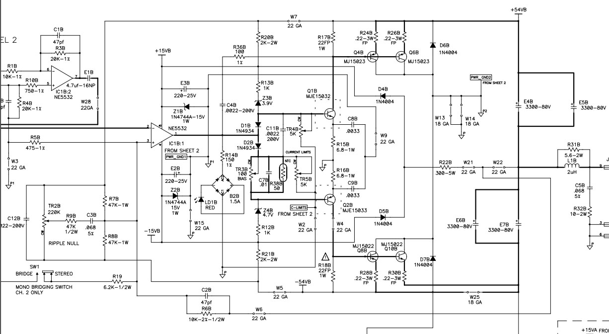

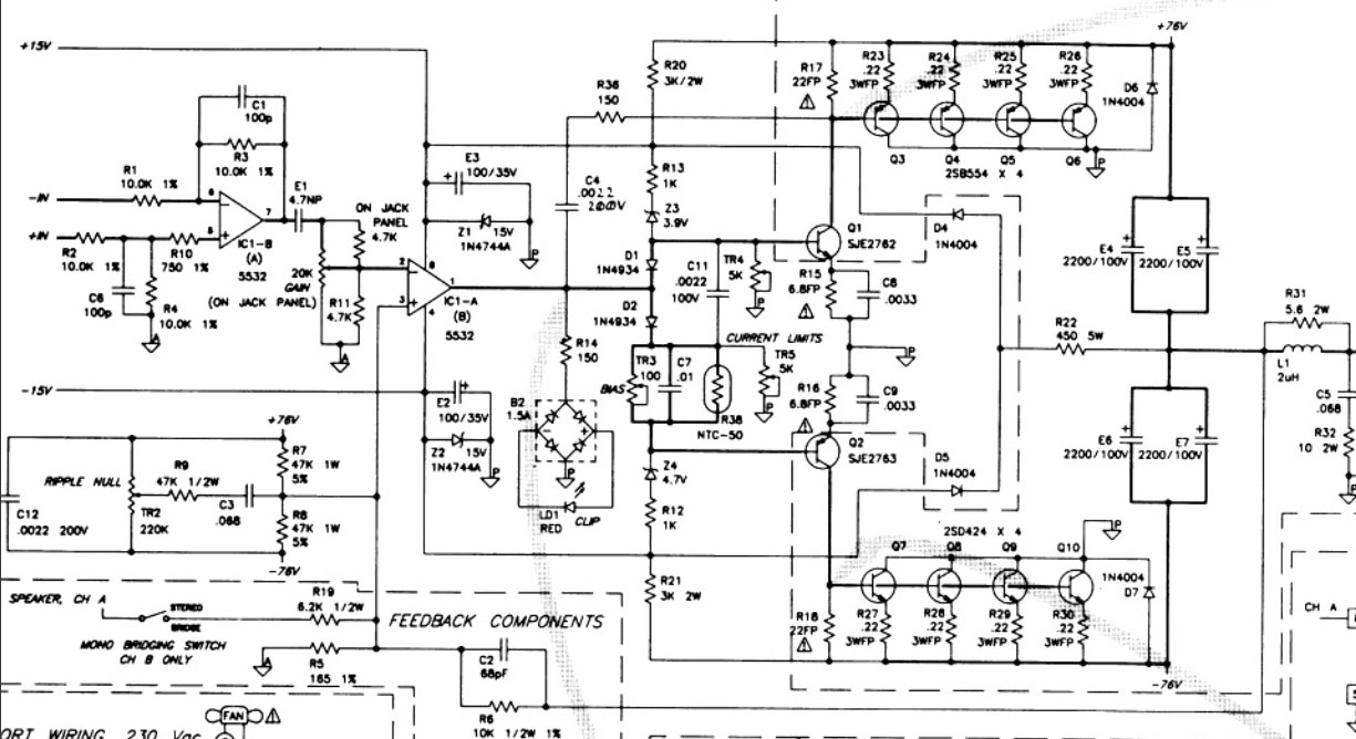

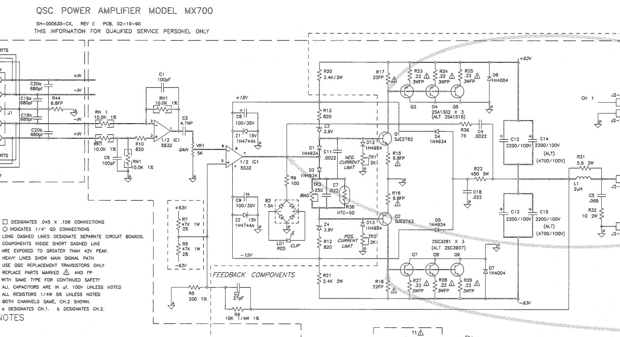

Yes, that's my understanding. When you look to the attached QSC 1400 or QSC MX700 schematic, how would you calculate the theoretical slew-rate ?
Hmmm, good question. In principle you would look for a node that has a capacitive load that is charged/discharged up to a high signal level with limited current, but to be honest I don't see that right away. I'll try to look at it some more later.
The current limit of the opamp (about 40mA) together with the capacitor C4 (2.2nF) limits slew rate to about 20V/µs for large signals (it can go faster for small signals because of the series resistor), but other effects may limit it further. For one thing, current slew rate is limited by opamp output voltage slew rate together with output stage transconductance and this could become the limiting factor for heavy loads.
