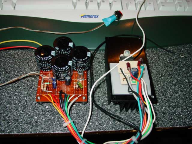

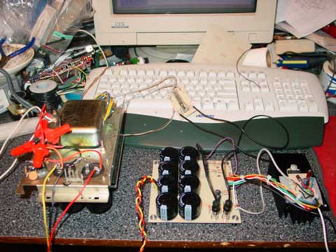

Qs about a two-channel quad paralleled TDA7293 amp...
Next, the testing to ensure nothing lets out any magic smoke when the almost 90 volts of DC gets thrown into the mix.
Nothing smoke-tested itself, amazingly enough. And the sound from the speaker connected to it wasn't bad at all, although I prefer a little more bass boost than my unaltered/not-equalized signal carried. I did notice a little ringing in the upper end of the freq. range, which makes me think I need to throw a Zobel network across the output to squelch any harmonics.
I have 2x 6800uF across the two rails at the transformer side, and the amp filter/support-circuit board has 8x 3300uF caps on it. With it pumping 5 watts RMS into a 4-ohm load, it takes about five seconds to drain the charge. :up:
BTW, yes, my desk is that messy. 😀

Update:
I added a pair of 0.1uF 100VDC mylar caps across the two supply rails (both capped to ground) and the ringing I had heard in my earlier test went away completely. Response was suddenly surprisingly flat as well.

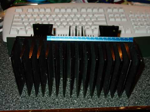

I installed the second TDA7293 and bolted both to the smaller heatsink (pictured above), and ran both into a 4-ohm load. The resulting sound quality was better than I expected for a pair of amp modules, with plenty of oomph available on demand. Thanks to the almost ridiculous amount of capacitance in the supply (20,000uF total per rail) bass response was better than I expected, even with no tone controls whatsoever in-circuit and no tone modifications from the computer that was providing the sinewaves for testing.
Tomorrow I plan to give the rig a harder test by running up the volume to about drive about 70W RMS/channel into the speakers, and see how well it handles the force.
My next trick will be to add two more 7293s in slave mode to parallel the outputs.

heat sink
just for a reference point, Logitech makes a set of speakers called the z-560 that uses 6 of these TDA7293 chips (I know this because I bought one of these items at a swap meet cheap, and I'm searching all over the place for a couple of the chips to repair it). It uses 4 individual chips to power 4 satellite speakers, and it uses two of the chips in a bridge configuration to power the subwoofer. I haven't made any attempt to trace out the exact schematic. But, relevant to this thread, there is an 8 inch by 9 inch finned heatsink on the back. Presumably most of the heat will come from the bridged pair. So, there is a good chance that your heat sink is much smaller than it needs to be unless you choose forced air cooling.

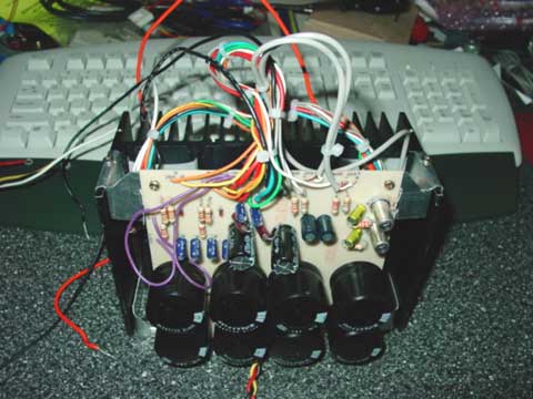

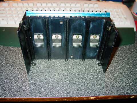

More hot amp-on-heatsink action! 😀
This is what I ended up with after fashioning some mounting tabs from aluminum sheet stock I had lying around from other projects, attaching these to the heatsink, and mounting the amp support board onto them. The entire thing works as a unit - I simply provide power via supply lines and preamp-out signals to the RCA jacks on the board.
It's gapped out from the heatsink to provide the requisite air space for proper cooling, and to prevent any inductive coupling. The fat bundles of wiring emerging from the top are the umbilicals to each 7293 mounted to the heatsink.

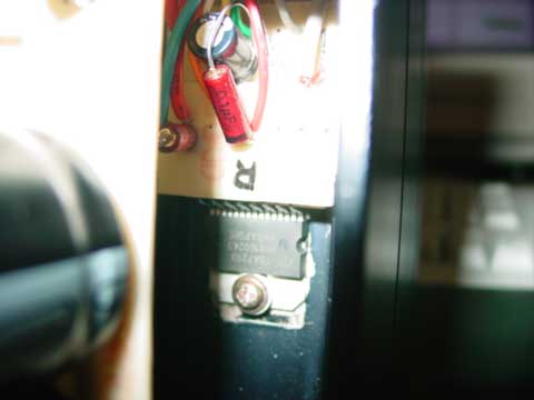

Peek-a-boo...
This pic shows the right-channel (gee, wonder what that 'R' is there for!) 7293 attached to the heatsink. Since it's a p.i.t.a. to design PC boards to accomodate offset-pin IC packages like multiwatt15s, I cooked up two boards for each 7293 - one solders to the odd pins and the other to the even pins, and umbilical cabling connects the whole works to the main supply/support board.
This arrangement lets me put decoupling caps VERY VERY VERY close to the ICs, as is evident by that metal-film 0.1uF cap staring back in the picture. At worst, the decoupling caps are half an inch from the actual IC body.
When I get the sample Kapton MT film from DuPont I'll replace those almost-too-small-to-be-useful mica insulators with cut-to-size ones.

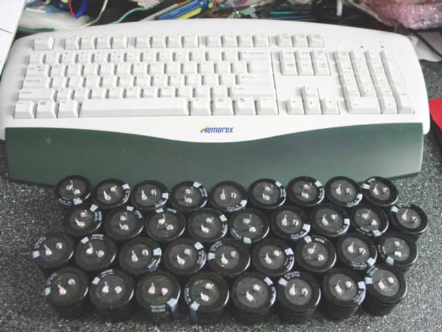

Yippee, my box of capacitors came in...
They're 4,700uF 50VDC high-ripple-current/low-ESR jobs rated for power supply use. Each has a 2.7 AMP ripple current capacity. Just the ticket for putting a lot of capacitance in a smaller area than the massive Sprage/Mallory/etc. cans. (I figure I can cook another 47,000uF per rail with a populated board the size of a sheet of paper and only an inch and a half tall.)
(NOTE: Pic only shows part of the box's worth.)
