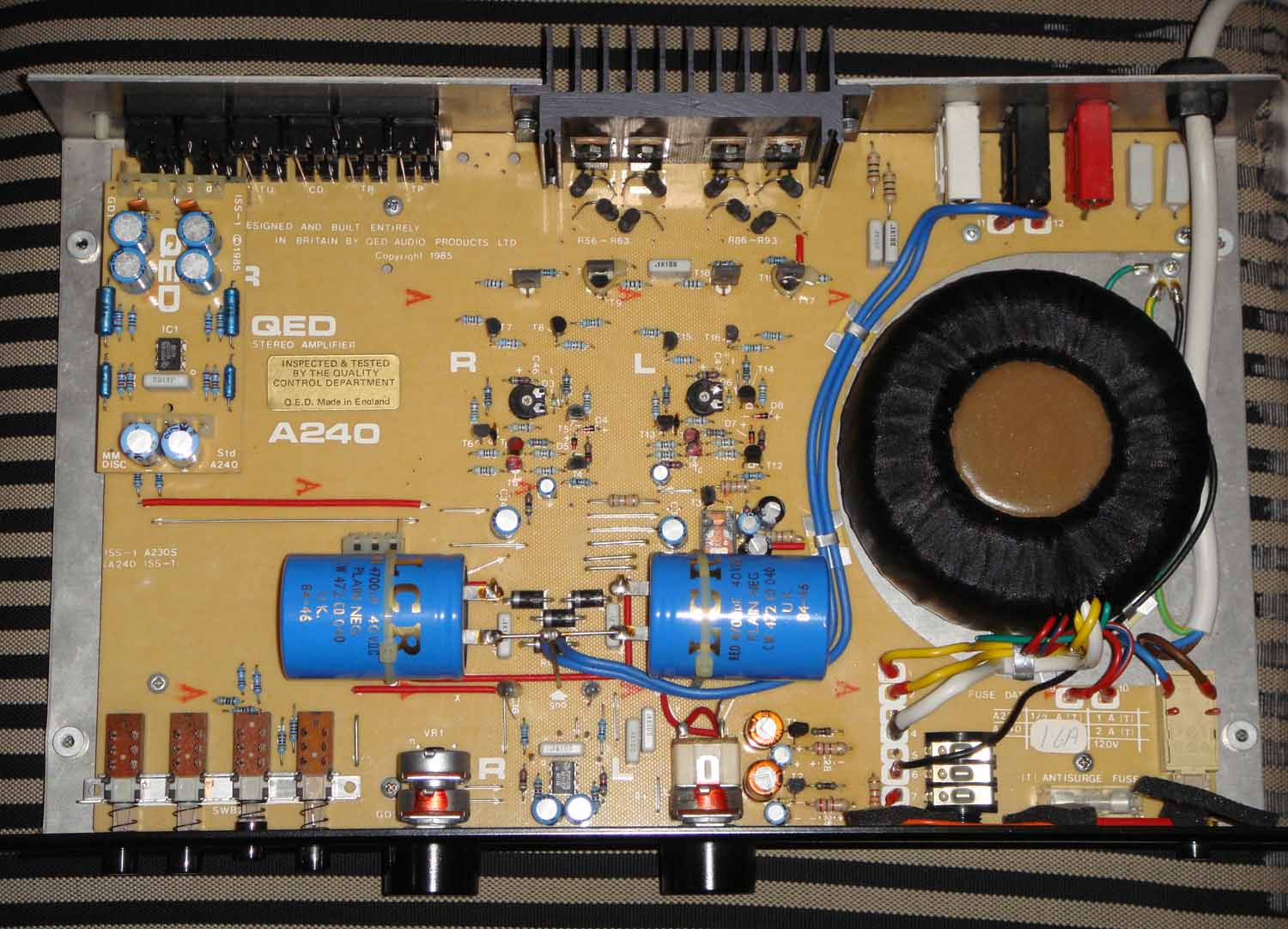

Here's a picture of the version I have, btw:
Thank you Funky.
Lot's of changes between version 1 and version 2 are evident in the layout and features but not in the speaker connections. You'll need to look for narrow profile 4mm banana plugs and just make sure they don't short each other out when plugged it. (Version 1 has output fuses visible in the back-right portion - just below the power cable, while version 2 lacks them).

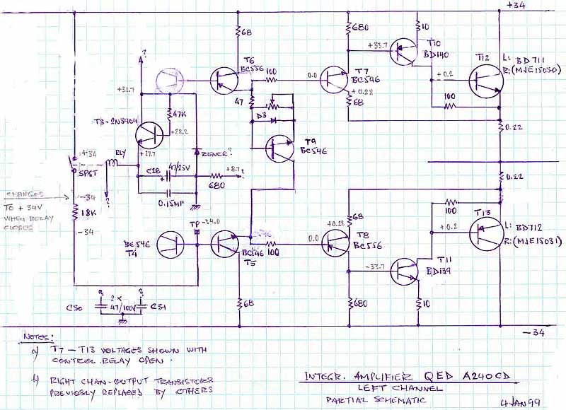

Got this from a gentleman in Canada (Ivan) who's given his permission to share it here. It's a partial schematic of the amplifier he made while repairing them in the past.
Hope it helps!

Me and my friend opened up the amp today and had a look, as suspected the BD911 on the left channel has shorted out. Because they are so cheap and it is a lot of effort to take the board off to take the transistor off we are going to replace all four output transistors. He also ran some multimeter checks on the transformer which came out ok.

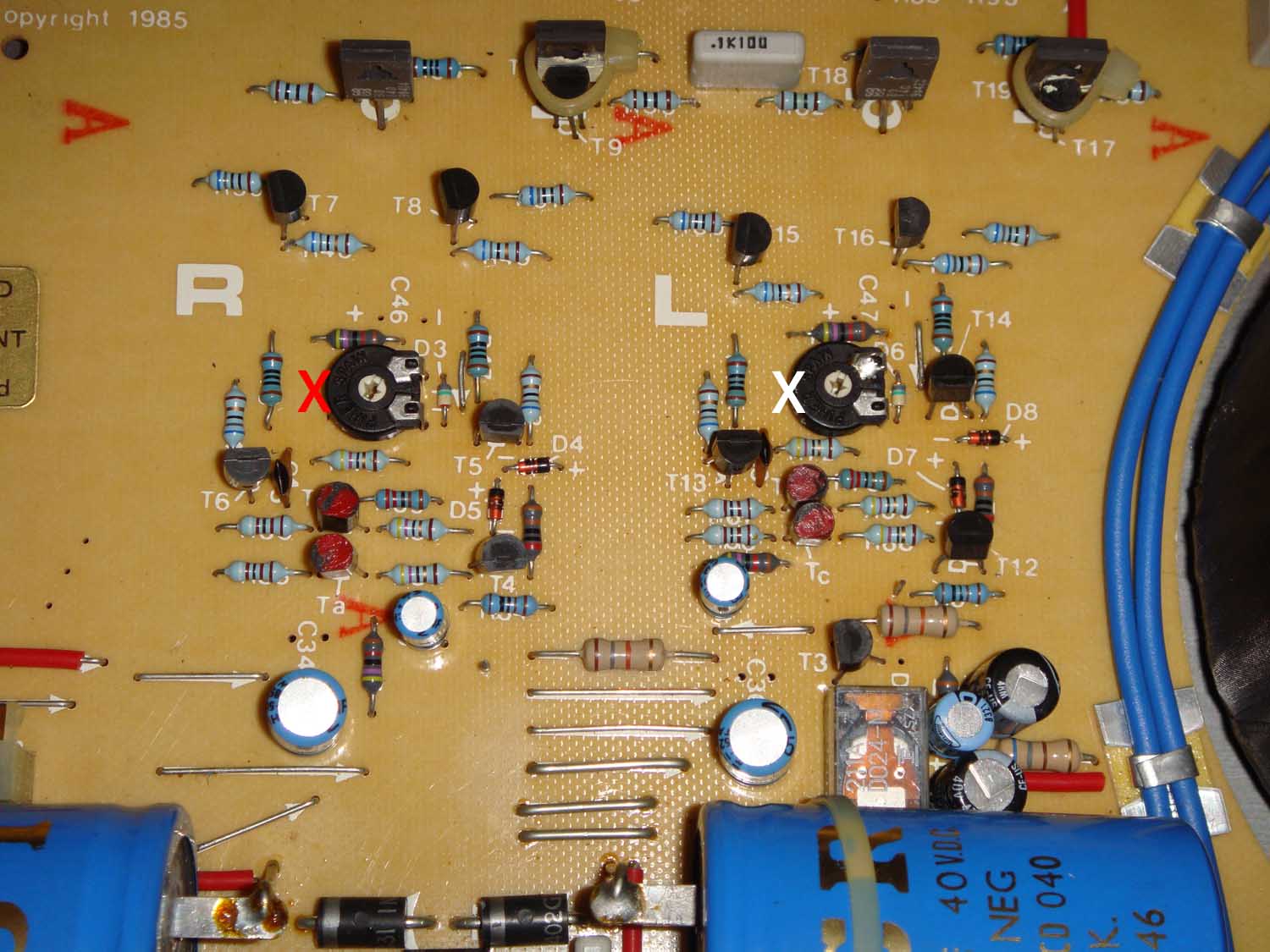

Armed with the schematics for the series 2 version of this amp, I was able to locate the points for measuring the bias voltages on my series 1, and from the service information, I knew that the bias voltage should be approx 15mV - it says 15mV on one page in the service document and 10-20mV on another page.
When I measured my amp - the bias on one channel was at about 30mV, and on the other it was about 50mV. Yikes! No wonder it was getting warm.
With some very careful and gradual adjustments of the bias potentiometers, I was able to get the bias to about 16mV on each channel. Not bad.

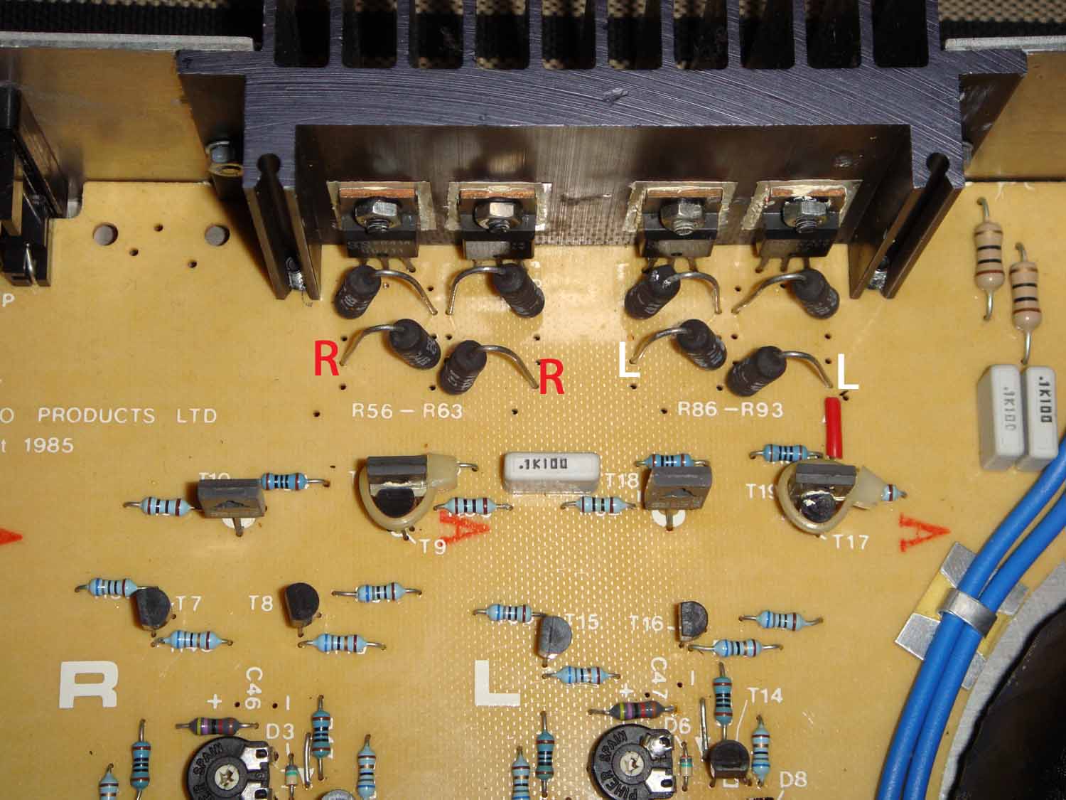

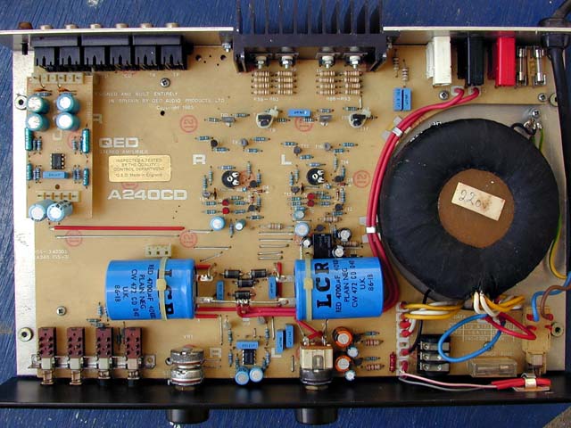

In the spirit of sharing information to help future enquirers, I thought I'd post up images of where the bias voltages should be measured from, and the bias potentiometers to adjust the voltages.
The first photo is just a general shot of the interior of the amp. Note on this one, no output fuses. I love the very simple, logical layout of these amps: very clean - like the sound.
The points to measure the bias voltages from are marked R (right channel) and L (left channel) in the photo below - connect your voltmeter between R and R for the right channel and L and L for the left channel.
The bias potentiometers are marked with red (right) and white (left) X's on the photo below that. On my amp, turning them counterclockwise reduces the bias voltage. Beware - they are VERY sensitive!
After making the adjustments and leaving the amp to settle for a further few minutes and then re-checking the bias voltages (still fine), I closed up the case and put the amp back into my system. It might have been my imagination, but I'll swear it sounded more "relaxed" and less stressed than before. It was definitely running much cooler - after a couple of hours of use, it was much cooler than it would have been after perhaps 5 or 10 minutes of listening prior to making the adjustments.
I know I felt more relaxed and less stressed in the knowledge that my amp was once more operating as it had been designed to.
