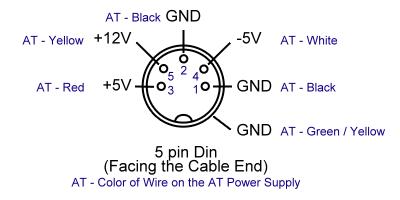

I have read several threads concerning the power cord for the QA-2500. I just picked one of these babys up on ebay for 150 and some change. only thing is it does not have the power cord. after searching google for a replacment I came up null. (with the exception of those few sites that want upward of 250 for a power cord)
Searching here yeilded some intresting topics about changing an existing cord to work with the QA-2500. This would work for me if I had a cord to use. I currently have a apolo vision 32k panel. now the cord for that has 5 pins. but I am not intrested in canabalising it for my 2500.
Where might I be able to find a good replacment cord for this unit. or at least find one that I can modify to work with it?

It looks like old AT keyboard connector.
http://common.ziffdavisinternet.com/encyclopedia_images/DIN.GIF
You might be able to reuse old keyboard connector.
It is probably better not to use keyboard cable.
Power used might be more than it can handle.

AT?
I think the AT size is to large.
I think the mini din might work if I remove one of the pins.

I have done quite a bit of looking recently for options for my powerview 950 which had a very unique connector. I am pretty sure you can pick up your power supply at radioshack if you are in the US. I checked the radioshack(RS) website, but did not see it there. However, I did see something at least very similar here in NC in a RS store.

Wow that site has alot of ac adaptors. very cool thanks
Upon browsing there cataloge I was only able to find one adaptor that may work (same pinout) however its specifiations for voltage is diffrent (+5-12+12)
Now I am a bit confused about that. How can you have -12 volts? is this just a resisted ground? and if so would a resistor inline with this pin give me the -5 that i need?

Got my 2500 in the mail today and the pinout is not like the above in sound_prodigy's post.
My QA-2500 only has 4 pins.
Does anyone know the pinout for this?
{Edit}
Upon inspection of the sticker on the back it states...
USE AC ADAPTOR ADP-2009
(DADP-2009YAZZ) ONLY
now I am sure that this particular adaptor is not essentual but may give some light on the specifations.

Ok I got a power supply modified for the panel. I can now Use it.
Thanks for all of your help.
I used an old cord for an external cd-rom and just tined the wires and put them into the holes as such
facing the panel
1=12v
2=5v
3=ground
4=did not use
1 3
2 4
Thanks again for all of the help
