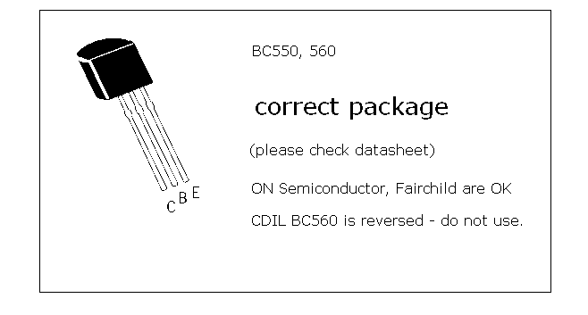

Diying Dispre and just wondering do I go for BC550C/BC560C or to stick to the original schematic BC546/BC547. Will 550 result in any kind on sound quality problem or DC offset.Schematic is this.http://web.telecom.cz/macura/schema.pdf
Thanks PMA once again, but isn’t the schematic the same the one I put a link to, and that you posted? In any case thanks for preamp
Yes, but now you have it completed - with DC servo drawing, BOM and assembly instructions. It may help to those who might be interested in building this preamp.
Sorry for annoying you, but for what is dc servo, I presume potential DC offset. How large is DC offset without DC servo, and for what should I watch on matching. I only see NPN, PNP at input and that is wary difficult to match, almost impossible
