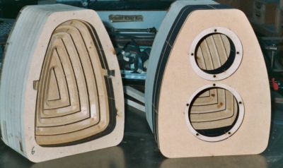

well I'm not going to argue with a man who seems to know what he is doing.
The mids do look very small from your picture of your excellent cabinets.

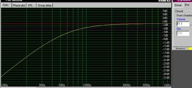

""P.S. 103Db at 80Hz (linear) on a flat baffle = 97dB freefield in my book.
(BSC again !)""
Yes but at 80Hz the speaker will be -6Db to the rest of the output for the LR x/o🙂 (the bass drivers will be doing half the work...)
