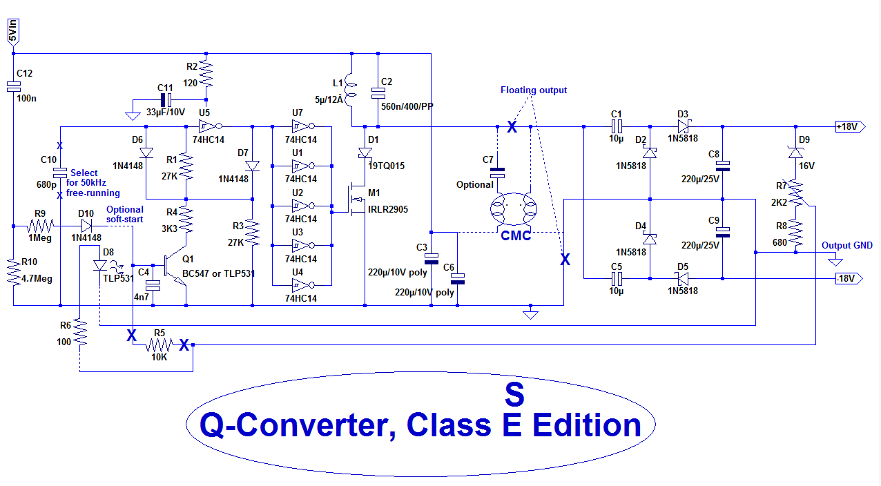

This is the circuit:

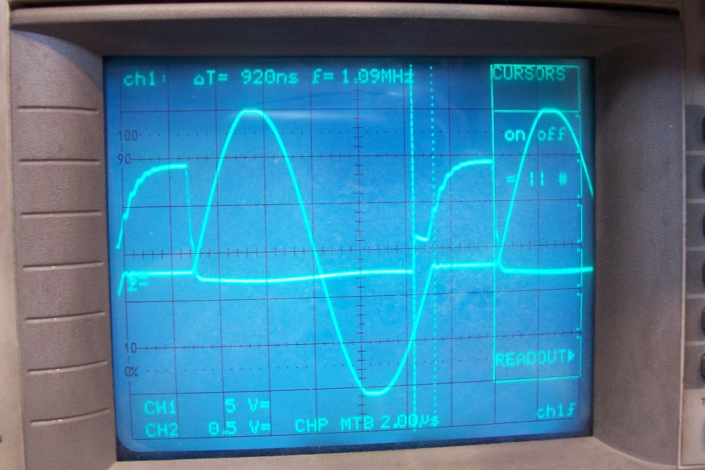

And this is the output waveform (unloaded) on the tank circuit:

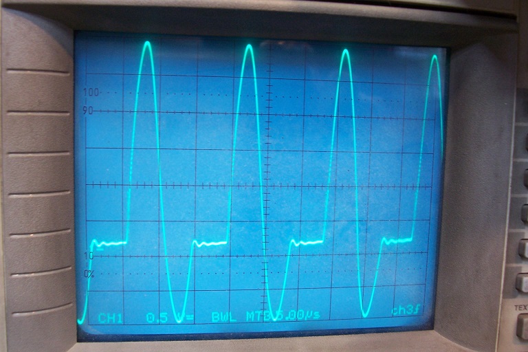

This is the same waveform under full load conditions:
The waveform is essentially a sequence of sinewave cycles, separated by variable-length zero-crossing "pauses".
In addition, when the output is loaded, the rectifying diodes slightly clip the tops, but compared to a conventional, switching converter it remains very benign.
With the values indicated, the operating frequency is comprised between 50 and 80kHz.

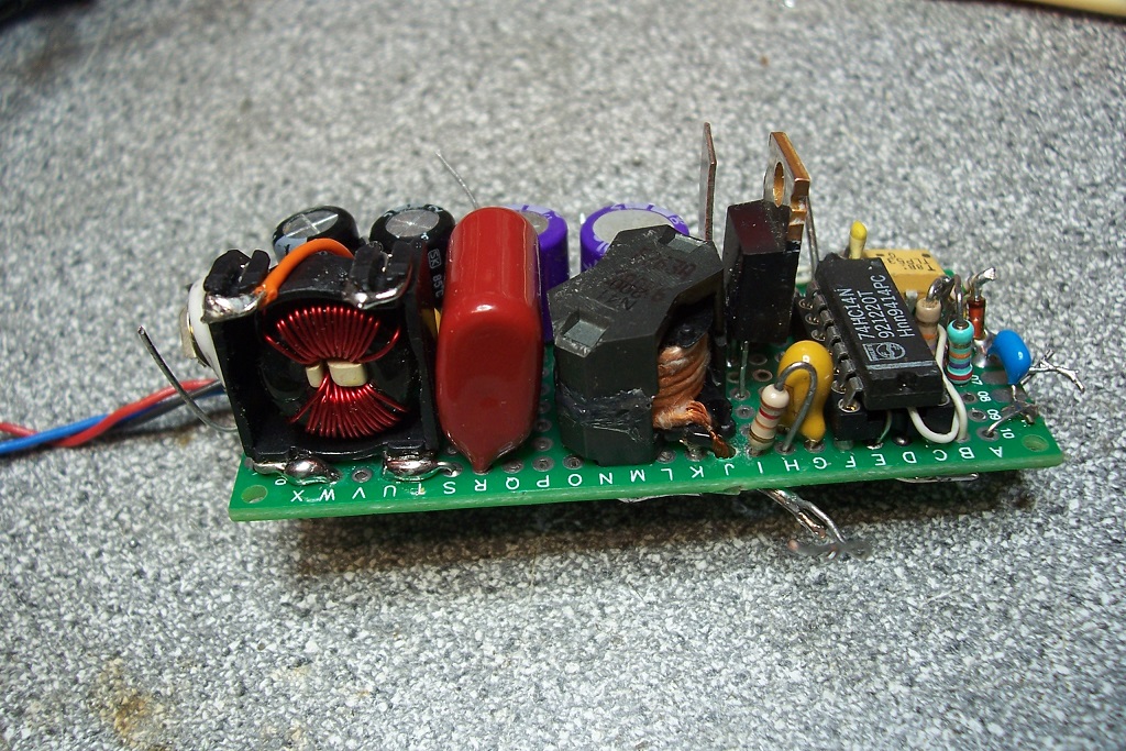

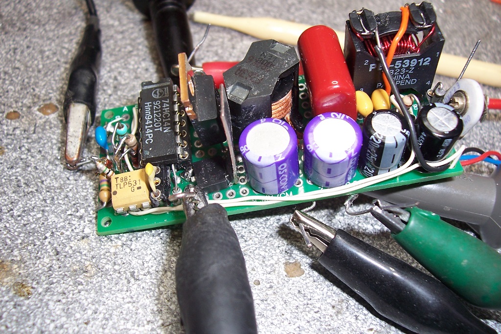

Here is a pic of my prototype:
The inductor is based on an unholy hybrid between a cross-core and an old potcore, because I didn't have a suitable standard inductor available, but basically, any standard 56µH/6A power choke would work (and would have lower losses than this one)

The circuit works by first building-up, then maintaining oscillations in the resonant circuit.
It does so by injecting a small amount of energy after each cycle has ended, exactly at the zero-crossing instant.
If the switching is performed when the voltage across the switching element (the MOSFET) is zero, the switching losses vanish completely: that's the principle of class E operation.
This normally requires a great timing accuracy, to perfectly synchronize the master-oscillator's frequency to the pseudo-period of the passive tank circuit.
Failing to do so would result in huge switching losses, and/or an output voltage out of control, with oscillations building up to destruction, or dying out completely.
Achieving such a result with a crude, PWM'ed CMOS oscillator requires a two-tier strategy:
To avoid a zero-crossing detector circuit, the start of the conduction period is determined by a natural switching element, the free-wheeling diode D1.
The MOS is turned-on well before the zero-crossing, at some point during the negative swing of the cycle:

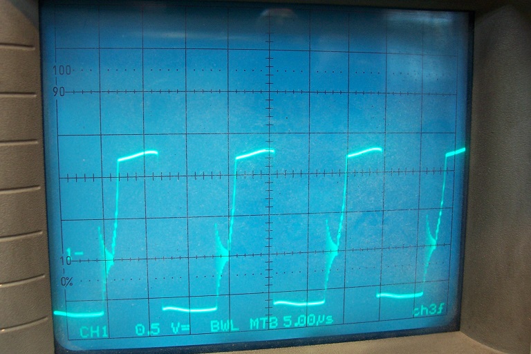

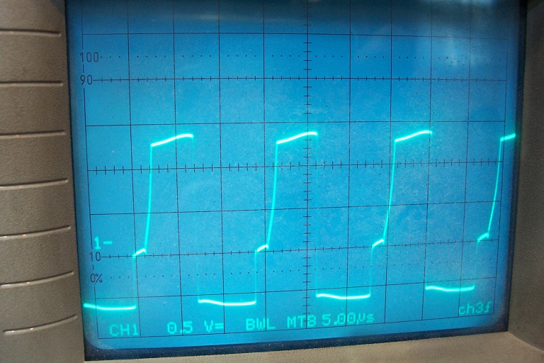

This pic shows the output waveform and the gate-drive signal:
The cursors materialize the advance of the turn-on signal over the actual conduction period, which can only begin when the diode becomes forward-biased.
The timing isn't critical at all: the drive signal can become active at any point during the negative half-cycle without changing the operation of the circuit.
Now that the starting instant of the replenishment period has been accurately determined, the end of the conduction also needs to be defined: that's where the PWM comes into play.
The closed loop control of the active period of the oscillator through the zeners and trimmer ensure an exact balance of the energies injected and extracted from the tank circuit.
The resulting circuit is simple, robust and very accurate, without requiring precision components or precise trimming.
It does have a big drawback though: the freewheeling diode does wonders, but it also consumes a significant amount of power, due to its forward voltage.
All of the supply current has to pass through the diode, meaning a 1V average loss and a non-compressible 8.5% efficiency penalty to begin with (for a 12V supply).
For lower output voltages, a schottky diode would be usable and ~halve the losses, but here the blocking voltage needs to be at least 150V, which excludes "plain-vanilla" schottky diodes stopping at 100V (there are now devices capable of hundreds of volts, but I prefer to keep the circuit low-tech and accessible).
A conventional epitaxial diode like the BYW80 takes the lion's share of the losses.

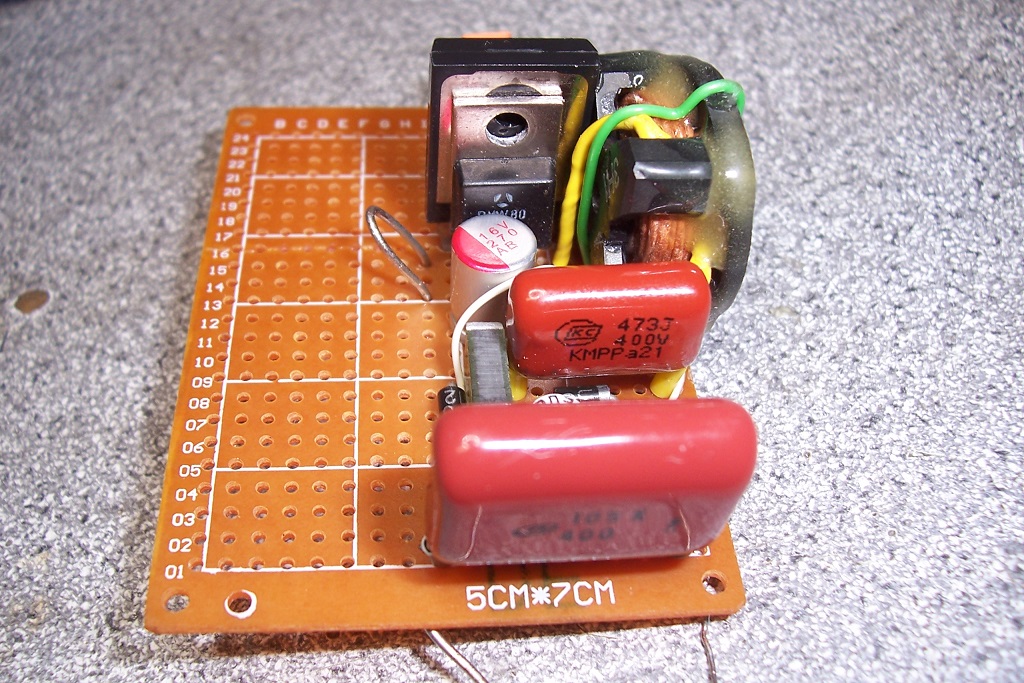

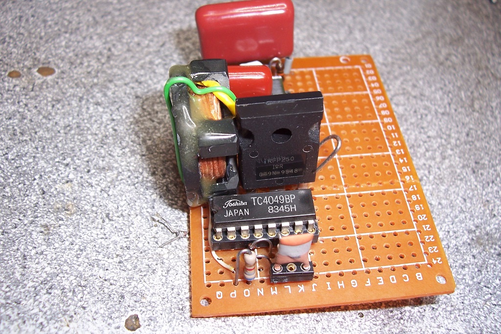

Here are some more pics of the prototype:

Some pics of my prototype:
This oscillogram shows the primary side:
This is the secondary; it should be exactly identical with a perfect transformer, but with the CMC, it is barely recognizable.
This is the same with a 150ohm +3.3nF snubber:

Here is a look at the circuit:
U5 is the master oscillator; R1 determines the OFF time, which should be sligtly smaller than the tank circuit's pseudo-period (~10µs).
The ON time is determined by the current from the feedback transistor, be it alone or part of an optocoupler. Resistors R3 and R4 set limits to that time: it would be unhealthy to allow a zero or infinite ON time.
R3 sets the maximum conduction time (thus the maximum output power). With 27K, this time is the same as the OFF time.
R4 sets the minimum conduction time: it is preferable to have a OFF time slightly smaller than the tank's own period and a finite ON time, to ease the synchronisation between the oscillator and the resonant circuit for light or zero-load conditions, otherwise it could skip a cycle and break into a chaotic mode.
C10 needs to be selected, because the dispersion for the 74HC14 is quite large.
Together, these elements allow a variation of frequency between 50kHz (max load) and 100kHz (no load).
With an optocoupler, the base can be used for a soft-start: the isolated version has a strong surge current at startup, because of the saturation of the CMC and the capacitors to charge.
With the startup, there is no current overshoot at all; it is optional though: if the source can tolerate it, it is not required.
The capacitor C4 is always required, even without additional circuit: phototransistors have a large Miller capacitance, and this interferes with the oscillator
The CMC is connected directly across the main inductor: its inductance is much higher, and does not alter its value.
An optional capacitor is shown: it could be required if the DC resistance of the CMC is similar to that of the inductor, as this would cause a DC current to flow in the CMC.
CMC's have a gapless core, and do not tolerate more than a few tens of mA of DC current.
Here, the resistances ratio is very large, and no capacitor is required.
CMC's aren't ideal as transformers: they generally use a large-µ, dissipative ferrite material causing some additional losses and very sensitive to DC bias.
It doesn't pose a great problem though.
More problematic is the absence of data regarding the transformer operation: you know the inductance, the DC resistance, sometimes the capacitance and maximum voltage but not the V*s product, required to dimension a primary winding (it is determined by the effective core area, the number of turns and the max induction).
With CMC's in the mH/A range though, the product seems to be sufficient to operate in the tens of kHz range without risking saturation.
The rectifiers are always based on doublers: for the non-isolated version this is necessary because single diodes would yield different voltages for the + and - outputs, since the coil is referenced to the +5V.
There is no such problem with the isolated version, but if the DC output currents are unbalanced, it will cause a net magnetization at the secondary, which is not tolerable

The voltage regulation circuit (D9) is rudimentary, but sufficient for the task: it keeps the output voltages within a few hundreds mV of their nominal value, which is OK for the subsequent linear regulator.
If required, the regulation can be made tighter by reducing the resistance level of the adjustment divider (R7, R8).
At some point, the increase in loop gain may cause instabilities, as there is no explicit compensation.
If a really tight and well-compensated regulation is required, the traditional solution of a TL431 as an error amplifier driving the opto should be used, as it allows the loop response to be optimized.
The tracking between the + and - voltages is excellent, even with widely different loads.
The main disadvantage of this scheme is its poor efficiency: around 70% in my example.
The free-wheeling diode and secondary rectifiers impose a 10~15% and 5~7% incompressible penalty from the start, limiting the ultimate efficiency attainable to 80%, even if all the rest is pretty optimal.
My build is 10% lower because of the MOS Rdson, the imperfect (home-made) inductor, the metallized PP cap (a plain foil type would be better), and various other small losses, like the esr of the output caps.
If the circuit is used with a 3.3V supply, the losses caused by the free-wheeling diode will be even higher.
My build is also rather bulky (30x70mm), but this is due to the components, which are 30 years old TH commodities (with the exception of the MOSFet).
With modern SMD components, the size could be more than halved very easily.
With adequate types of CMC's, the circuit can provide many hundreds volt of isolation, making it suitable for use in tube circuits, for elevated heathers, and various floating supplies like bias, or in difficult topologies like circlotron.
Remember that this is functional isolation though, and cannot be used as a safety barrier between mains and user: CMC's are normally not "Y" type components, even if they withstand 250VAC or more between their windings.

The 74HC14 has a supply bypass: R2 C11. In an ideal world, it shouldn't be necessary, but I made the mistake of picking its supply from the positive side of L1/C2, where some perturbations are present.
I should have connected it directly to to C3/C6, but having R2 present has advantages: it allows you to power the oscillator alone, to chose the proper value of C10 without having to worry about misdriving the power section.
Once the capacitor is in place, you can add a second supply on the power side, and increase the voltage progressively, to check if everything works as it should, without risking to fry a component or having to rely on the supply's limitation to mitigate problems.
If the RC cell is not implemented (which could be the case with a sensible layout), it would be a good idea to include a jumper, to separate the power and drive supplies during tests.
The last oscillogram, downstream of the CMC shows a relatively harsh waveform, with a rather violent edge, which is exactly what we want to avoid in a clean supply.
It is possible to soften the edges by connecting a 47 to 100nF across the secondary.
Due to the mode of operation, the impact on the losses is negligible: in fact, for up to 70nF, the losses decrease (very) slightly for unclear reasons.
The straight capacitor connection causes a bit of LF ringing on the flat, mid-part of the waveform, but the amplitude and frequency are benign and no cause to worry.
It would be possible to damp them completely with an appropriate snubber, but it doesn't seem necessary.
