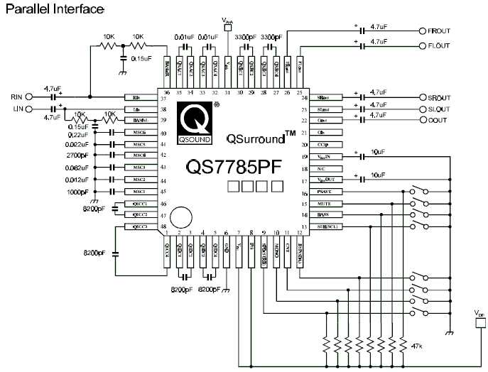

hello everyone,I have got some samples of Qsound from a friend.the chip is QS7785.I want to make a 5ch multi amp for my AV.I wonder if anyone have test it and get a good result?

here is a connections of QS7785.I print screen from 7785's datasheet.
if it is in parallel interface,the mcu is unwanted.very simple.I want to do a p2p building.

Hi Digi01
Looks like a good project for any one and quiet simple aswell.
On the picture that u have posted i can not see where u get a center input from . Because there is only a rigth & left input ?
Or u going to join the L & R input together with some resistors and what ohm`s or kohm`s ? or u going to use for the center input .

Qsound chips can deliver a 5 speaker out from a mono or stereo sound source there r two of them one is 7785 from a mono or stereo sound source it can deliver 5 speaker out 2 front, two rear and one center and this chips could be used independent of a MCU.
Other one is called QS5.1 this microchip could deliver a true 5.1 out from a mono/stereo source but a mcu is must to drive this microchip.

QS7785 is a mono/stereo input to 5 channel out 2 front, 2 rear and 1 center and can be made without a MCU, however theres a better one called QS5.1, as the name suggests from a mono/stereo input source it produces 5.1 out 2 front, 2 rear, 1 center and 1 sub, but in this case a MCU is a must/

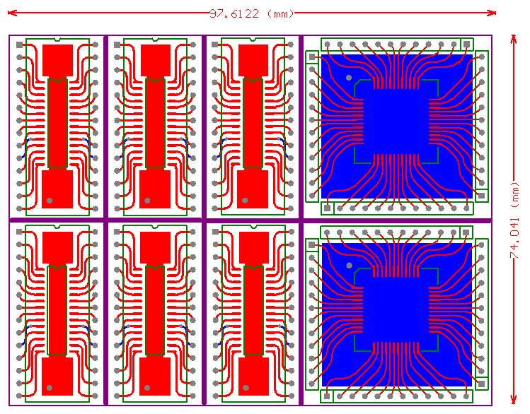

The only problem is how to mount the IC to a pcb . My soldering skills are very good but the legs on this chip or only 0.17 . Even for me this will be a very had job to do .
Is their any kind of pcb with a scoket on it that will fit this chip by bending the legs over on the chip. so it looks like the old Intel 286 or 386 processer chip.:cannotbe:

SOmeone posted how a link to how to solder surface mount parts some time in the week....
Looked pretty easy, first put a tiny bit of solder on the PCB on the solder places, staick your ic on with your finger, then drop a large drop of solder over all the pins on one side, (so all the pins short).
heat the solder, and suck it out with a solder pump, the sucktion will remove all the solder, except for the bits being held by capilary action between the pins and the PCB, leaving one side soldered on.... repeat on other side/s...
