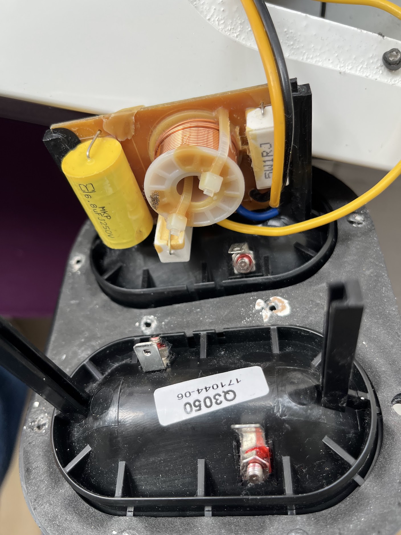

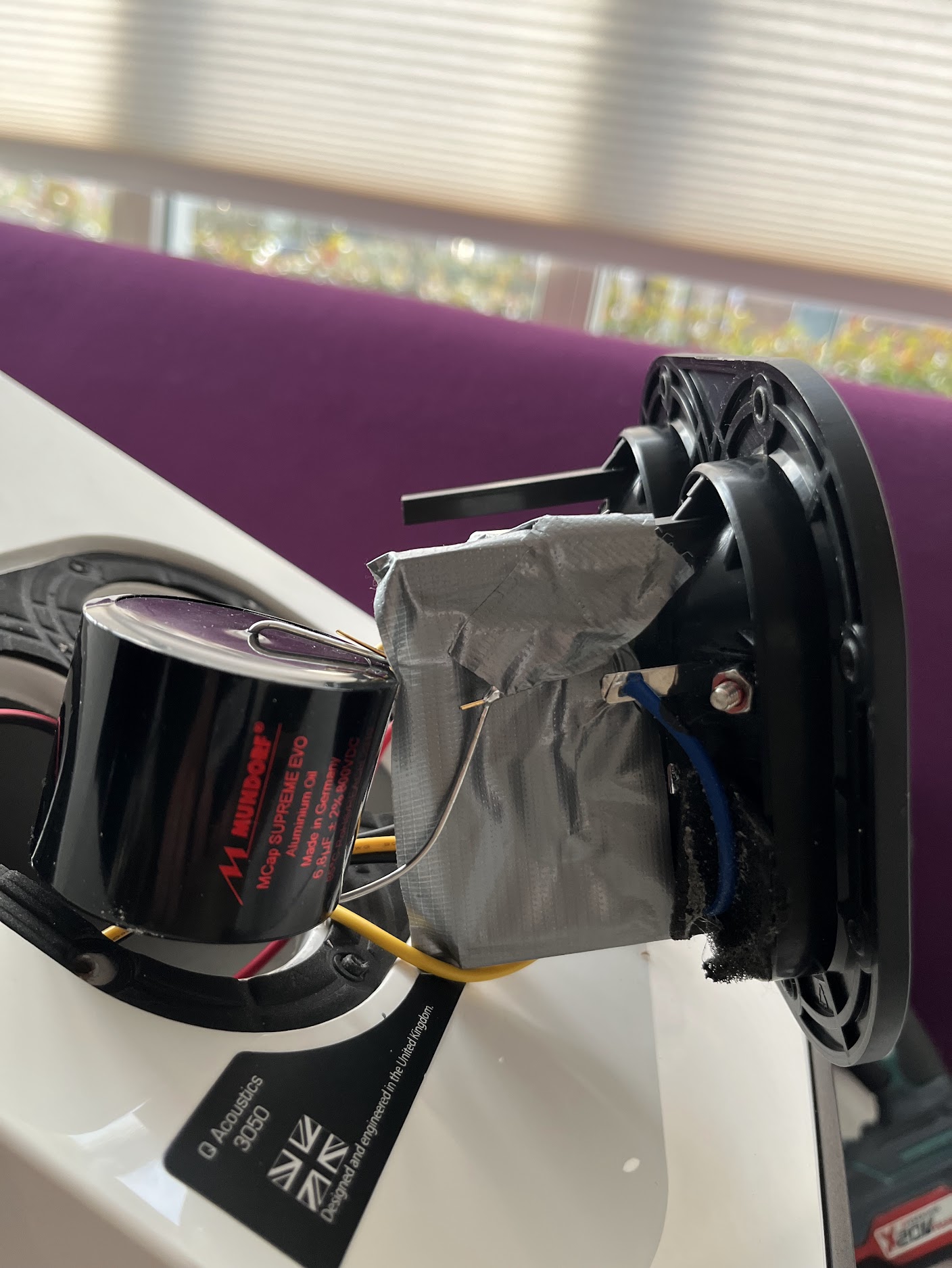

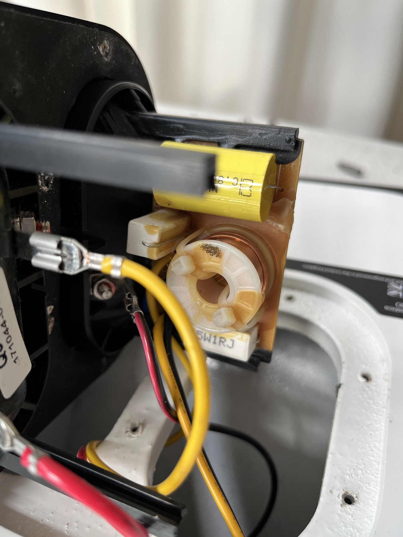

For those interested: I just replaced most components for improved quality parts for my Q acoustics 3050 (not the i version). Sounds much better now IMO. The large mundorf caps were a bit difficult to place, so had to append them to the pcb somehow. It is a very simple crossover design, the 3050i is more complex. Anyway, replaced the resistors and cap, and also added a bypass cap. Parts used:
Original crossover
Cheesy crossover as Danny would say.
Components removed, a lot of glue....
Mundorf FTW, testing can start!
The Supreme Evo is a bit big 🙂However, it fits 👍
Maybe a bit overkill, but it does sound a lot better!
- Mundorf Mcap Supreme EVO Oil 6,8 uF / 800V
- Mundorf MResist classic, 10 Watt 1 Ohm
- Mundorf Silver Gold Oil 0,68 uF / 450V

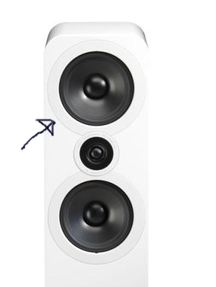

BTW, does anyone know how to remove the styling rings on the front so I can remove the speakers? They did not want to come out easily, I did not want to break or scratch them them (see picture below).
This is the advice from Q Acoustics Support.
"In order to remove the trim you need to use a pallet knife and cloth to protect the cabinet. Slide the blade of the pallet knife between the cabinet and trim, now place the cloth on the cabinet, and then gently lever the pallet knife against the cabinet and the trim should begin to lift, do not try and completely remove at one point, perform in small amounts at different points around the trim until entirely lifted. You should now have access to the four screws that hold the driver in position."
Note that I haven't tried it myself!
Thanks for the help 👍 I also want to add some more damping material in the enclosure. I will gently try this approach, already tried something similar, but it did not move.

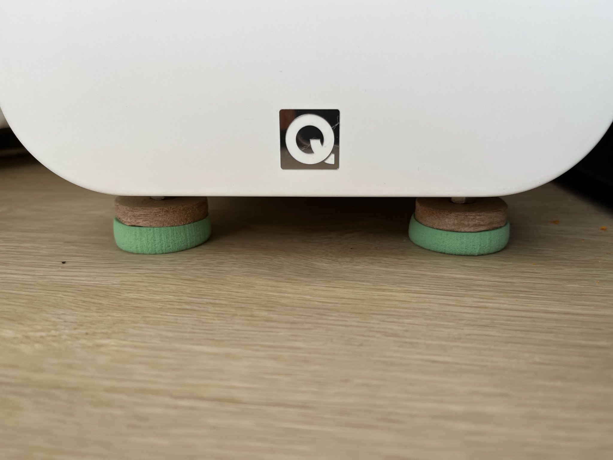

No major updates yet, will try to do the lifting of the rings some day. I did replace/enhance the feet with the poor man's version of isoacoustics, see this picture:
I used a piece of wood cut in a round, and then attaching it to the spikes and glue the sound absorber to it. I just placed these, still evaluating but I do think I hear some improvements. I used the PolySound Sylo vibration dampers for this.
