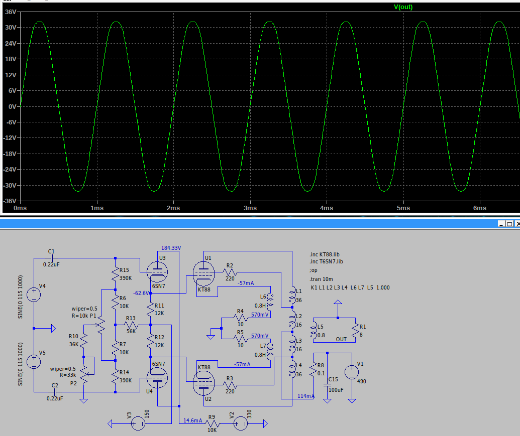

Q: 6SN7 Cathode Follower Driver Idea for PP KT88/60W
Hi, folks,
I have a direct-coupled 6SN7 cathode follower driver idea for push-pull KT88 / 60W output. Not made any THD simulation, just basic schematic/simulation in LTSpice with voltage/current/bias numbers. This unit requires (-150V) supply apart from HV B+/6.3V. Cathode follower solves one of the fundamental problems of fixed bias push-pull stages with RC coupling.
P2 33K trim potentiometer is for controlling bias voltage, P1 10k - balance.
Any ideas or suggestions are very welcome. LTSpice files attached as zip archive.
Thanks in advance.

Since the 15k resistor is a bit heavy load a ccs migth be a good idea but i would NOT recommend to stabilize the -150V UNLESS all other voltages are stabilized also.
If, for some (to me, unreasonable) reason something beefier than the 6sn7 is required the 6bl should be plenty, no need to toast the easy to drive KT88 grid with a 6bx7
Direct coupled cathode followers can work well for driving output tubes, I have at least four different amps that uses this concept. I'd look for something with more gm for the followers though, as common wisdom has it that high gm is an important factor in cathode followers.
6N6P could also be considered, pretty much the same thing as far as I know.
My effort on this was published in AudioXpress Magazine May 2002.
PP 6J5s as CFs driving the grids of PP KT88s or PP 6550s.
Twin Power Tubes form a bridge with twin HV PSs arranged so that the output is at ground (common).
As far as the signal is concerned the output tubes are in parallel, not in series as in a common PP circuit.
The resulting output impedance is one quarter of the regular circuit.
Three OPT setups are discussed. The front end is a common DIFF Amp, 6SL7/6SN7.
All here in this pdf.

Maybe this can help , and check for many McIntosh tube amps schematics , they use bootstrap capacitors to raise the output swing of their DC coupled CF triode drivers.

My primary thoughts also, but according to the induction values given in the LTSpice schematics, it isn't a Unity Coupled design. Hence, drive signal requirements are increased, but not in the same way as in McIntosh's amplifiers.
Correct, its not unity-coupled, its 3.9K output transformer with 12% CFB and 33 %UL.
The heater-cathode voltage rating can ideed become a very real problem when there are large voltage swings involved.
6SN7 heater should be probably biased at -100V. I have separate 6.3V output on power trafo to make separate supply for this CF 6SN7.

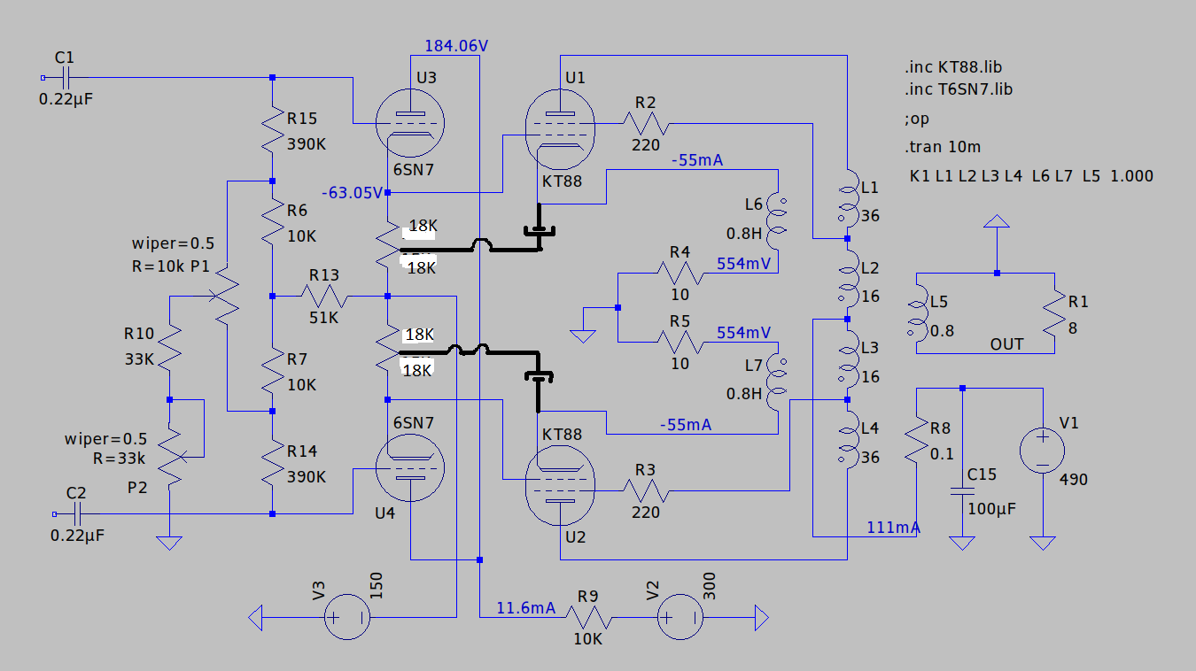

Edit, there is a beefier pin compatible tube that would make a better cathode follower than 6sn7, the 6BX7
I have a box with 6N8S (=6SN7) already ;-) BTW, why you would consider beefier tube? Grid current of the KT88 is very low.
I have slightly changed resistor values, new schematic attached and looks like with ~115V RMS input it can deliver ~60W into 8 Ohm.
Each plate of the 6SN7 dual triode will dissipate roughly 1.9W, I think it should not be a problem.
Please correct if I'm something missing here. Thanks.
