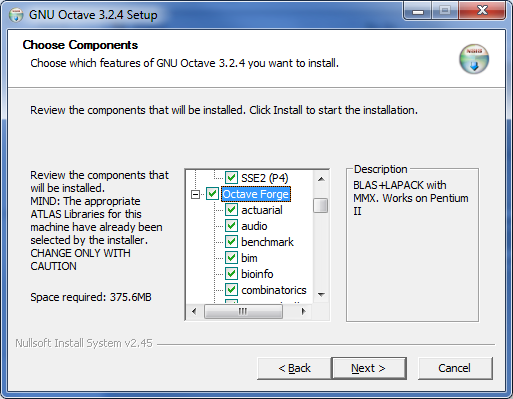

Octave install for Align2, loading all the required packages
After using my cellphone video to capture the Align2 error message, I realized I had not installed the required Octave packages. I read the help.txt file where it states "install all options" for Octave. I wanted to, but just didn't know how to do it. Installing again slowly, I noticed there is a dialog box, "Choose Components" that I clicked through too fast when installing Octave the first time (use the download link in the Setup Tab). Scrolling down and checking the box for "Octave Forge" brings in all the packages at once. Now all the plots work. Next I will have to see if I can get all the python elements installed to get PORC working as well.
