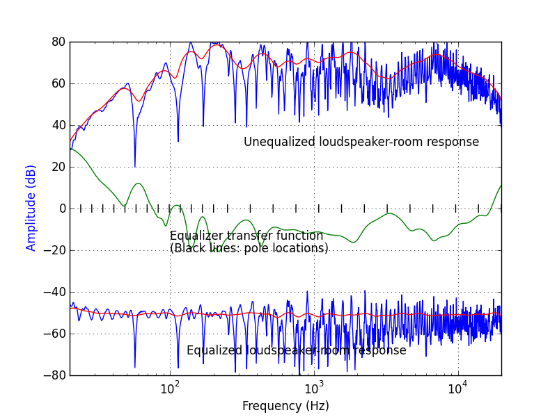

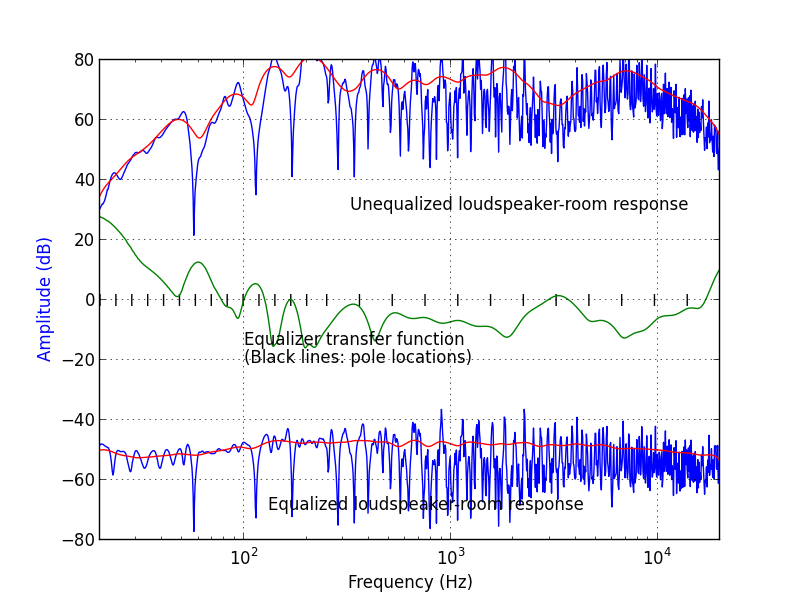

Ok, I decided to do it the smart way via. windowing rather than interpolation. This is DSP at it's best:
Arbitrary Frequency Response
I also automated the pole calculation based on Dr. Bank's freqpoles algo. This method calculates the poles of the parallel filter based on a predetermined pole frequency set.
Here's a screen shot targeting the tact30f curve (red)

I tried the latest version and now the new method works very well. The only small drawback is that if you want a very precise frequency response, you need to add enough values in the target curve.

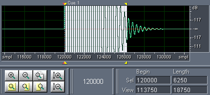

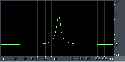

Food for filter thought.
If response contains a moderately high Q peak at low frequency, the time domain may go on for thousands of samples before dieing to below dynamic range of CD. A true correction filter will be the same length.
Example:
120Hz peak of 6dB with Q=5, with sampling rate be 48kHz looks like:
With time domain that runs on for more than 6k samples at 16bits and beyond 10k samples to get into noise floor of 24bit samples:
Getting great control down to 20Hz I find 32k-65k taps fills the bill, and for >60Hz 8k-16k taps.

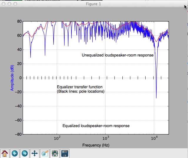

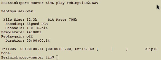

I have installed (I think) all the components of PORC, and it now runs, but I'm not seeing the results I expect.
Firstly, the graph that pops up only shows the uncorrected graph. Secondly, the .wav file that is created is not loadable by REW or the convolver in JRiver Media Center (I'm running the rather new Mac version).
Here's a snapshot of the graph produced, along with the results of running "play" on the file created.
JRiver shows a file status of "Not valid" when I load the output file. I've tried it in mono and in stereo (using sox to merge two copies of the original file to stereo).
Neither works.
Any suggestions?

Thanks - I just sent a link to the file via PM.

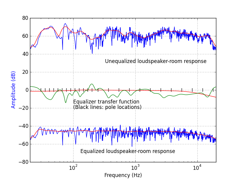

Works on my end. I sent you a link to the filters in a PM. See below attached screen shot. I assume the stereo file you sent me was left/right channels (which I labeled the filenames), although they both look exactly the same to me.
Thanks - it was originally a mono recording. I think I have it working too - there must have been something wrong with my installation. I went crazy with macports trying to reinstall lots of the packages, and now I'm seeing results.
