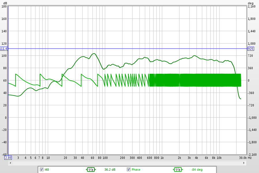

Yes, that's clear from the links. It's worth looking at phase as well as magnitude, though getting good phase data is harder.The filter is minimum-phase, if that's what you're referring to.
Phase
I plugged the impulse responses into Room EQ Wizard, and the output is 180 phase shifted from the input. This is typical behavior of an all pass filter.
RED = Convolution Output
GREEN = Input
GREEN = Input

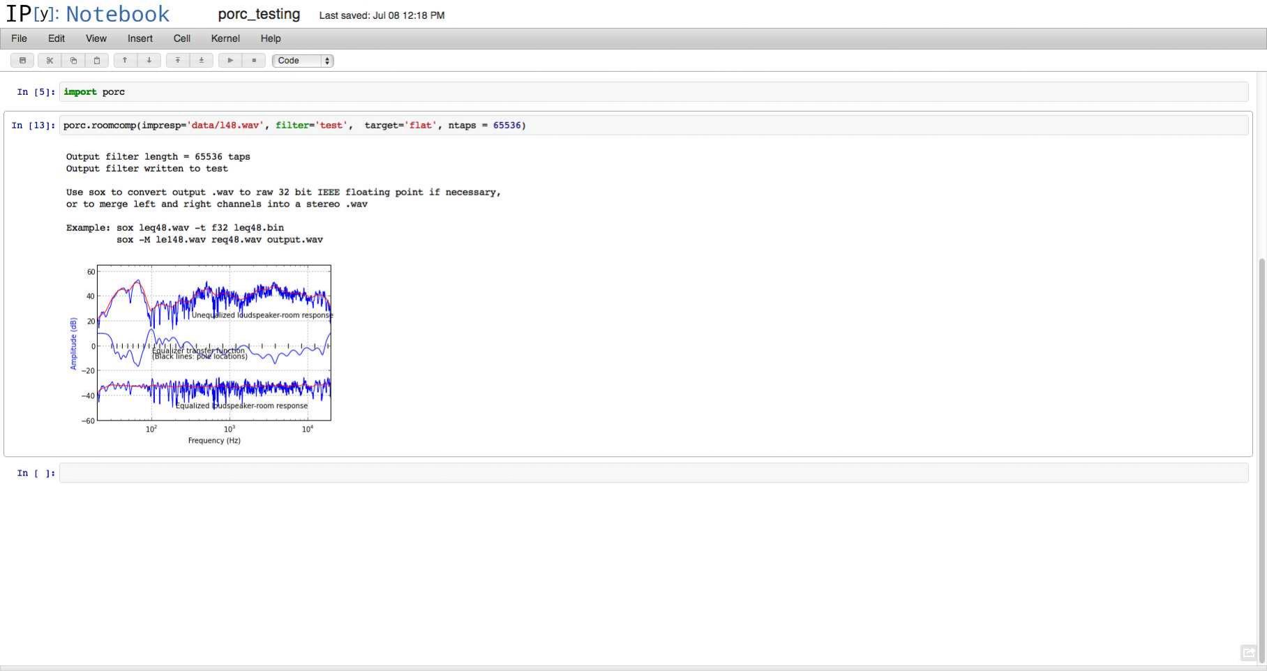

For anyone wondering, I've tested in OSX and appears to work.
System:
-OSX 10.7.4
-Python 2.7.3 (installed via homebrew because the Python packaged with OSX is never up to date and needs sudo to install any python libraries and I don't agree with that on principle)
-Latest version of all dependencies from pip.
I've tested inside an iPython 'notebook' because that's my preferred way to work with python code and I can get matplotlib graphs output to the same window. I'd expect it to all work as intended from the command line.
System:
-OSX 10.7.4
