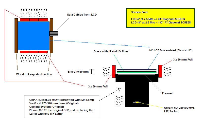

Hi, I will be using and OHP with an LCD monitor. Do the Thermashield solve any heating issues ? Look at my trade if you can, Im planning on using this between the fressnell and LCD, wich are separated 30 mm... so, is FRESNEL 10 mm Thermashield 10 mm and LCD.
Is that enough ?
Im using an 250w MH with UV filter from Osram... should I add more UV Filtering or Rosco Thermashield will also block it ?
And the more important thing... WHERE to BUT Rosco Thermashield in ARGENTINA !!!!?!?!?!!! Is there any other product findable in strange places like my home country ? jejeje THANKS TO ALL.

If your OHP has plastic fresnels, then maybe you should put the Thermashield 10 cm below the fresnels. That way it could project the fresnels too. If your OHP has glass fresnels, then "fresnels 10 mm Thermashield 10 mm LCD" should be fine. Use a computer fan to blow air through all of the spaces.
Rosco sells a lot of color filters for theatre lighting. Maybe you can find a company that sells their products in Argentina to theatres and concert halls. Even if they don't have Thermashield, acompany that sells other Rosco products could order it for you.

The thermashield is not very CHEAP, but if it's for security.. it's welcome. I'll try with the brazilian site, I already contacted them, but sending it here is a problem.... I'll find over here.
By the way, is this configuration safe ? Picture attached
And, do Powerstrip solve the problem with the corners ?
