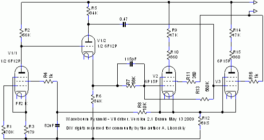

For the sake of discussion, I report here some schematics that can be still found online and that can be handy to restart the discussion.

This is probably an Edcor adaptation of Anatoliy's design, because I clearly remember he said many times that he doesn't like UL designs.
Most probably the original design was without UL taps, then Edcor added them to make it more adaptable to most common designs.
I agree that in most cases UL alone is not enough and gives a clear sense of compression to the sound due to its own curves.
Certain tubes, like EL84, can benefit of small amounts of UL (that simplifies the supply of the screens) together with other kinds of local feedback, giving the possibility to have simple two stages amps with triode curves on both stages and almost pentode-like efficiency on the output section.

and what is the third scheme?
The third scheme was just a part with output Gu-50 tubes.
Bias adjustment pots, resistors from anodes going to anodes of a pentode LTP driver, VACTROL LEDs in screen grids to sens approach to clipping.
