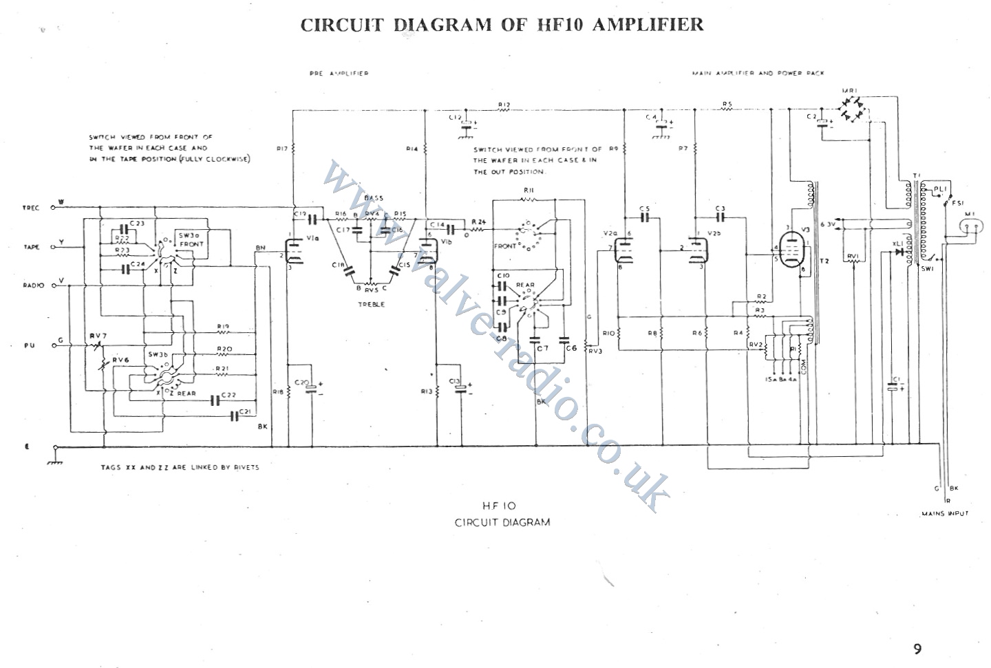

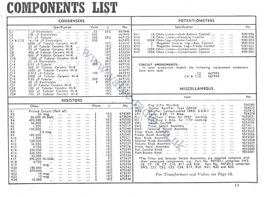

Attached is the schematic & component list, the damping adjustment control is RV2 by the output transformer. There's a question here somewhere, I'm just not sure what exactly I'm trying to ask, I guess understanding what goes on with adjusting that control would be a start, but it seems it would affect feedback of the output stage? 🙂

Pye Mozart HF10 does not apply an orthodox damping factor adjustment.
In that only the amount of GNFB is adjusted whereas the true damping factor adjustment keep the GNFB about constant
and varies between voltage negative feedback and current negative feedback.
An example of this is Heathkit W6M. There is a twin potentiometer for the adjustment,
10 ohms for the current nfb and 300 ohms for voltage nfb.

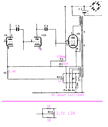

...adjusting the control with the amp turned on makes the speakers scream scratchy sounds at what seems full output of the amp
....There's a question here somewhere, ... what goes on with adjusting that control.... 🙂
Yes, FULL output. V2a's cathode current runs through the pot. When the wiper loses contact, V2a goes "off", its plate voltage jumps a hundred Volts. V2b and the final multiply that by ~~500, or to their limits (FULL power).
That knob is there to play with. If "upright" were optimum for ALL situations, they could have stuck two fixed resistors in there; but they let you play with this aspect of the amplifier's performance. (A cynic would say that each knob added justifies a higher showroom price, especially if its function is mysterious.)
First: a 1K Linear is an inexpensive part. Replace it.
Second: running cathode current through a wiper is bad form (and bad for your ears). Without a total re-design (which I suspect won't find a perfect answer; those guys were not dumb), _I_ would consider the plan in the bottom of my attachment. A higher-value pot with fixed resistor shunts. The impedances are not quite the same, but it's basically Adjust To Taste, so there is not an exact value to hit. And there will be much less BLATTT when wiper loses contact. (And a new pot/wiper may be OK for another 50 years.)
You can also try to clean a pot. Sometimes it helps.
The drawing is a little tangled. I believe speaker current returns in R1 which is a sub-ohm resistor. So we have voltage-sense NFB through R3 R10 (very ordinary), *and* current-sense NFB from R1 into the other end of R10. With extreme connections we can make output impedance low or high. I think this plan gives a more limited range.
Do we want "Infinite Damping"? Well, no, and we can't get it. We can aim for high damping. The benefits of going over DF of 10 or 40 are dubious. And OTOH some older speakers assumed DF like 3 (no-NFB triode) or 5-10 (light NFB), and will give a different bass alignment for other damping. Also variations around every speaker impedance bend.
Also there is "ideal" or "designed" damping in an ideal room, and the bumps/lumps/dips we get in real rooms. You can sometimes "mis-tune" one to suit the "flaws" in the other.
A small trick: the far end of the secondary is not common or damp-tap but drives the cathode of V2b. Some kind of feedback; neg or pos I'm not sure, willing to trust that Pye had a reason.
The function of the 22Meg is obscure. It feeds B+ "DC" into the NFB network. I can only guess this is a buzz cancellation trick. The null will drift as C2 value changes with age or replacement. "22Meg" is suspiciously convenient (22Meg was the highest value in common resistors). It may be a clever 10-cent improvement. Since the original price is now forgotten, and the amp lives on, in a future repair I would consider upgrading the DC to a C-R-C or C-L-C filter so it didn't need this hack.
