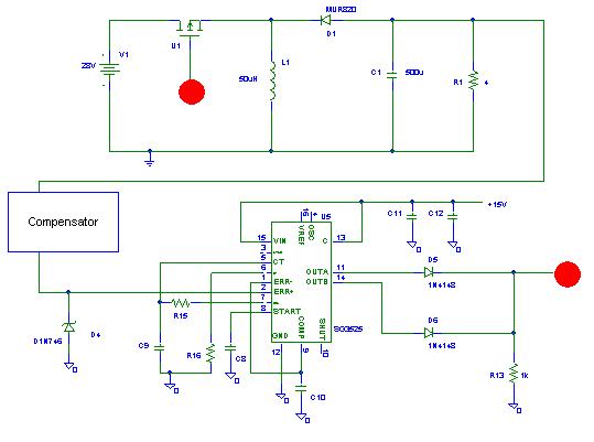

I try to build a converter, but I am not sure how the connection is made from the output of PWM to mosfet. Would it require an isolator ? Can someone show me in diagram ?
The mosfet I used should be p-channel. And I need some suggestions on what mosfet I need, is RFP30P06 ok ? The incoming supply is 28V with switching frequency 100kHz.
The diagram is as below, any problem with that ?
I am new to this design and here too. Hopefully I am posting in the right place. Appreciate and expecting any suggestions. Thanks.

Have a look at an IR2121 or an IR2125. Not sure which one but they are similar.
Seeing your converter will have a negative output voltage, will the error amplifier input on the controller chip work ok with this?

Yup, by first inverting it with another error amplifier (inverting amplifier -- positive input to ground)Circlotron said:Seeing your converter will have a negative output voltage, will the error amplifier input on the controller chip work ok with this?

Your schematic shows 2 grounds, ya? So either a toroid transformer or opto isolator are required. Usually the feedback reference is isolated too.

Somewhat confusing circuit.
If u are looking for a step down conv,,,Try a single chip solution like MAX 724.

Or SG3524 (both o/p added for max duty cycle.and IR2110 or any high side driver.

Your circuit looks ok to me. look up an 4n36 here:

Even the outputs can be connected directly to MOSFEt w/o isolator,if u r using SG3524 or TL494.Since the IC output transistors collectors and emitters are easily accessible,can be configured freely...

Yup, 1 power ground and 1 signal ground. But .. why using isolator 😕 Both the grounds will be connected at a single point after all.

Yup, I think I need a high side driver 😀
Really !!!?!! Can you show me ?

sivan_and said:Even the outputs can be connected directly to MOSFEt w/o isolator,if u r using SG3524 or TL494.Since the IC output transistors collectors and emitters are easily accessible,can be configured freely...

Still not figure out the application for it yet, +/- 12V should be useful. Just try to build some converter myself. 😀 😀 And to gain some experiences with it.
Input voltage is +25V .. might need zener diode or diode here.
Output voltage is -12V (require soft start ?). +12V is ok too.
Resistive load 15ohm. So, load current = 0.8A.
Mosfet p-channel IRF9540 ?
