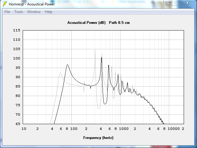

Here is one of two tunable PVC TLs. I found some zebrawood veneer leftover from my Carrera build and wrapped the pipe. Doesn't look so much like plumbing now. So far the potential names are:
1. Tin Man
2. Ricola Horn
3. Plumber's Crack

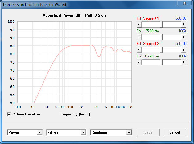

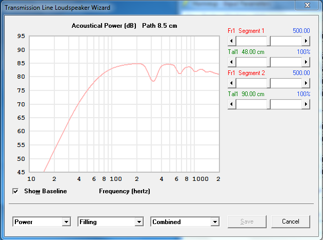

I could tune the length above the driver with a telescoping tube. Make sense?
No, ideally the driver offset is a fixed percentage of total length, normally at 1/3, which equates to 0.349 rather than 0.333 due to the vent's impact on the pipe's 1/4 WL pipe action, so ideally need to have adjustable top and bottom segments plus for max adjustability need one for the vent location [usually at 0.848 - bottom of pipe] and the vent length.
