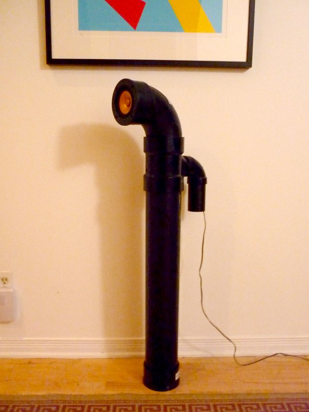

I built two enclosures with black ABS pipes and fittings for the Alpair 7. ABS seems stronger and cheaper than PVC. Since these are my first diy speakers, I can't tell if the result is perfect, but I must admit that I'm very pleased. The sound is a bit aggressive in the mid range, but I guess I'm not used to full-range speakers. I plan to use DRC to equalize them, but I'm not in a rush. They're not finished; maybe I'll use passive filtering instead.

I first wanted to build a Pensil, but your design for the Alpair 7 was not ready, then I was intrigued by the "triffid", a bass reflex enclosure:
http://www.diyaudio.com/forums/full...-chr-70-application-thread-9.html#post1802936
Rabbitz helped me a lot, his advice were priceless. My "triffidus" design is a bit different than the original "triffid", and as you can see it's not finished.
There's still no wooden base, and no binding posts (the cable goes out through the port)...

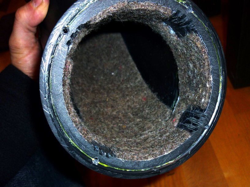

Only the top fittings are glued together; when the pipes are inserted into the fittings, it seems solid enough. They're easy to insert and remove after heating the fittings with a small paint stripper. Maybe I'll glue everything when I'm satisfied.
The second picture shows how the Alpair is attached to the ABS fitting. The diameter was almost perfect but I had to use a small file to cut little grooves. The screw holes are right between the fitting and the glued ring, and it's very solid. The whole interior is lined with 3/8" industrial felt (but only 1/4" around the basket).

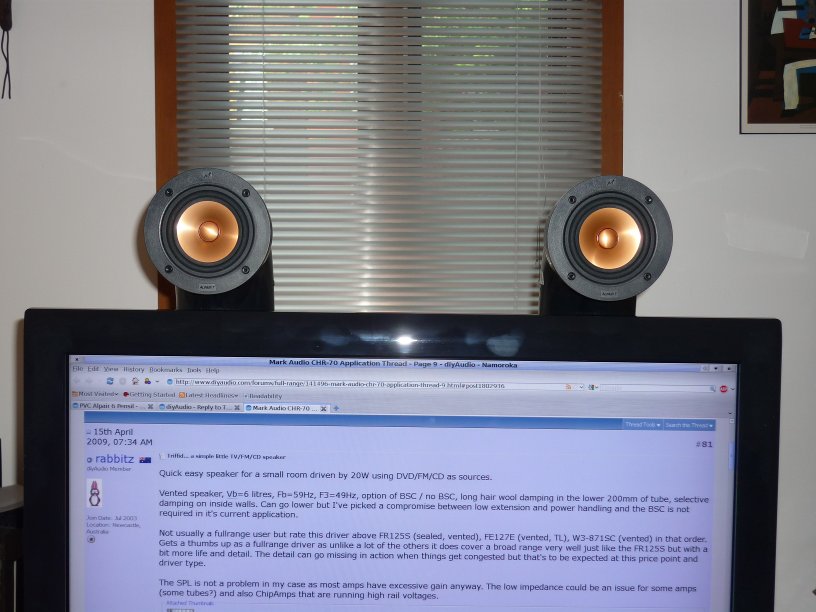

The last picture shows how I listen to them; they stand behind a 32" HD monitor (a TV), spaced by 16" (from centre to centre) in a ambiopole configuration, driven by a T-amp and a Linux computer with cross-talk cancellation software.
