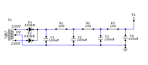

im about half way thru building the PV12 and have some B+ problems. i intended to use the cct below below but things are getting out of hand here as the target B+ is 250V.
from the transfo its 250Vac into a bridge. the bridge output is also 250V (rippled). shouldnt this be 1.414 times the 250Vac?
then the 250Vdc(ripple) goes into the RC cct below and at the output i have like 380Vdc which keeps going up and up. it just keeps going up and i shut it off.
can someone help me out here to get the 250Vdc RC based? thks

The 250 V rippled is due to no filter. The capacitor charges to the peak of the ripple value. The peak value of a sine wave is 1.414 times the RMS voltage. Without a capacitor at all, the DC will be equal to the RMS value.
Step 1:
Open the bridge and measure the AC voltage. Your drawing shows 200, the text says 250. 250VAC would equal about 350VDC with no load.
I'm guessing that the 100 Ohm resistors driving the 100uF capacitors are what is causing the slow rise. Is the capacitor voltage high enough to allow the circuit to rise to maximum? Do you own a variac? If so set it to 1/2 voltage wait for the circuit to stabilize and then turn the variac up slowly.
Step 2:
Add a temporary load resistor, if you own a 5 watt 24K Ohm resistor that would be a good value, since that equals 15mA (at 350V). The voltage may well be less under load.
Normally when this kind of unexpected thing happens it's because something you think is true or wired one way isn't what you think it was. Double check things. There's a reason the circuit is behaving as you describe, with some patience we can find it.

im using the RC section only of the cct. (minus the transfo info)
the transfo im using has 0, 250Vac, 250Vac or 310Vac at 0.15Amp. but actually when measured open, the dvm shows higher than the specified values for all.
the bridge comes after that and then all the RCs as above.
i managed to run into Duncans PS program and it seems that a 1Kohm res in series is missing between the bridge and the first RC. from there the B+ reading seems more realistic.
the program also needs a Rload which i keyed in at 7.7kohm because the 12AU7 has plate resistance at 7.7k......is this the Rload i should use?
So that would be 438VDC peak with 150mA load. This explains the higher than expected output you wondered about in your previous post.
the program also needs a Rload which i keyed in at 7.7kohm because the 12AU7 has plate resistance at 7.7k......is this the Rload i should use?thks [/B]
No, plate resistance is the lower limit of resistance. By biasing the tubes only partially "on" the current will be less. 7-10mA per tube might be a good guess. It shouldn't be all that important once the supply starts working like it's supposed to. Output voltage will be lowered by the series R's in the filters at about 1V to 1.5V per mA. Since the resulting output is higher than expected, maybe the 1K should be increased to 2K?
If the total load is 30mA the 1K resistor should be at least 2 watts (never run resistors at their full power rating, they get hotter than blazes and it effects their life).
