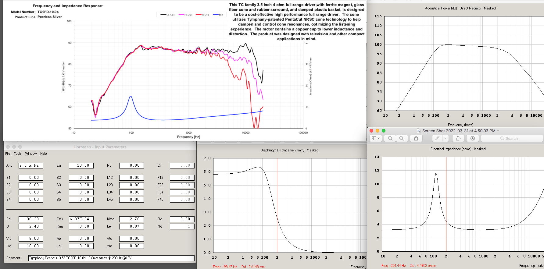

The Tymphany/Peerless TG9FD-10-04 is a 4 ohm 3.5 inch glass fiber cone wide band driver that may satisfy those requirements up to their power limitation. Although rated at 5 watts, they can take peaks in the 30 watt range with no audible distress.I'll keep watching the "full range" threads to see if anyone ever develops a wide band I can use as a mid that does the 500 to 5K range reasonably flat without severe breakup, does not require extensive eq outside the crossover, and had efficiency higher than the woofer as padding woofers is never a very great answer. About a 4 incher should do it without excessive beaming.
Hornresp simulation indicates they are under Xmax (2.6mm) above 200Hz at around 10volt input with 100dB output (half space, 1meter). Crossed at 500 Hz, they would smoke before sounding distorted.
At the usual listening levels of under 90 dBA at 2meters, the TG9FD-10-04 sound very clean, no upper breakup and the frequency response is as flat as the factory specs indicate. Also of note is how wide the dispersion is, 120 degree (-6dB) at 5kHz.
After using a Tannoy PBM 6.5 (2way 6.5"/1" tweet) I used the TG9FD-10-04 full range (with a sub) in my home theater mains for some time, finding the TG9FD-10-04 midrange sounded superior.

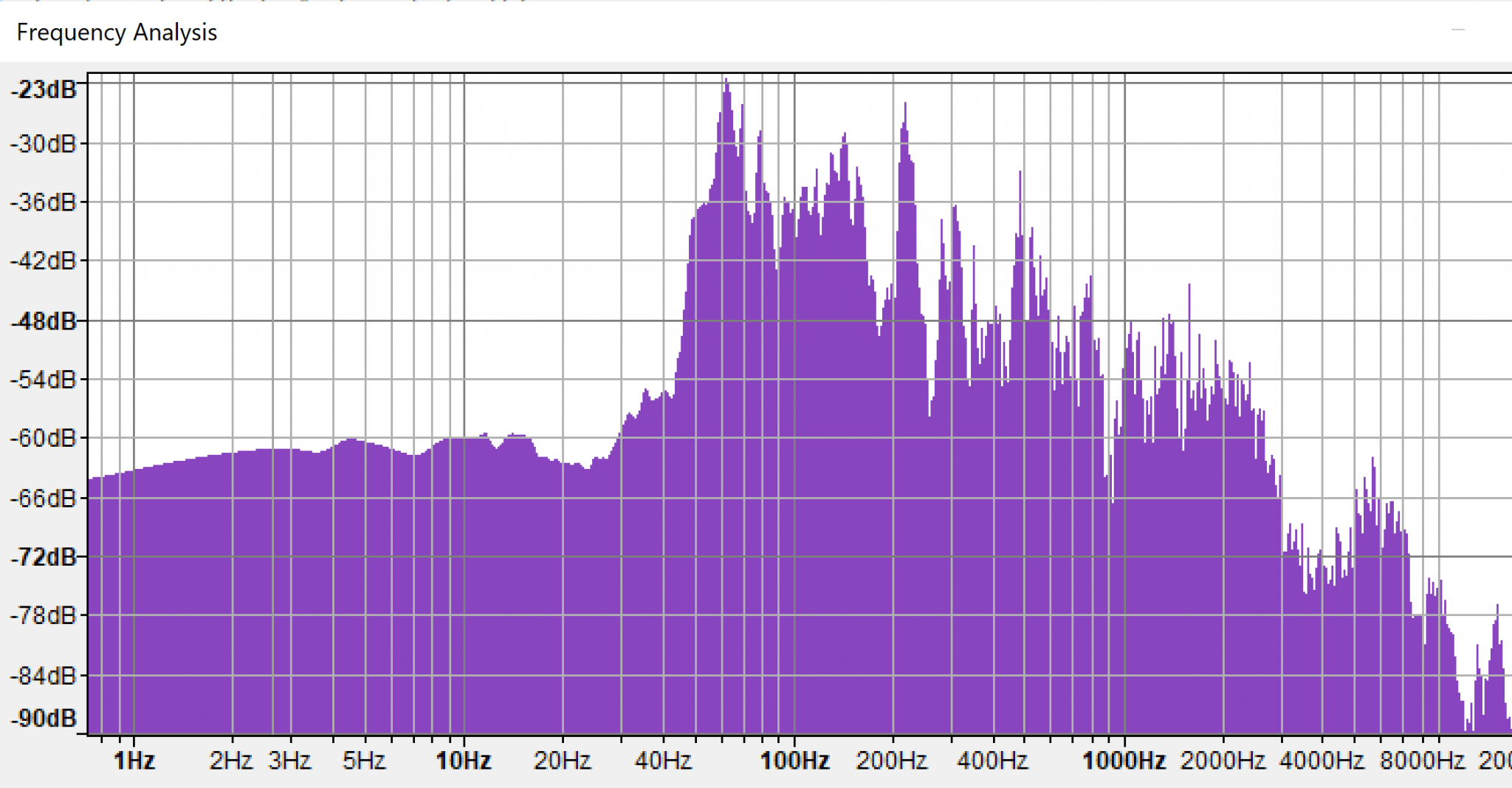

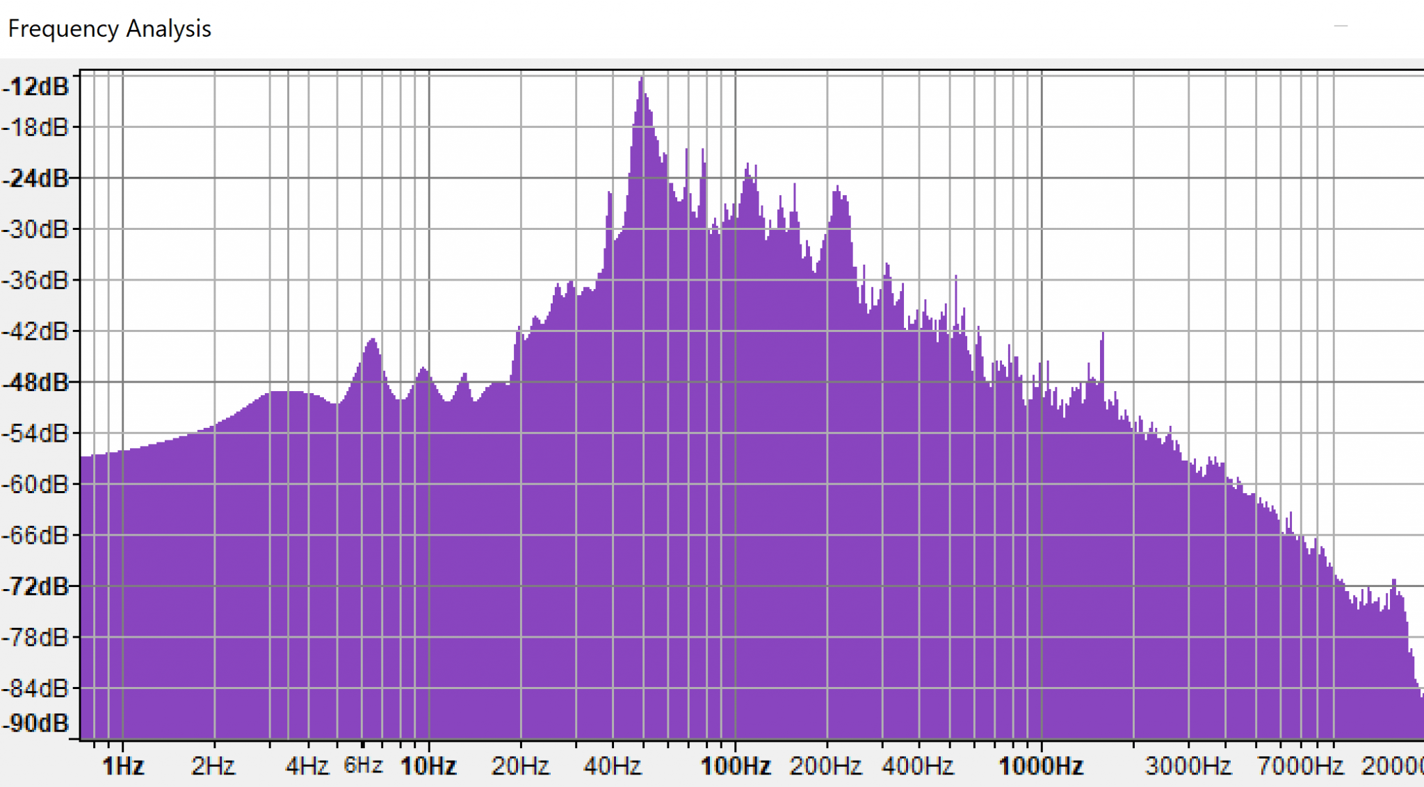

Single 15" "full ranger" on a Betsy OB. Amateur recording and spectral analysis: DR = 12
Original file DR = 7 !
Casual Analysis of the spectral analysis 🙂
PS The FR isn't mine so I'm not going to identify it.
- The FR Dynamic Range is hugely better then the original file making it sound more lively and engaging - like a live concert, for some. It seems to have achieved some decompressing of the dynamically neutered original. Is this a gift of high QTS and under-damping amps?
- The FR doesn't do much under 50Hz and that cuts out a heap of rumble and noise. Its a great HP filter for junk.
- The only bass lost is the 41Hz open bottom bass string but so what - its not often played anyway. Besides the 82Hz 2nd harmonic is as usually louder and the brain does the rest in reconstructing the fundamental.
- Although the FR is only on a modest OB it somehow gets a good SPL on the 60Hz peak

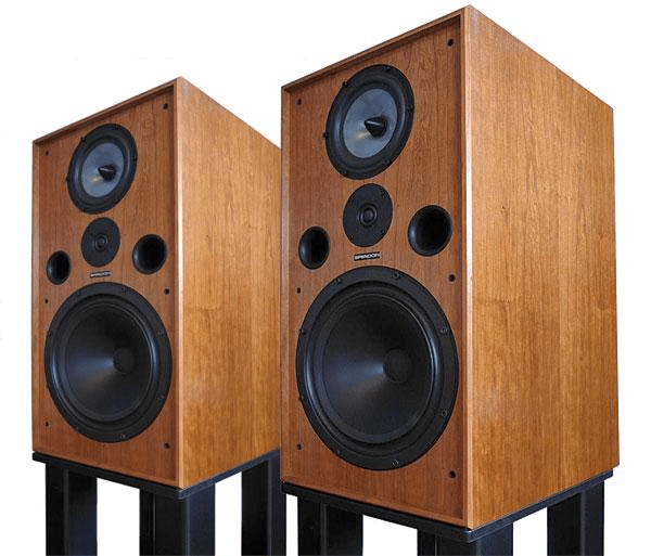

Lii Audio F-18 sounds pretty good here with flattering simple mid-centric music. More complex music could be another story. Id still rather listen to ESL for midrange timbre. Ive posted the recording below so its possible to put on headphones and swap rapidly from one to the other using the short term audio sensory memory to compare line by line. The original is much louder and needs level matching with the youtube volume slider:
and via Spendor SP 1/2
and lastly B&W
and lastly B&W
too much glass behind the toan speaker. too much reverberation. How are you supposed to compare different speakers?
I can't really tell much difference on my set up at work, but the B n W seem to have a boxy resonance, port noise ? I can't think that a commercial speaker would be that bad, and it must be at my end, but why only the B n W clip ?
