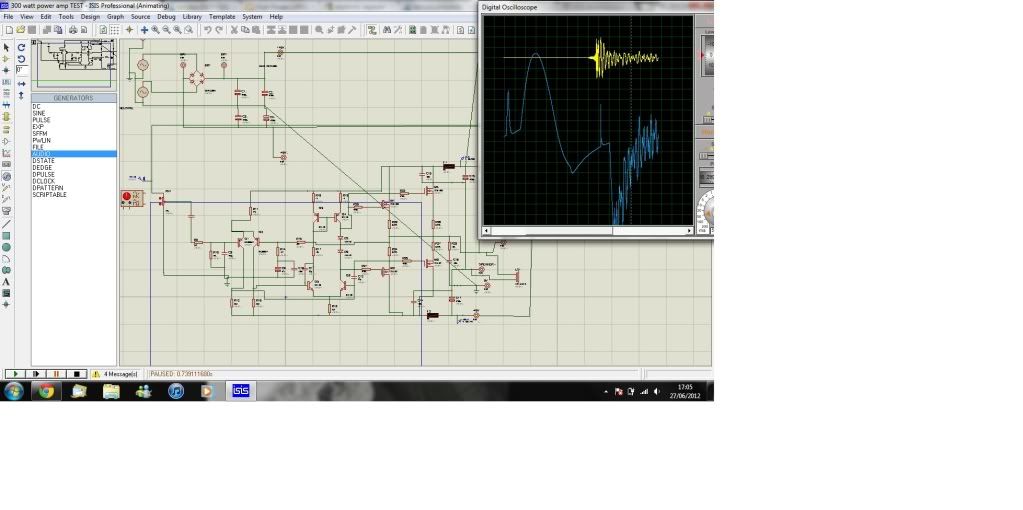

Looking at your circuit, IC1 output (pin 1) will slowly rise from 0V to 12V after power on due to the time constants of R1-R3 and C1 and C2. In turn, this will cause the amplifier output to be offset by 12V. Nico's advice (insert capacitor in series with R9) will prevent this happening.
Why not supply IC1 from a regulated split rail supply and connect its non-inverting input to signal ground?

can anyone tell me why my amplifier i have built is doing this when it starts up?
sam18 said:
this is just a simulation, im hoping to build this circuit soon.
Which of these two statements is true?
My impression is that you are well out of your depth. Try to build and debug a nice simple circuit. Much more educational than simulating a more complicated circuit.
The opamp based preamp is dc coupled to the power amp but its output is NOT ground referenced - if im not mistaken it will sit at +12V. You could either use a coupling capasitor at its output OR use a 12-0-12 supply for the opamp. Actually, i would do both since you do not have a dc servo ...

The differential VAS has 180uA current per leg , a value quite low
since it drives directly the output mosfets capacitances ,
this should be increased ten folds at least.
This make me wonder if the original schematic used the ubiquitous 2N5401/
2N5551 pair instead....
The BD139/140 are well within power spec but are out of spec for Vce...
