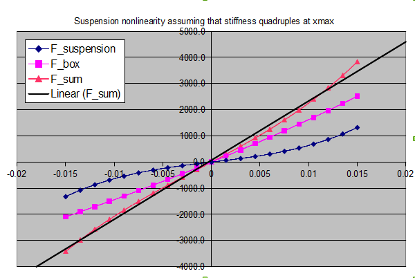

something I did a long time ago...
It is not an issue for small signal, but it can be for large signal as was shown in the Linkwitz writeup that I previously linked to.
Xmax of the 6.5" driver that I made my calculations from the specs of equals 2.55 mm. That would make my example large signal I believe, that is, I was looking at an excursion of 1.28 mm or about half of Xmax. I didn't intend for my calculation to reveal anything about non-linearity, but maybe it could? I'll have to take a look at the link to Linkwitz that you provided.
