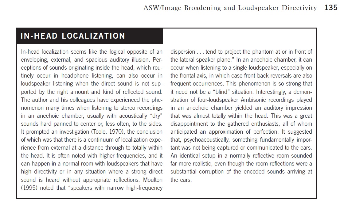

some reflections are just like second harmonic in the example that You gave:
For example mid band, 10% 2nd harmonic is inaudible even with a single pure tone and even less so with music which is mostly even harmonically related in it’s content...
and some are, so to speak, indispensable - "no reflections" is a "no option", and not just that it is difficult to achieve, I know, it is quite counterintuitive but still:

Fundamentally, what is the difference between this arrangement, and headphones? I'm guessing there is bleeding from both channels to each ear, and some effects from the shape of your ears and head on the directional wave fronts..? But taking it to its limits, are you ultimately aiming to get the same sound as wearing headphones?
Almost. With headphones, it is lateralization....with speakers it is localization.
When headphones are given identical L-R signals, the brain perceives it inside the head. Not speakers, in that case it is directly in front at some distance.
graaf...nice text. Certainly consistent with headphones, but extremely susceptible to L-R differences. Any reflections at all would spoil that effect..

The difference is the "in my head" location of the soundstage of headphones versus the externalized soundstage of speakers, which sounds more like a big picture hung in front of you.
Except the quoted text in Graaf's post above which suggests that in anechoic conditions you also get the 'in-head' sound with speakers.

If two speakers are playing a mono signal in an anechoic chamber, it seems to me that both ears will receive identical signals, hence the in-head effect. The signal at each ear won't be the same as that emerging from each speaker, however, because it will comprise a mixture of paths from both speakers, with the listener's head in the way of one of them more than the other. But both ears will receive this combined signal.

Except the quoted text in Graaf's post above which suggests that in anechoic conditions you also get the 'in-head' sound with speakers. ...
I've done Tom's "suggested experiment", though I didn't realise it at the time.
I was playing with a set of laptop speakers. They're very small, approximately the size and shape of a teacup. (Like these, but with a matching size battery powered amplifier):
SBA1500/97 Philips Portable Speaker System SBA1500 - Philips Support
I had them set up each side of my laptop, about 18 inches apart and 24 inches away. I was playing some music selections that included centre panned mono vocals and acoustically stereo recorded instruments, and was amazed by how pinpoint sharp the location images were. I could move my head several inches from side to side without affecting the image locations. When I moved the speakers further back and apart, to the limit of their cables, the images became less precise. (More reverberant sound from the room?) I moved to the backyard and repeated the process, and found that the images remained sharp when I moved the speakers back. Granted, the backyard isn't an anechoic chamber, but a large lawn makes a pretty good half space with no significant reflections at mid to high frequencies.
I've listened to the same music via headphones, and the mono voices just seem to be "in my head". Some of the instruments do sound "outside my head", but their locations are random. For example, there's a cowbell that very definitely sounds like it's above and behind my head to the left.
