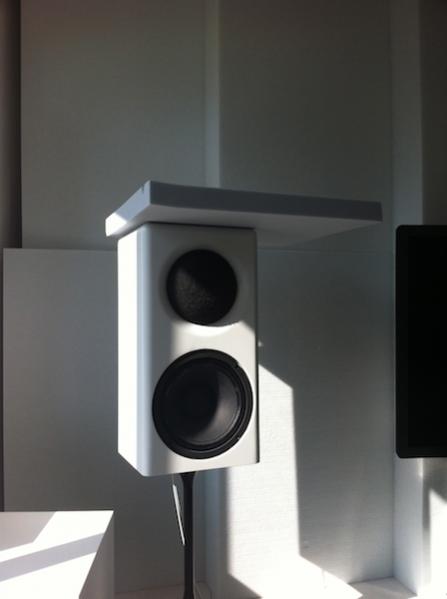

I had great success reducing early reflections by placing 10cm thick Basotect boards around the speaker. If I find the time I'll build an absorptive "funnel" around my speakers. Currently they wear "hats":
