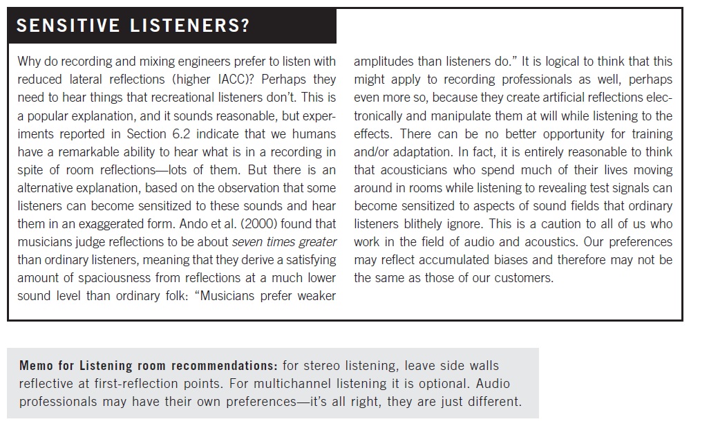

on the contrary this subjective experience of many professionals in the audio industry:
many find an immediate improvement when they add absorption on the side walls where one would see the loudspeaker if the wall was a mirror.
is not AT ALL confirmed in scientific research
it is surprising indeed and therefore Toole tries to understand what is going on, below I post the relevant fragment of his book, I find it very convincing, in one sentence:
Audio professionals may have their own preferences -it’s all right, they are just different
OTOH apparently not all professionals become abnormally sensitized and biased because of that, for example Mr Olhsson, quoted above in my previous posts, is an example of professional with quite normal hearing, Mr "Golden Ear" Moulton too and many others
