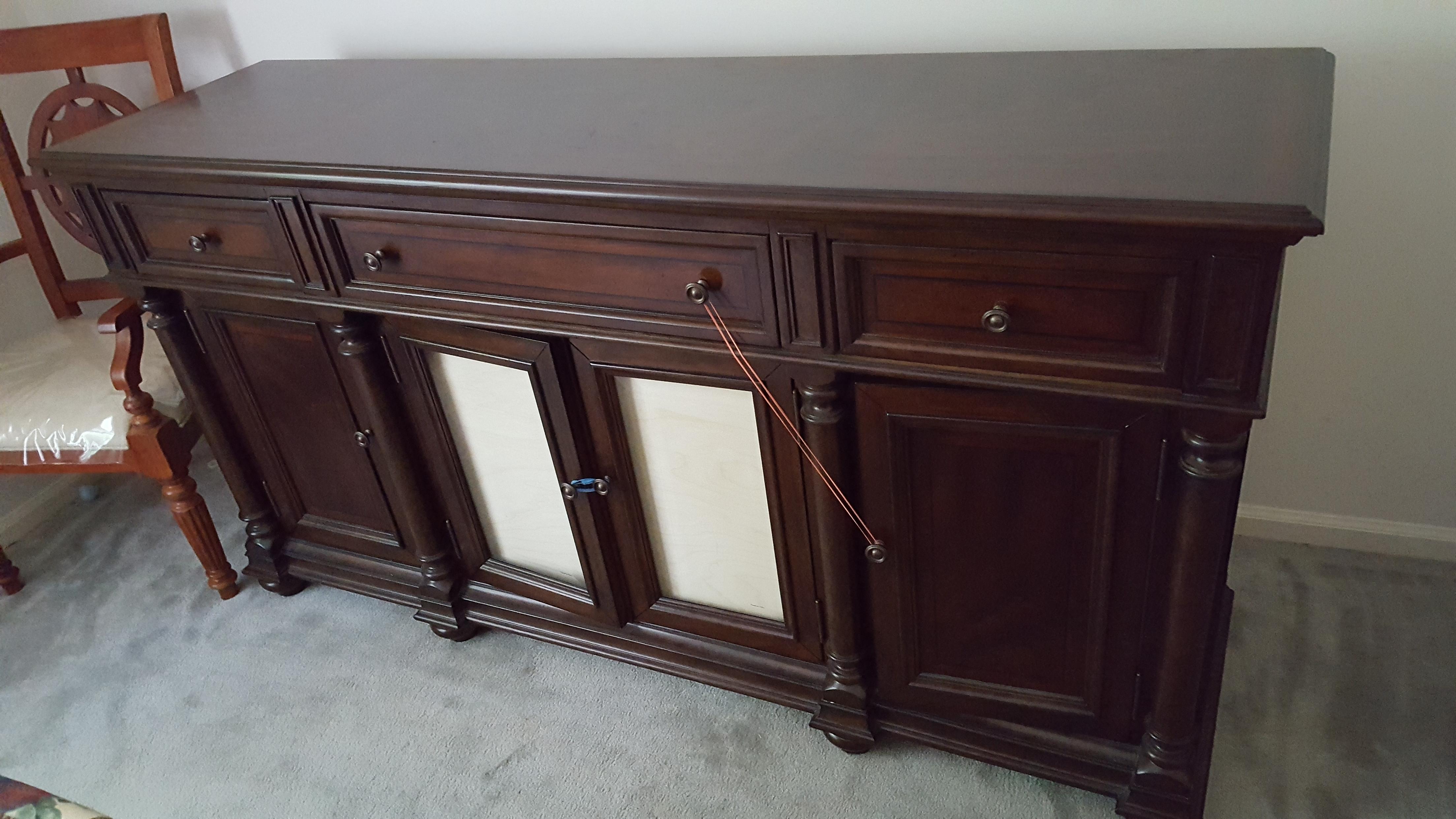

I'm interested in seeing what other people have done to incorporate subwoofers or large speakers into furniture for saving space. I just built my 1st enclosure yesterday for a 12" sub. Being a beginner, it's sealed and pretty big, 38 x 48 x 61cm to get a flatter response. The XED12V2 has Qts=0.55, and needs a 153 liter enclosure to get 0.707 Qtc. It sounds loud even with a small 100W TPA3116 amp.
Being a huge fan of making things multipurpose, it occurred to me I could've just bought and modified a storage cabinet, which would allow storage in addition to being a table.
I looked at the offerings on hidemysubwoofer.com but none of them allow storage. I'm trying to think what type of gasket you can use to seal the doors and what other issues you'll encounter.

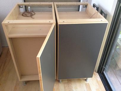

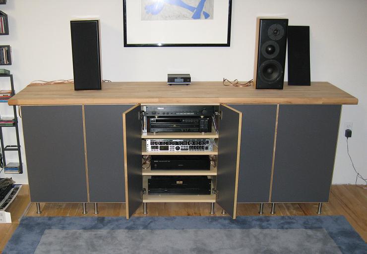

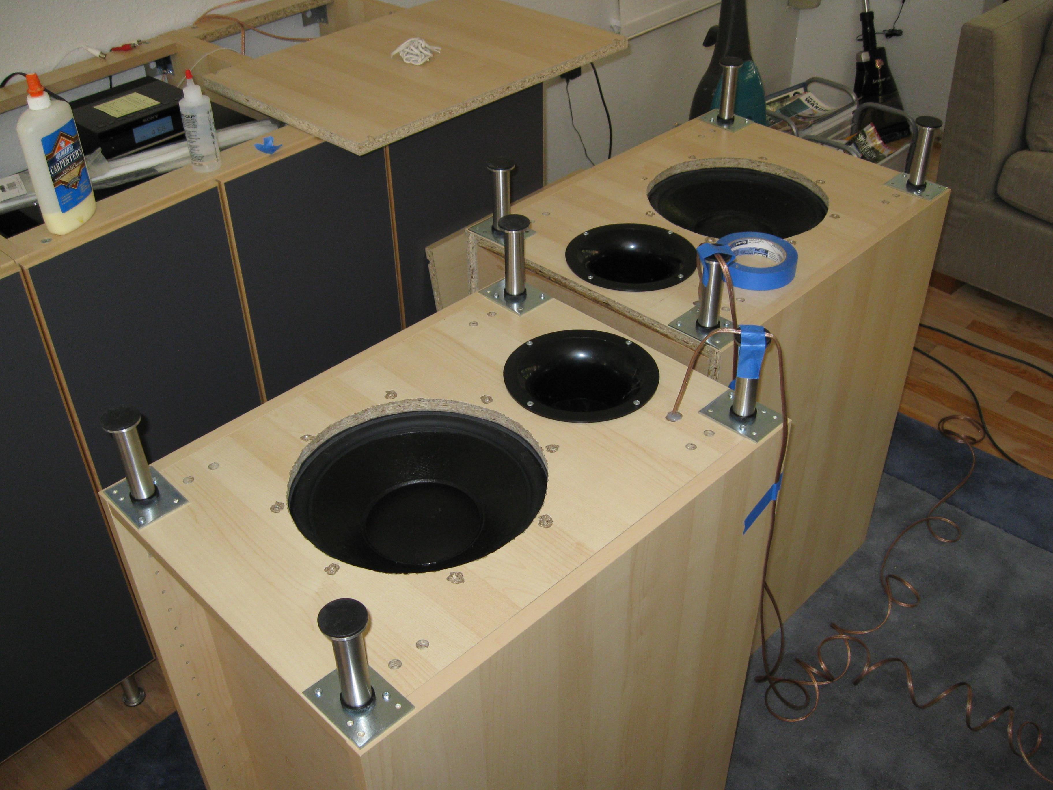

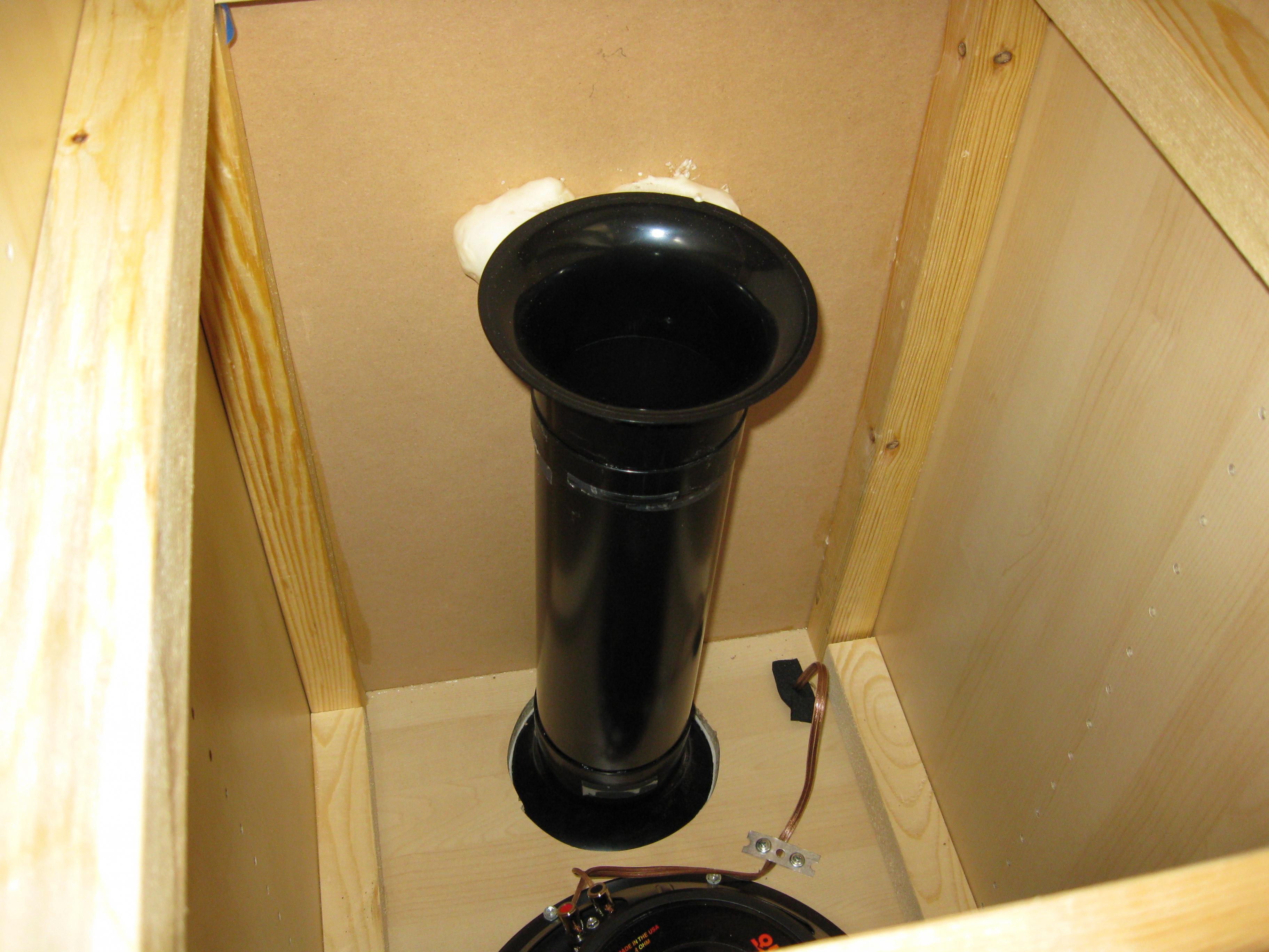

Going back over 10 years now and no longer in existence, I built a pair of subwoofers into the end cabinets in a row of IKEA cabinets and used the middle cabinet as a stereo rack for the gear. This worked pretty well actually and the volume for 12" subs was perfect. To make the cabinet into an enclosure I installed a panel behind the doors, used a spare shelf as the top panel, and then sealed up all the leak points. Pics attached.

Nice, but I was hoping you didn't give up the storage. I guess with the ported tube, there isn't much room any ways. Did you have any resonance issues? I usually don't like particle board furniture, but for enclosures it has an advantage because it's more dense than solid wood.
The space was dedicated to the subwoofer(s)... you cannot fill up your speaker cabinet with stuff, eh?

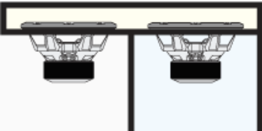

If you want to make usable subwoofer furniture, a dual-opposed woofer configuration should be helpful. That was the shaking forces of the woofers cancel each other out.
This is the right approach. A rigid cabinet with the drivers opposed but frames mechanically coupled would result in very little vibration.
I had a GL75 turntable sat on top of a 2x12" subwoofer for a while. Zero LF feedback, because the sub was dual-opposed and didn't vibrate.
