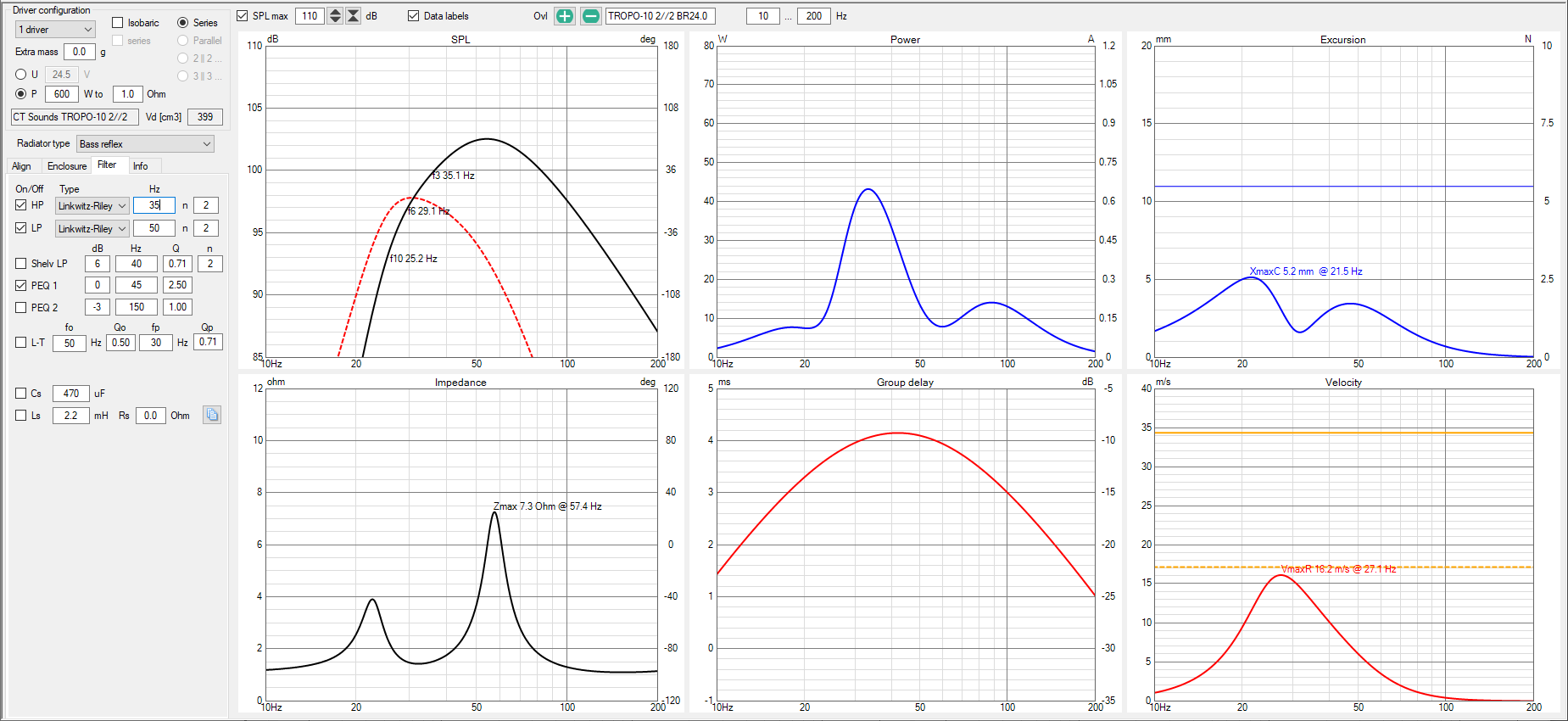

This could very well be a little bit underwhelming. However, I have a Tropo 10in that I would like to switch since it is an under the seat box. The box has .85 cuft sealed, now that's the problem. I understand .85 isn't crazy, but this subwoofer calls for 1 cuft ported. I've been doing some models on SpeakerBoxLite ( I don't have WinISD) and it seems very promising. However, the port is the current issue; I am not fully set on a design just yet because of port velocity. Also, I think there are better minds on here that might be able to help. I have a 3d printer, so I can build any type of port. The truck that it is in right now is a 2018 Ram, I was thinking of making that long part of the box into the port but I am open to suggestions. If a port came out the back side I would have the ability to have part of the port outside the box. I want to aim for 38hz, since that seems to be the best for a flat line. However, it has 30m/s port velocity. Which I know can affect the performance of the sub.

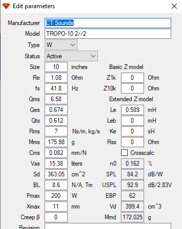

Which Tropo subwoofer 10-inch driver are you using? Is it the one with Qts=0.502 or the one with Qts=0.408?
Also, does your amplification have any provision for applying some parametric EQ in the low frequencies between 20Hz and 40Hz?
You might consider downloading and using VituixCAD. It has a very flexible simulator to help study low-frequency alignments associated with woofers.
I have the dual 2 ohm version, which says to have a Qts=0.612
My amp which is a D4S JP8, only has lowpass and Subsonic and thank you for the suggestion I'll check it out. I think even if I tuned it to 50hz it would be way better then being sealed.
Thanks. I found the Tropo specifications for your driver with the Qts=0.612. I guess you'll be connecting it 2//2 = 1-ohm load? Your amplifier seems to be rated down to 1-ohm.

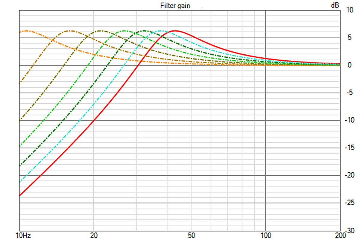

I guess that the infrasonic (also known as "subsonic") high-pass filter is a second-order peaking filter, with adjustable Q. This would allow it to achieve +6dB of boost when Q=2.0 when set appropriately.

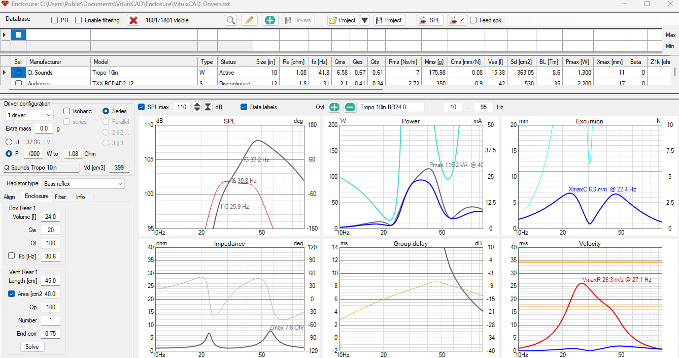

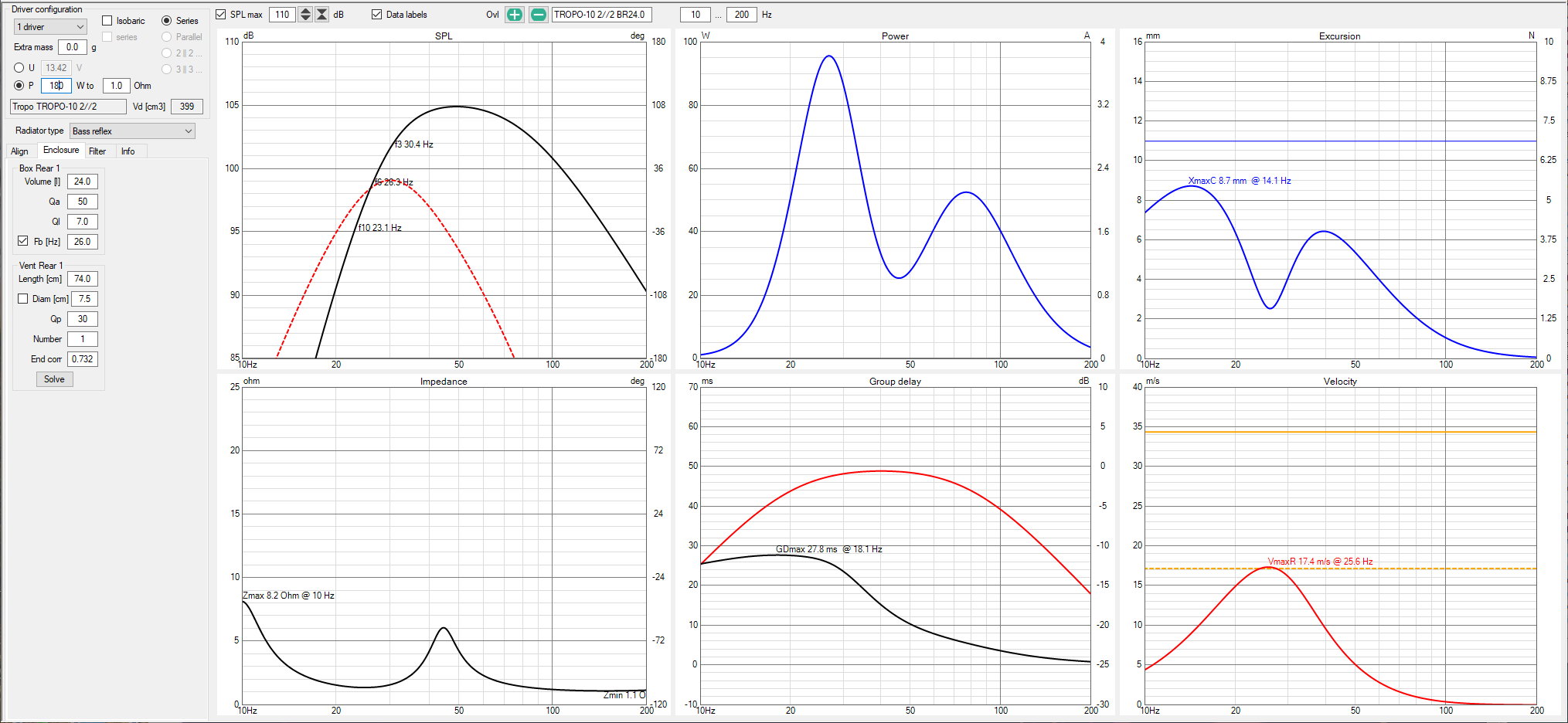

You have a 0.85cuft enclosure, which corresponds to 24 litres. That's quite small as far as vented enclosures go. If we chose a 7.5cm port diameter, it would result in a quite long port to try and keep the vent air velocity within typical guidelines.
Here is a simulation of the driver in a vented-box enclosure, obtained using VituixCAD. The box volume is 24-litres, and the vent is tuned to 26Hz, using a 7.5cm diameter port of length 74cm. I've applied a 20Hz 2nd-order Butterworth high-pass filter to control the infrasonic cone excursion, as well as an 80Hz 2nd-order Butterworth low-pass filter. With a nominal 180W re 1ohm of input power, we get 105dB of SPL at the point where the vent air velocity has reached the first turbulence warning. The driver is still operating well short of its Xmax, so it could take a bit more input power.
The f3 of the vented-box alignment is 30.4Hz, which seems to be quite reasonable.
If we add a peaking 2nd-order high-pass filter to the existing subwoofer, we can get the following response. Here the infrasonic filter would likely need to be set to 30Hz, and the bass boost to +4.5dB or thereabouts. The simulated response has f3=29.5Hz, which is similar to that of the vented system modelled earlier. Note that we ae operating close to Xmax. You could give this set up a try to see if the simulation is reasonable.

The following simulation in VituixCAD is of the infrasonic filter in the D4S JP8 amplifier using the assumption that it is a 2nd-order high-pass peaking filter. I've adjusted the boost to equal +6dB. From left to right, the set of 7 curves corresponds to frequency settings of 10Hz, 15Hz, 20Hz, 25Hz, 30Hz, 35Hz, and 40Hz. These are within the 10–50Hz operating range of the infrasonic filter (I chose to leave out the 45Hz and 50Hz settings as the graph was getting quite busy!).
With the Bass Boost control set to 0dB, all of the above filter functions would then likely turn into 2nd-order Butterworth high-pass filters with −3dB points corresponding to the frequency setting of the infrasonic filter on the amplifier.

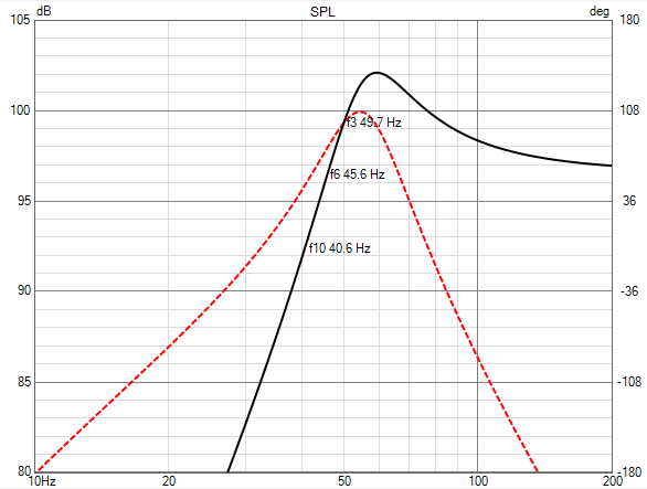

If you tune the enclosure for fb=50Hz, you are going to get a very peaky response from your subwoofer. That's a result of its combination of Thiele–Small parameter. The high Qts value of the Tropo-10 driver does not go well with that high a value of fb. For the 50-Hz tuning, the natural unfiltered response looks like the following, with a big +5dB peak near 60Hz. This is likely to produce "one note" bass, and little if any effective bass extension.
The lowest tuning that I would aim for with this driver would be 35Hz. This produced the following results, with both the low-pass and high-pass filters active. Compared to the fb=26Hz tuning case, here the f3 is much higher at 36.2Hz. Of course, this tuning results in a much shorter vent than before: Lv = 38.4cm for Dv = 7.5cm.

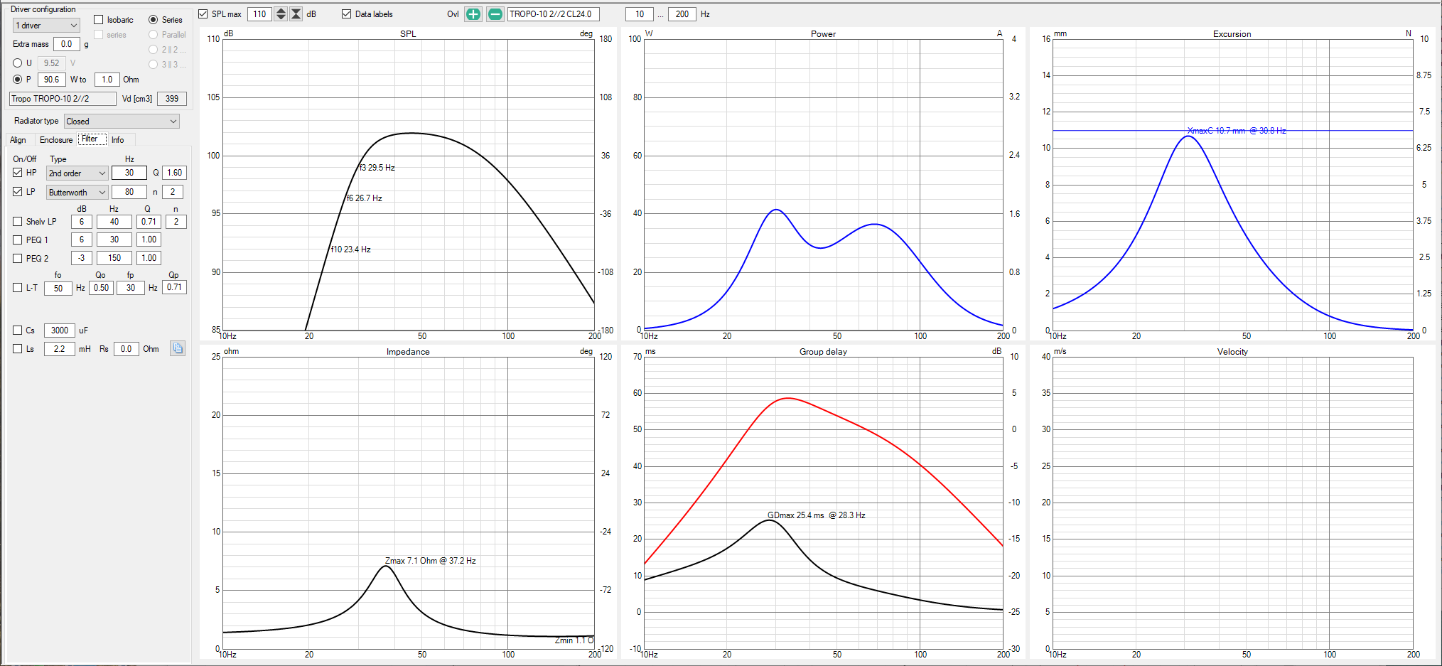

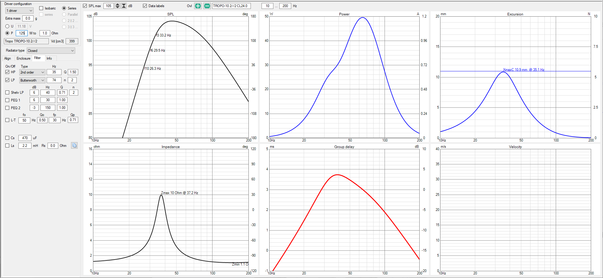

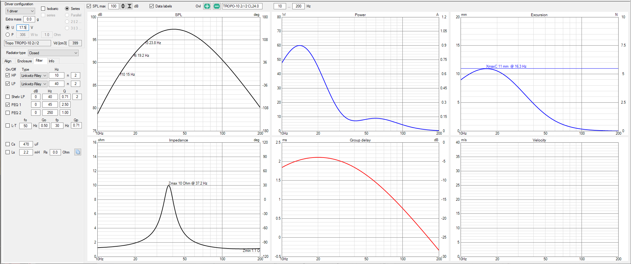

Below is one possible closed-box enclosure solution, designed with lots of low-frequency extension in mind. It includes about +4dB of peaking boost coming from the appropriate setting of the infrasonic filter to 25Hz and the bass boost to +4dB. These are facilities offered by your power amplifier. Here f3=25.9Hz, with a rounded knee, which will make use of the available "cabin gain" at those low frequencies. Peak SPL output is 100dB for 75W re 1.0ohms. The actual power dissipation is less than that, as a result of all the filtering that's going on. The driver's Xmax is reached at 25.9Hz.
Another tuning option, shown below, produces a maximum SPL of 102dB, with an f3=29.5Hz. This includes +4dB of bass boost when the infrasonic filter is set to 30Hz. That's still a good result for a "subwoofer".

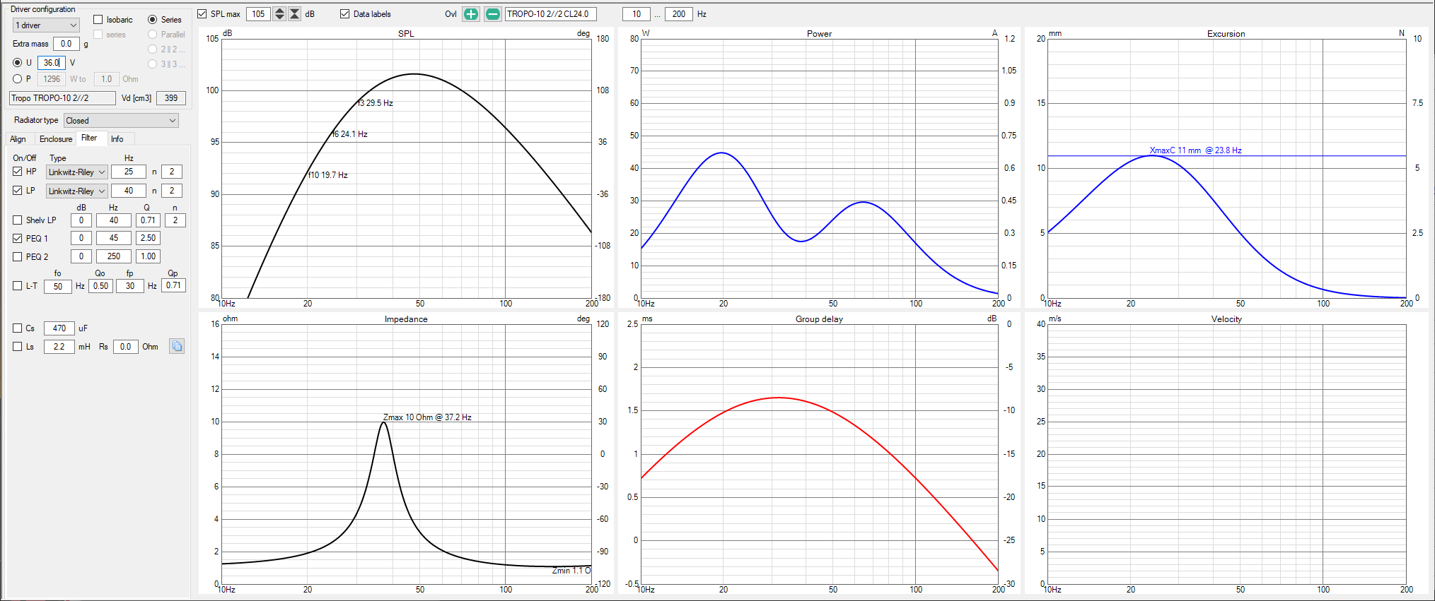

If we wish to trade off a little bit more low-frequency extension for a higher maximum output level, then the following alignment can be considered. It produces a maximum SPL of 104dB when Xmax is reached, using an input power of 125W re 1.0ohms. The infrasonic filter was set at 35Hz with +4dB of bass boost. This is also a quite good result.

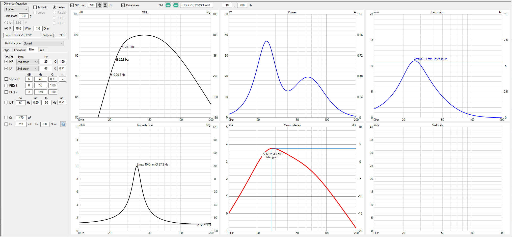

Using those parameters, a possible closed-box alignment would be as shown below. Here the high-pass and low-pass filters are set to 10Hz and 50Hz, respectively. No bass boost is applied (the PEQ1 setting is 0dB). With these settings, the response is −6dB at 94Hz relative to the peak SPL. As there is a great deal of complex interaction between the response of the driver and the response of the filter, that −6dB of 94Hz point doesn't correspond to the 40Hz setting of the low-pass filter. You can see that the maximum power input is 60W around 15Hz or so, while above 30Hz it stays below 14W.
By increasing the high-pass filter setting to 25Hz, we can obtain approximately 3dB more maximum output SPL when Xmax is reached. The response is −6dB at about 105Hz relative to the maximum SPL.

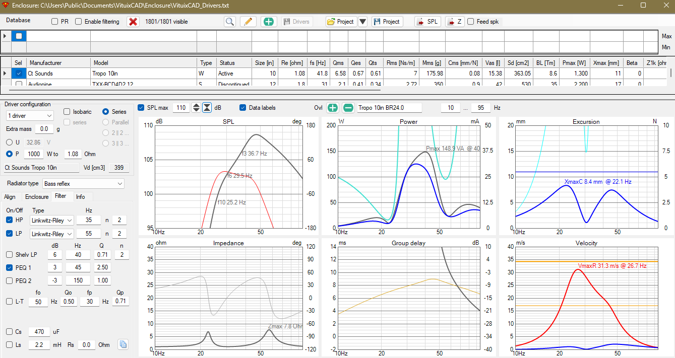

Interesting, I might have to try that real world and see. I tried the other way you suggested and I will say it is impressive for what it is, nothing like my 12in though sadly. I was doing some models on this software with a port and I would like to get your opinion on them.
This is with a 40cm^2 port area and 45cm length, I know the velocity is a bit higher. However, I'm sure this wouldn't draw too much concern knowing it is pointing to the back wall under a seat. I decided to play around with the filters(never did before) and made the velocity a tad lower. I did put 2 ohms, because that is how it is connect right now(probably will change) but I also know my amp will be able to put out 700-800rms at 2ohm.

In your Tropo 10 driver specifications, the Rms value is 0.01. That is way too small, and doesn't match up with the Qms value, from which it is derived. A more accurate value for Rms is 7.0, and it was calculated using the values of Sd, Fs, Qms, and Vas for the driver. Also, the Mms value that you have used is 0.29 grams, which is clearly incorrect; the CT Sounds data mentioned that Mms = 175.98g.
Those sorts of errors will cause your simulations to be quite inaccurate. I'll be interested to see the revised simulations.
The following parameter values for the driver are what I think are the correct ones, and I have used these in my simulations. Note that I calculated the value of Rms from the other parameters, as it wasn't provided by CT Sounds.

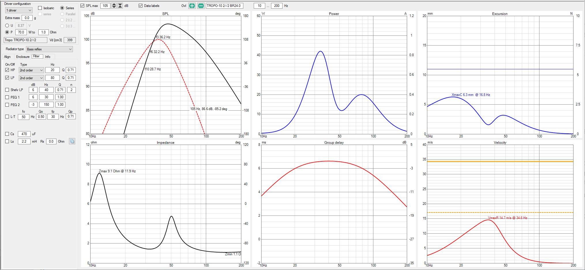

Apologies for the wrong values, I got them corrected now thank you. The idea that I had for tuning it so high on the subsonic was due to the port velocity at around 1000-1200 watts ( I know it wouldn't be the consistently, but I figured it did still affect the subwoofer). Right now it is just hooked up to 2 connections, I believe, now I can also change it. (But I don't know how much that would affect it other than it's power, which there is more than enough) Also I do see what you are saying on the website it does only show both voice coils hooked up. However I must be running it at 1 ohm already, I do not remember entirely because it has been sitting basically all year. But when all said an done it will be hooked up as 1 ohm.

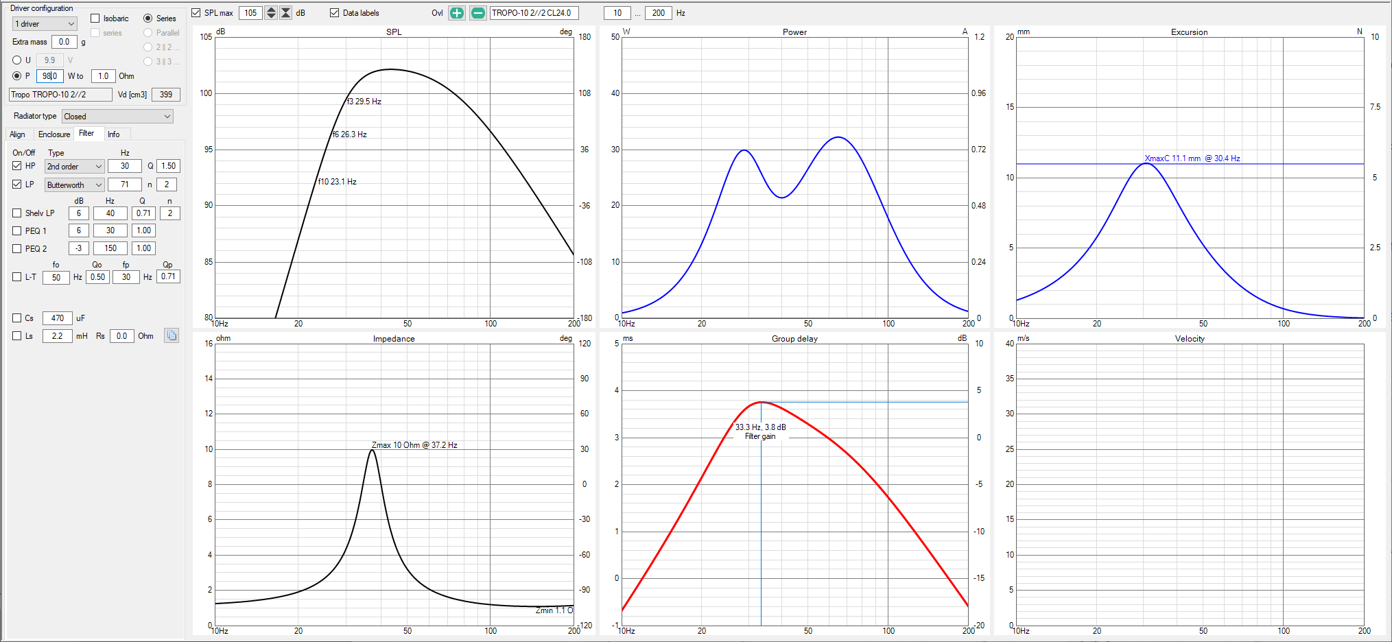

This one I tried bass boost of 3db on it with the subsonic= 35hz and highpass= 55hz, understanding that the velocity is a tad bit up there. However, I do not know how bad that is since it is at 26hz and I am sure that would not hurt the sub.
This one is with the subsonic at 40hz and lowpass at 55hz with the 3db boost. I figured since it is at 45hz like you said that it should not kill the port velocity, but I am unsure. Also this is the port area in my picture, I don't know exactly why it is 1 hz difference. Peaks at 47hz with 108db.
I think taking the model you just made is probably the best option right now, it is a tad louder than a sealed enclosure and still has a low port velocity.

@addam There is a 1Hz difference in the port tuning frequency because our two enclosure models use different values of Qa (absorption loss) and Ql (leakage loss). I used Qa=50 while you used Qa=20 (a higher loss), and I used Ql=7 while you used Ql=100 (a much lower loss).
The settings that you've chosen seem to be producing a relatively narrow response from your subwoofer. If that's the aim, then that's a reasonable choice of settings. I tend to favour a broader and flatter response from a subwoofer, as it's usually called upon to deliver a wider range of frequencies than those occurring near a peak in its response.
