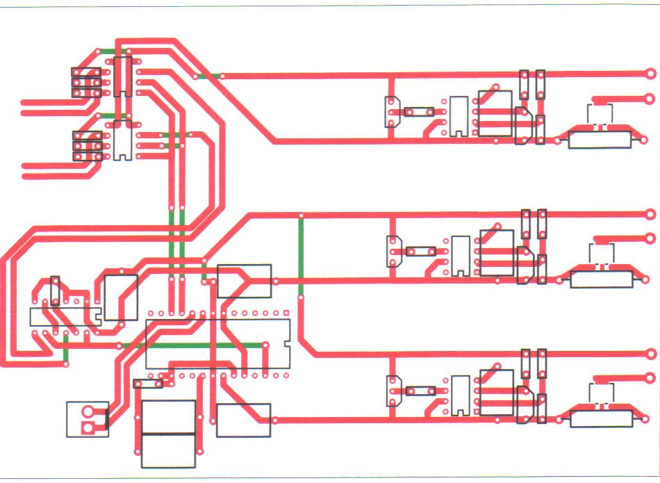

Finally getting around to finsihing Dac and had some questions. What are alternatives for the Blackagates used in the circuit. I have MKP1837 in those values, but have read that FM and FC mat be preferred. Until i listen for a while, I cannot justify the steep prive for sized blackgates. Here is my DIY PCB, doesn't include prefilter, psu output caps, or dac output caps. They will be added. THought someone might want to help double check or offer routing advice. Single sided is probably best i can do without suggestion.

There is no real "alternative" to Black Gate, unfortunately. For me, the "second best" in digital are Sanyo Os-Con or Elna Starget (Stargets being mellower and more pleasant of the two, but slightly less precise).
The PCB looks nice and orderly, but is kinda hard to read without any part names... What is the 14-pin IC on the far left?...:scratch:

Hi Peter, I think this is interesting, but I cant find this part. I am looking to get a balanced out to drive a long line (from digital TV to stereo amp). I understand this is to get one chip to reverse the signal in polarity. One TDA1543 gets DATA+ the other DATA- signal.
Do you have a source or ref of it?
albert
Can it be the 74AC86?
Being a Quad 2-Input Exclusive-OR Gate?
The 'AC' series is normal CMOS (i.e. symmetrical) logic levels and the 'ACT' is TTL-compatible logic. Since the source is a CMOS part either should be OK from a technical pov. I don't know if Peter's auditioned one over the other though.
For myself I prefer to use the 'HC' family as it generates much less switching noise. In driving my own TDA1543 DAC I run the part (74HC86) from a TL431 shunt regulator at 2.5V to keep the edges nice and gentle 🙂
Its similar, not identical because I have no use for the phase invert switch. I have a switch but its used to check the balance of the two (positive and negative) sides. So in mine there's a 'normal' position and a 'test' position where there should be nothing coming out if all is correctly working 🙂 This means I'm only using two gates for data, I use the other two to buffer BCK and WS.
