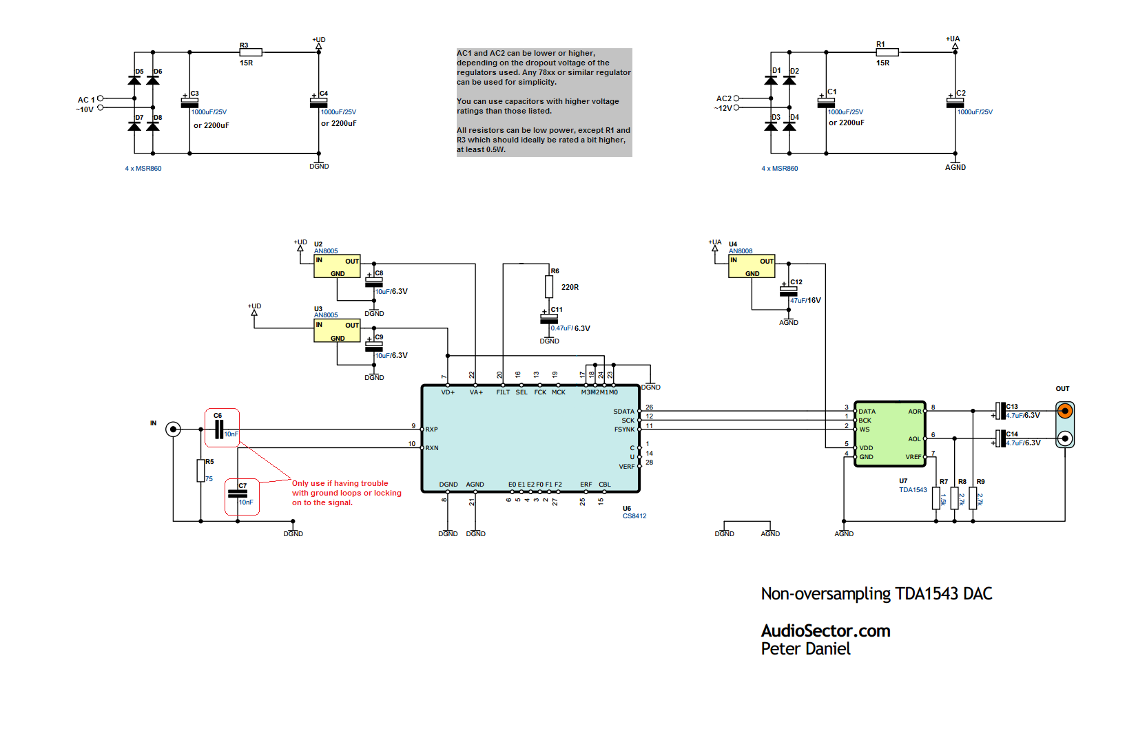

In its basic form, it's one of the simplest audio projects ever, not much more complicated than a stereo Gainclone 🙂
You essentially have just:
- CS8412 IC and its power supply
- TDA1543 IC and its power supply
- 1 input resistor for CS, 3 output resistors for TDA, 2 output caps and 1 resistor+1cap for PLL filter. I think that's all.
The schematic only looks daunting because the power supplies are very sophisticated, but you could use a much simpler arrangement and still get very good sound.

I'm afraid the NOS DAC is a bit more complex than a Gainclone... I mean it is simple for a DAC, especially if you use IC regulators, but there are still things to consider, like managing digital/analogue grounds, shielding, input isolation etc.
I mean, you could just solder it together on a protoboard as per Peter's schematic, and it would likely work fine - all I'm saying is that the range of trouble you could potentially run into is much broader than with a Gainclone... So I do not think there is a thread with instructions for beginners because without the kit, it is not really a project for beginners...

Here is the most basic NOS DAC circuit that you can attempt to build, that will still work (and likely sound reasonably good too). I took Peter's "classic" schematic and edited it to simplify it. I also incorporated some of the recent updates into it. Have a look and see if this is something you would feel confident attempting.
This simplified DAC should actually sound better than original - with the following reservations:
- the original NOS DAC used very high quality passive components (Black Gate, Riken, Caddock), some of which are no longer available.
- the IC regulators that Peter liked are also no longer produced, and somewhat hard to obtain, which means you may have to resort to LM78xx-type regulators (which will likely sound worse). Where simplicity is not that important, one could go with any of the new low-noise regulators, or buy/make a "super regulator" (such as the Bobken reg discussed here earlier).
- using different regulators could mean that the optimal values for their output caps are now different.
- your shielding arrangements, and wire routing choices will have some impact on the sound, and may sound a bit worse than Peter's PCB (although it may sound better too).
- the classic DAC uses a ferrite bead at the input if the regulator U3. I prefer the sound without it, but some people like it. It does (theoretically) make sense to install it if you use a single trafo, because it will limit "spreading the contaminations" in the power supply.
One could probably go even further with the simplification, and feed the regulators from the same PSU, but I think that would be going a bit too far in terms of sound quality compromise, and it would not simplify things that much (if you know how to build one diode bridge, then you certainly know how to build another).
