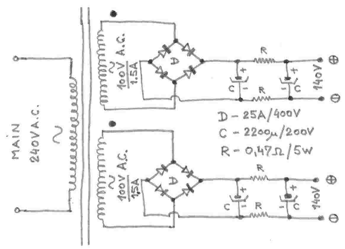

So now over to StoneT to build one of the amps, no output transformers but a whole stack of power transformers. And those capacitors for the output stages, what to go for?, no mention anywhere of what they should be.
Lets start with a minimum of 4700uF at 160 Volts, oh and for good measure they should be LoZ types and 105degree with alll that heat floating about.
Comments welcome

I sugest You to use two 4700uF/200 V DC for output power stage 2x140V V/DC floathing PSU ,since 4700uF with 160V/DC ratings is very close to 140 V/DC rail voltage .
Some `healty` capacitors breakdown voltage reserve have to be have Allways for those PSU Elko Capacitors.
Here is My litlle modified output power(Circlotron) PSU schematic.
Important: This two 140V/DC PSU minus output to NOT tight anywhere to the ground point !They have to be stay Independent and Floathing with respect to ground point.
105 degree temperature ratings is good choice.
Best Regards to All 🙂
