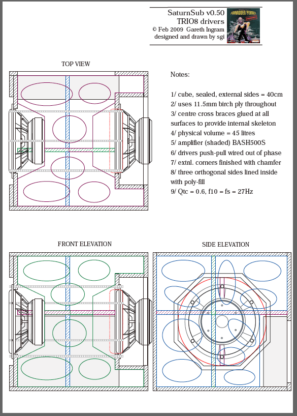

I'm trying to link the magnets through the box in my push-pull, but its clearly way easier to do this with your push-push (magnets back to back) where the box need not handle the forces between magnets at all. In the push-pull the forces have to go through the box but with zero experience in this game I'm not sure my box design is adequate but I am trying to couple them to the box as you suggest. I've posted the design in a separate thread to try and get some input on that. Unfortunately a common rod doesn't look feasible in my case.

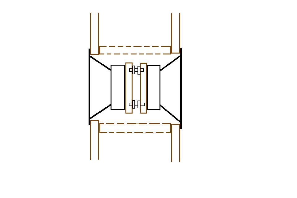

Small problem is that you need access to the drivers inside the box, after they are mounted
Choose a driver with a stable frame, skip the magnet-magnet rod/connection. Use rods between the drivers mounting holes instead. There is after all a limited force the coil can push/pull and flex the frame.

3. Seems unsound to me to use the back-end of drivers as structural elements even though very sound to use cross-bracing otherwise. Virtually no way to keep from having destructive box/mechanical forces acting on the magnetic structures when hooked up as some have suggested above.

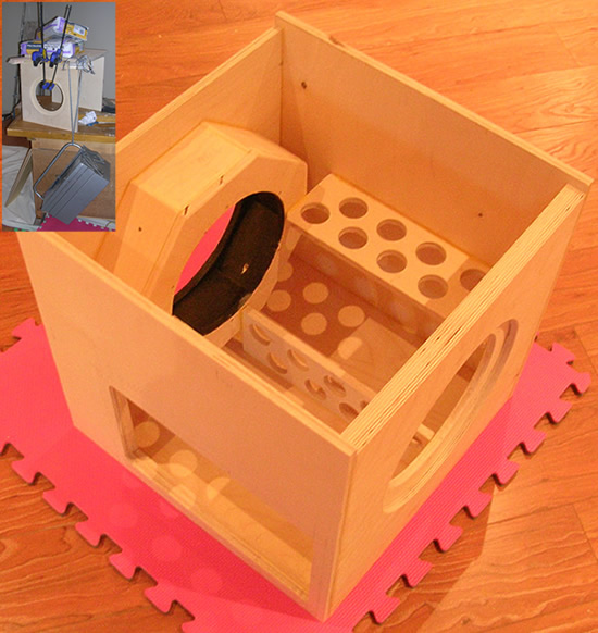

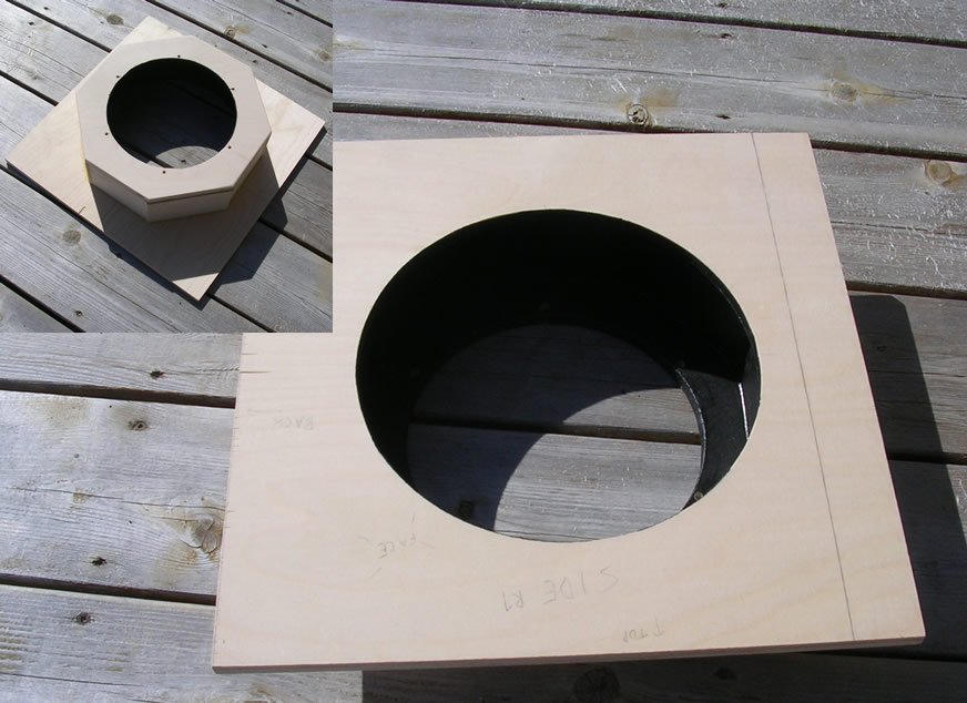

Well progress has been made. The side of the box housing the inverted driver is mostly finished and painted black inside. It's not the most accurate job, if I were ever to build another I'd know where to focus my effort.
I've decided no way I'm making up all those fancy braces I had planned. The accuracy needed on so many edges implies a Spring season spent sanding and cussing. I will devise something more practical.
(apologies for the poor state of my deck... but the snow has only recently receded)

I'm simplifying the braces, there will be more of them yet but here's the box taking shape (photo is a little grainy)...
