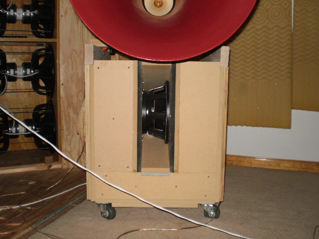

I've been pondering the same thing. I did actually have my ppsl midbass slot firing into a short "stub" horn for a while. It was not an ideal horn, had very thin walled flares, but it did some amazing things. I have re-built my ppsl enclosures to where the two drivers now share a common volume (which should have been done in the first place, but long story). The sad truth is I do not know how to use the "Horn response" program, but I do believe the ppsl common drivers can be termed "offset", but I admit to knowing very little.
In it's existing form, the ppsl is quite dynamic, but I have a feeling that being loaded in to a mid-bass sized horn would provide even more dynamics.
I don't need sub bass, as I have an infinite baffle sub woofer.
