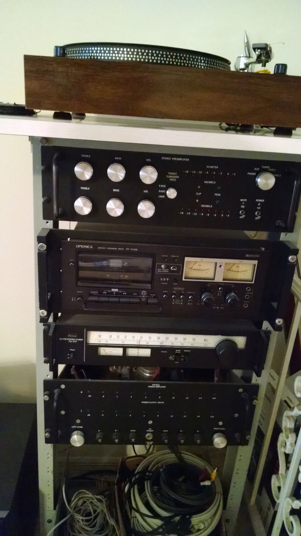

This is a stereo I built in 1977. Preamp was based on a Douglas Self design. Power amp is a clone I made of the Quad 405. The 405 clone worked the 1st time I turned it on. It failed when I took it to college and didn't notice a speaker wire had shorted. It's been working ever since without a single repair. I built numerous amps prior to this, tube and semi including SWTP kits. The SWTP amps sucked and needed constant repair. The one at my frat house also blew regularly.
Having an overly complicated design can be a nightmare especially if they are not thermally stable like the designs from SWTP. The SWTP amps worked great...as long as you didn't push them for any extended time...Kaboom every time. My Quad 405 clone was used for many an all night party without issue.
My turntable was built from a kit. All metal work done with a Dremel and metal files. PCBs made using tape and etched in a sink.
