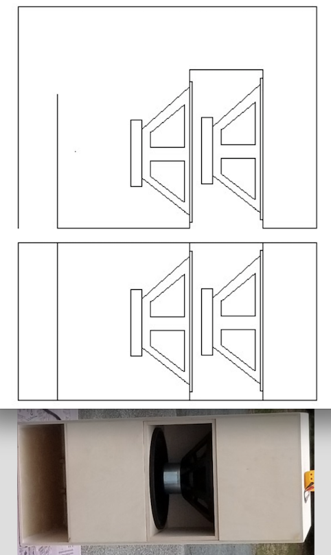

How about mounting the drivers as in the picture?
The slot is only 5cm if using the Tang Band W6-1139SI.
Space is limited..
Space is limited..
I would mount the drivers with the cones vertically oriented; as drawn the cones may sag. Your cabinets will appreciate the reduction of vibration, as will the contents.

Any advantage from mounting one driver inverted?
The only advantage is if the drivers are prone to non symmetrical excursion due to imprecise assembly then the (mostly) second order harmonic distortion will cancel out. If they are well made then I wouldn't bother. I used to be a push-pull believer by the way. I suspect the TB drivers are good enough not to bother.
With face to face, or back to back, the stress will be symmetrical; the airflow in the back of the woofer is a bit limited by the magnet and woofer.
