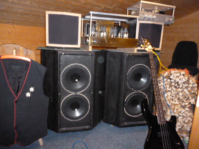

I use my Vampire 2 x 250W = 500W for instrumental Tyros 4 keyboard and bass guitar work, but no reason not to use bridged for Hifi.
Some differences; noise figure will be 6dB worse, distortion same, although depends on layout. The caveat with this technique is the load impedance; don't violate it (as one can do with solid state) by using a lower impedance than the equivalent match. This is the surest way of destroying a tube amp output stage.
Some golden rules; one will only get double power ie connect 8 ohm LS to the 2x 4 ohm taps and an incorrect lower impedance will create massive stress to the output stages and power supply too. It pays to have amps with a cathode current monitor, i.e the individual amp currents should be the same bridged with the correct load in case of incorrect setting.
So in the pic, bridged I use two 4 ohm LS cabinets in series = 8 ohms Z, connect amp to each 4 ohms. The speakers are 15" reflex; the port in the base makes use of the flooring and flat down to 28Hz.

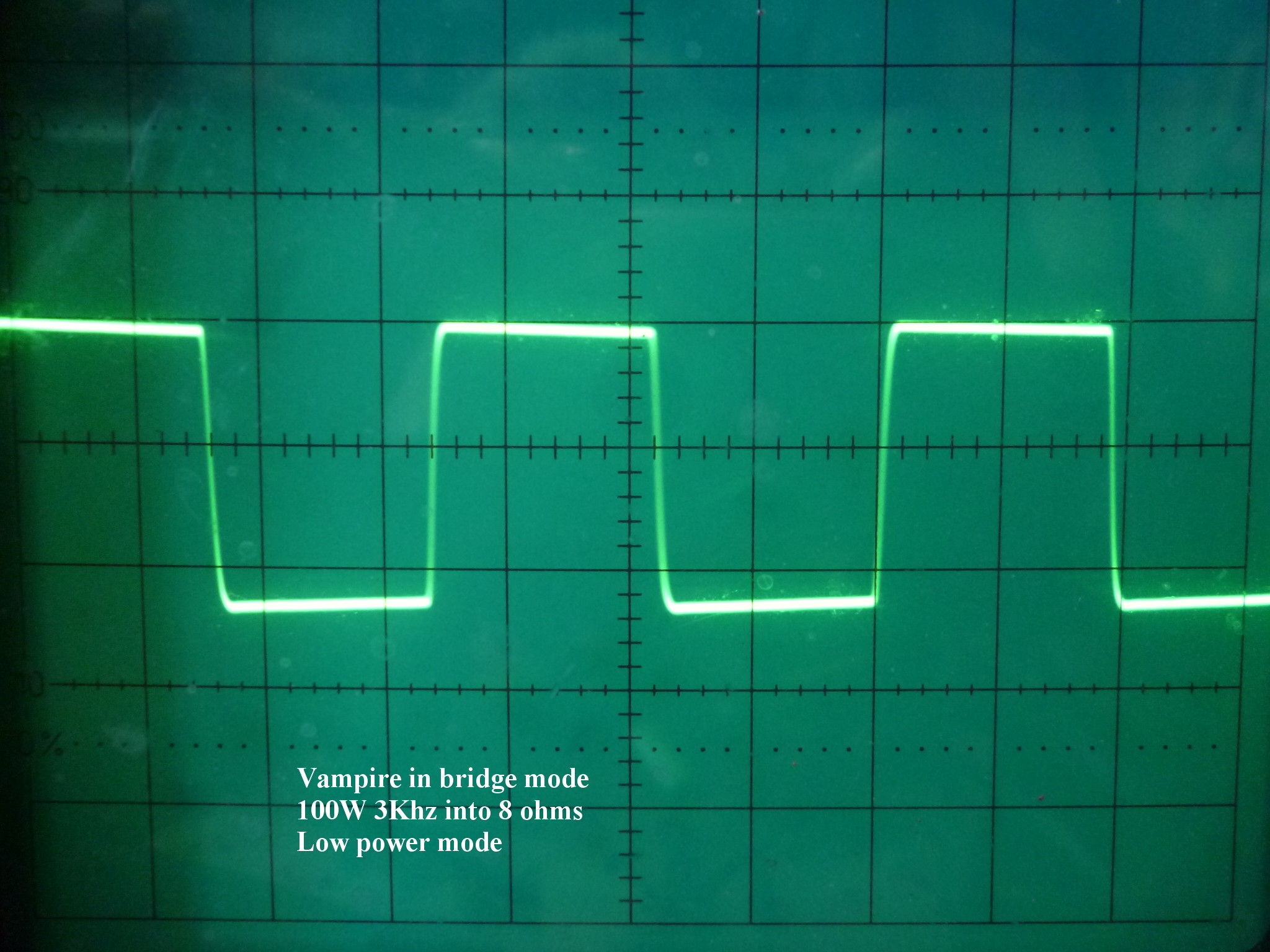

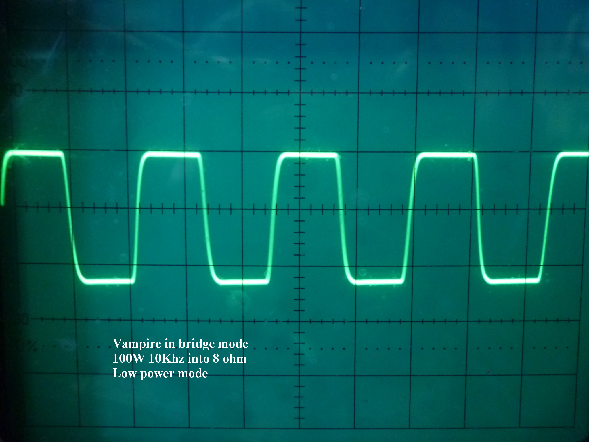

If both amps are close in tolerance then the waveforms should be exactly as per pics.
So in this example, total across thick black +red wires = ~30VRMS # 100W. expect no more, unless B+ is hiked up.
