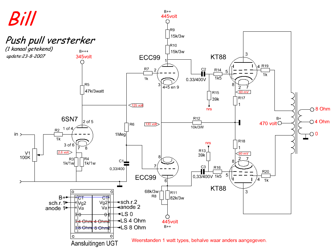

Hello,
I am planning to build a push-pull KT88 based amplifier. I would like to make it operation type selectable by using a switch, so I can operate the tubes at Triode, Ultralineal or Pentode, depending on my PWR needs, and mostly for audio comparisons purposes. Fixed bias provided by extra turn on xfmr.
I could use a different tube rather than KT88, but what the h*ck, it's among the best tubes in its power rating. I haven seen some pcb boards (like pmillet's) that come very handy if testing and breadboarding, but it will be a final assembly, not an amplifier to experiment, so I will P2P it.
What is a common, high-end, not very complex schematic to use? I don't really care if it is a complex desing, but life's such, that simpler ones use to be the better ones. I don't really need to be able to select between triode, UL and pentode, that's something I am able to put in by myself 🙂
If you were about to build ONE, with these requirements, what proved schematic would you implement?

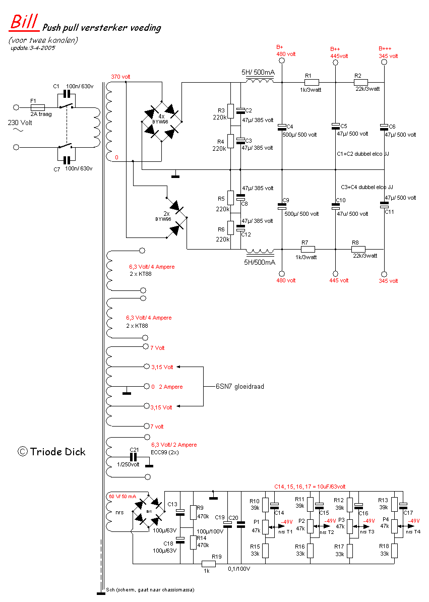

I think I am going with Triode Dick's, but I can't find anything related to output transformer impedance, power and other characteristics on its website. Do you know what is used in the original design or should I just calculate it?
Link to the translated website:
Bill Part 7
No feedback ?
This type of circuit usually benefits from some low feedback. The feedback will also affect the gain of the amps input/driver stage. Does anybody else think feedback would help on the amp?? What's the sensitivity or the voltage needed to drive the amp to full power?
