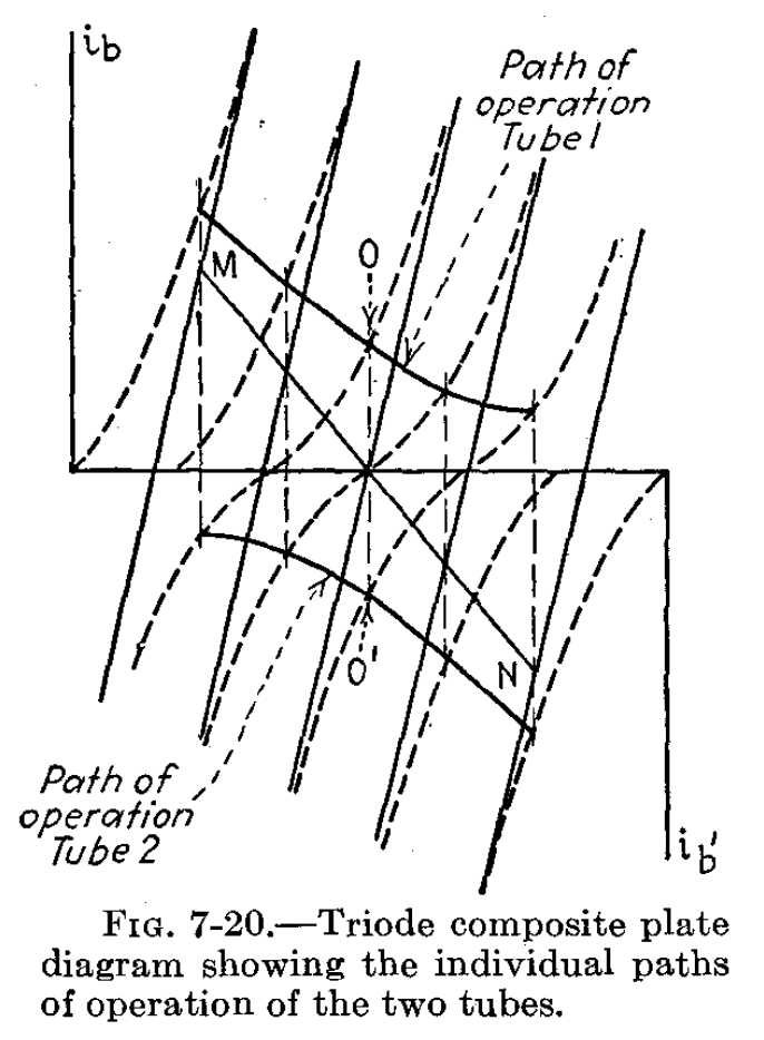

In PP both tube support the primary current in the output transformer. The classs of operation is about across how much of the cycle each tube conducts. The simplest operation is class A where both tubes conduct across the entire 360 degree cycle. Here is a PP load line which also shows the paths of the individual tubes operation.
