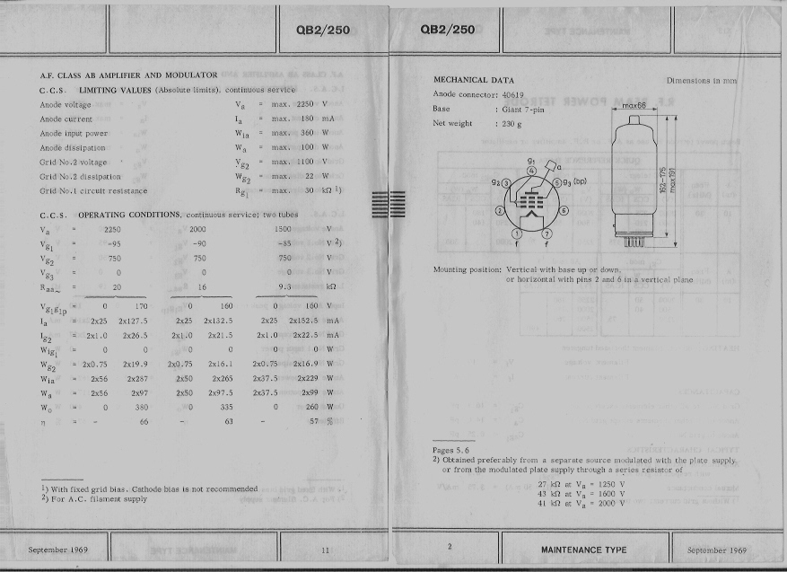

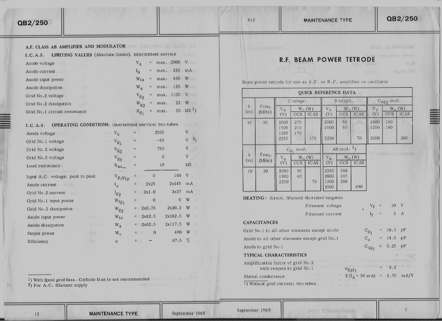

Actually two 813 tubes need only 1,5 KV on plates and 750 V on g2 to made Amp with made 260 W of out power,Raa is 9,3 Kohm.
UL operation is not necesary for this tubes to obtain low max distortion(2,5 %)since this tubes is beam power tetrodes(pentode)
CT (550V~) of main Tr. Uba secondary 1100 V~ /0,4A is good for Ug2/750 V suplly.
QB2/250 or 813 or GU 13 is the same tube, I prefer Russian GU13 tube,is the Best One !
All the Best
