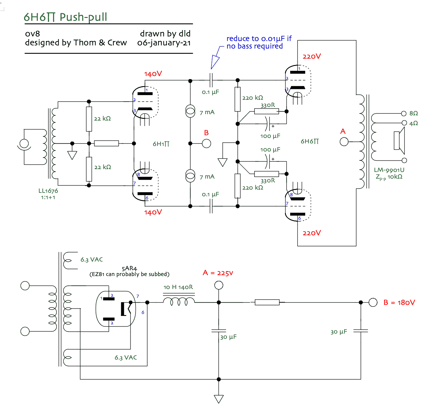

The 5AR4 needs a 5V winding, obvoiusly this is just a typo.

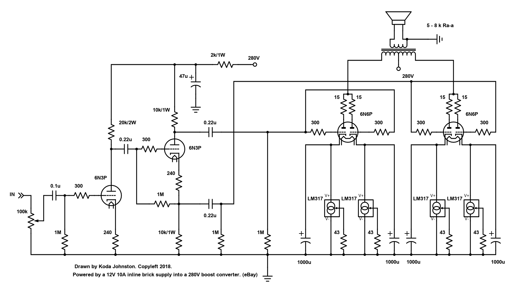

FWIW: This is the 6N6P amp I built in a cake pan a few years ago. It's a nice sounding amp for a super-flea.
The power supply is a 12V - 280V boost converter, and the heaters connect in series for 12V pairs.
Yep true, 5AR4 has heater 5V 2A, same as my transformer spec.
Good you noticed, now I see realize that my intended replacement EZ81 has 6.3V 1A, I read somewhere that heater voltage for rectifiers has wide range, so I wonder if it will still work well, or maybe give me higher voltage drop etc?
I wouldn't run the EZ81 from 5V in this application. It will be current limited and might even be damaged if the space charge is depleted in operation.
If you have a 5V winding, use a 5V tube. For a 6N6P amp you can even use a 5Y3 - or save money and power and use a pair of Si diodes 😀 You're already going to use CCS, right?
Ok then I will get myself more 5AR4, since I am somewhat voltage restricted with my transformers and want low drop, but like to use a tube for the slow start and glow..

Ya the cake pan idea came from trying to make the amp as cheap as possible. 4$ for a chassis is pretty good. The entire amp cost under 100$. I used toroidal power transformers as the outputs as a proof of concept - they were 10$ each. The most expensive single part was the 12V 10A brick that powers it. It was about 30$.
It now uses 6P15P (or 6P18P, I can't remember) strapped as triodes in a quest to lower the cost by another 10$.

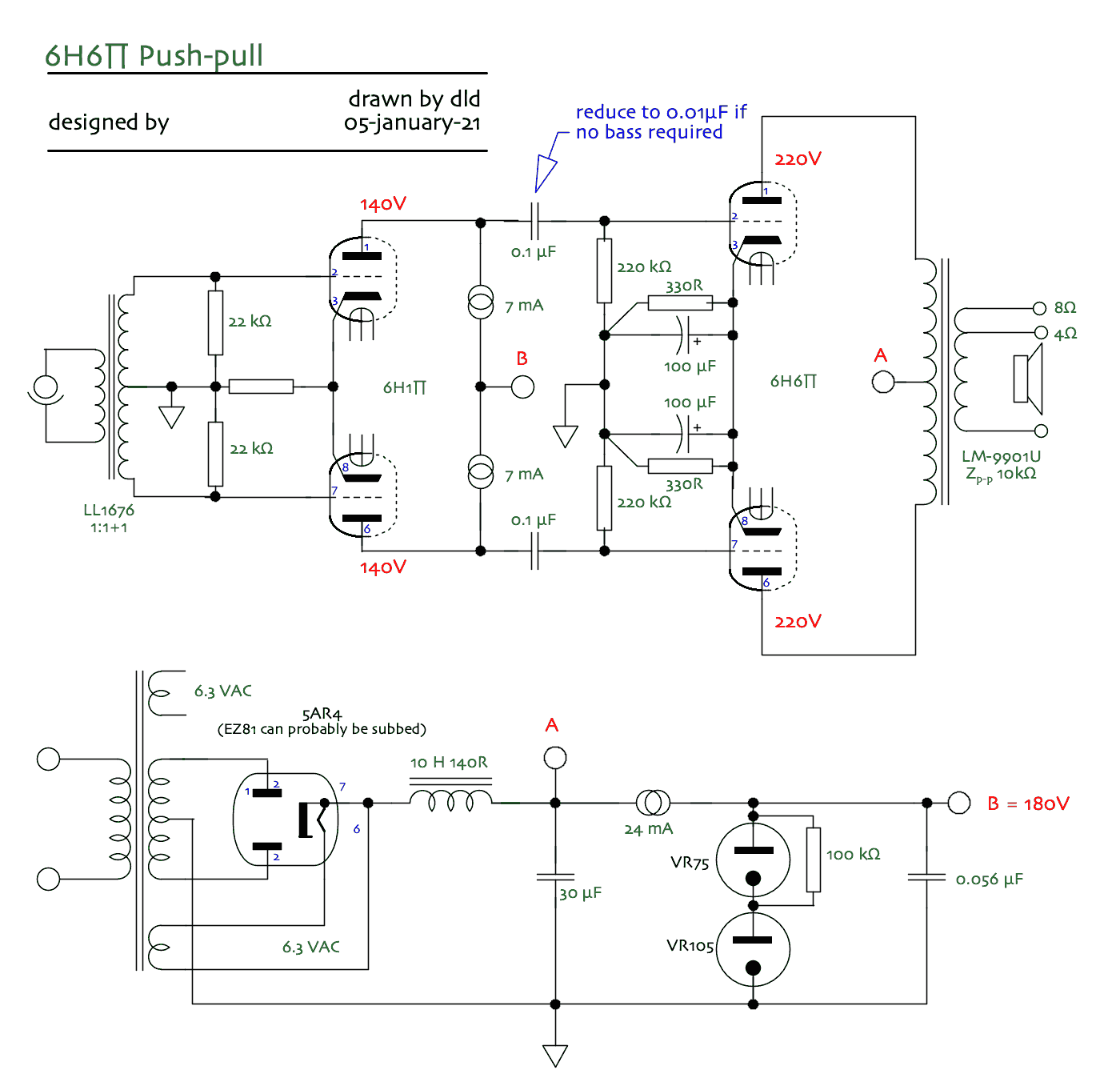

Instead of a tube diode for that "glow", I use a VR tube as a negative shunt regulator for the bias voltage 🙂 The 0B3 I'm using now glows a nice purple colour.
