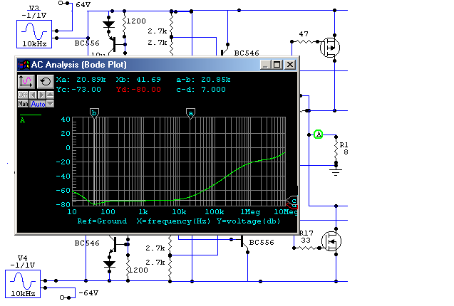

What is the purpose as well as necessity of C6 in this or similar circuit? Unfortunately it is not mentioned in the summary so I assume it should be obvious.
It's supposed to act as a filter for the bias voltage (created by R9 and D1) into the constant current sources Q3 and Q5.

Probably only makes for a relatively small difference, just keep in mind that a LED is not a regular Si diode, and indeed it's dynamic resistance is not as low. Although not directly applicable to this circuit, putting non-inductive caps in parallel with LEDs used as references can actually help at HF, I have found this is almost mandatory in cascodes. In circuits with zener references, the cap can help with noise filtering (zeners make rather good noise generators). With LEDs and in general, forward biassed diodes, this is far less of an issue.
C6 should improve power supply rejection ratio, altough Vbe fluctuations of Q3 and Q5 with Vce changes will still be a source of error.
Yes the presence of C6 across the LED impedance, depending on it's value will lower that impedance relative to R9 so improve the stability of the current source and the power supply rejection from the -ve supply AT HF!
Of course C7 will do exactly the opposite at the +ve supply. You can see/quantify the effect by doing a sim of the cct with a sig gen in each supply lead and doing a bode plot (magnitude dB) to the output. Simply change the C values to quantify the effect.
Since PSRR is an input referred quantity and the graph is output, simply subtract the gain of the amplifier (example 29 dB), so the PSRR over most of the audio band in the example is 102dB.

What if you replaced D1 with a bjt current source, base to emitter of Q3, emitter to -Vs, and collector to base of Q3 & Q5, lose R10 and adjust R6 & R15 to get the same current. (0.6V) Then would there be a need for C6? How about PSRR?

Regarding the use of C6 if you improved the CCS to a two transistor one, the answer can be seen in my example thumbnail. The right value of C6, used with a 2 transistor current source is responsible for the kickdown (improvement) in the PSRR to 80 dB (+29 dB gain = 109 dB). A lesser or greater value was less effective. It's a good frequency to have extra PSRR - in a freq band where real power can be often demanded.

And, if anyone's interested, here's the PSRR of the same design I exampled earlier - but with just resistive tail resistors on the input stage instead of 2BJT CC sources!
Once again adjust down by 29dB for the amplifier gain. That's 71dB total and over 30 times inferior to the CC source! Also,
102 dB < 0.001% in THD terms while 71 dB is 0.03%. How much of your THD would you like coming from the PS commutation hash?
