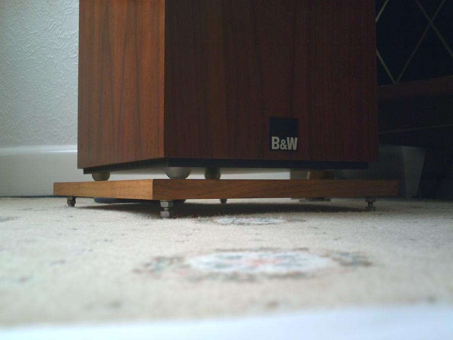

Best of both worlds.
This is what I use, the neoprene/silicon feet on a plinth which is itself spiked.
I am no mechanical engineer, but you seem to be saying that 4 tiny points of contact (the spikes) transmit the low frequency vibrational energy of the cabinet relatively unattenuated to the surface below.
If the speaker stands on the floor directly ( my wooden floor 🙂 ) the floor vibrates as you might expect. Use the spikes on their own-no plinth and it doesn't.
If I were to whack a big hammer
on the floor the whole room would shake. Whack a thin nail with the same force into the floor and it won't.
What am I not understanding ?

If I were to whack a big hammer on the floor the whole room would shake. Whack a thin nail with the same force into the floor and it won't.
I'm not sure this is correct. If the nail does not penetrate the floor, the force transmited would be the same, and the effect in the room would be the same.
The situation is not the same if the nail is able to penetrate the floor, but you wouldn't want that with speakers.
This brings us back to the argument that the spike does in fact alter the nature of the coupling, at least on an anisotropic flooring material. Less dramatic than a nail penetrating several millimeters of wood, but involving a far more dynamic, and different, mechanical interaction at a the spike point versus a much broader surface.

Perhaps the key is in the nature of the wood in my case. The spikes do penetrate quite deeply 3 or 4mm I would guess, so the energy dispersal must be "modified" in some way.

If a spike has the shape of a conical pyramid, it attenuates the energy entering the large end towards the small edge by a ratio equal to the ratio of the surfaces of the two edges. Isn't it so?
That's why spikes of that sort are usually used under the Turntables, this time in their "upright" orientation. Under the speakers they should be used "upside-down" to the same effect.
And best results should be obtained if the spike end of the spikes rests on a metal plate rather than on the wooden floor or carpet, as doing so increases the surface of contact between the spike and the floor/carpet.
Isn't that correct?
Isn't that correct?

I agree. When you place spikes in low resonant locations you have reduced the potential to excite the substrate dramatically. 4 little points cannot do what a vibrating diaphragm can. I think spikes decouple acoustically and have the ability to anchor mechanically.
IMHO an isolation pad under a speaker has a far better opportunity to transfer energy to the floor than some properly placed spikes. If the whole bottom panel is in contact through an isolator, it's still connected. The isolation pad also allows for the speaker to "float". I can't see that being a good thing.
Just my thoughts.

Well... what I was taught many decades ago was that the spike acts as a sort of diode. That's why it's a spike.
The energy is allowed to drain away, but not come back. One can easily image how that might be a good thing for speaker cabinets or turntables.

If my memory is not failing me completely, one of the reasons for decouling speakers from whatever they were standing upon was to limit vibrations getting into them from the external environment such as cities, where most people live. Well, cities are quite vibrational.
The other important reason for using spikes and whatever was to decouple the rest of equipment from vibrations - mainly turntables. Speakers vibrating the floor also vibrate the turntable with known consequences. The main problem here is taht most of the materials including spikes do not decouple low frequencies.
For a very long time, well before spikes were invented, I have been using piles of old papers and phone books as base speaker stands. It does not look Versaille but works fine in most cases. One only has to keep ones wife away from trying to improve on that solution. In my next step, one day, I'll try to add spikes between paper and boxes. Has anyone tried that?

Spikes act like as springs. Very rigid springs.
The combined effect of Mass ( speaker) x springs = Resonant Frequency normally located in the 1-3 Khz.
This is bad because the system work in elastic reaction. The system is coupled below the FR and decoupled above Fr.
The woofer shake your floor and viceversa.
Diodes do not exsist in mechanic .
If you want seryously decoupling all the frequencies 20-20000Hz
you must employ a subsonic FR ie employ a very soft souspension,
ideally below 5Hz with the minimal damping (important).
In this case the system works in inertial reaction.
The souspension filter the armonic spectra of the reaction that the floor act to the speakers movements. This is good because you minimize the exchange forces (vibrations) and maximise the immobility in the audio band.
Yes the speaker float but it is near immoble in the audio band.
Best method to obtain this are air spring or use long elastics from the ceiling ( bad WAF )
You can solve all your problem of vibrations , as like every Lab in the worlds do : air spring or elastic cables tuned subsonically.
