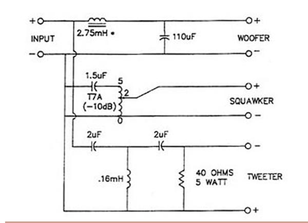

On my old Klipsch Forte 2s I was looking at the crossover and had a question. The tweeter has a 40 ohm 5W resistor in the circuit but I'm puzzled over its function. I thought pad resistors had to be in series or series/parallel to the tweeter. I haven't seen a speaker run a single resistor in parallel. What does this actually do? (see attached)

Depending on the tweeter the impedance curve can dip way below nominal level.
with higher order filters.
Parallel resistor will flatten Q at the cutoff, and also raise the impedance curve to more
acceptable levels.
I have seen " 4 ohm" nominal tweeters dip down to 1 or 2 ohms towards higher frequency.
parallel resistor raises the curve back up to 4 ohms.

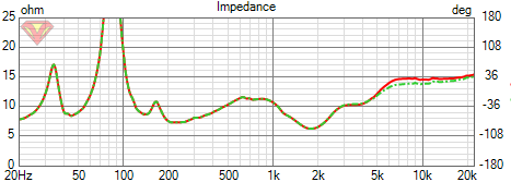

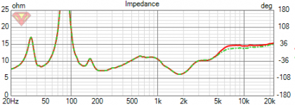

It is not that simple... It will lower the complex impedance only of resistor plus driver combination (parallel summation), but how will react high-pass tweeter filter on that, producing the total loudspeaker impedance? Like this real-world example:
Dashed impedance with green color is without R=40 ohms, bold impedance with red color is with R=40 ohms parallel to the tweeter. All other crossover components are the same.
Of course, total impedance change with such a parallel resistor may be completely different with other crossover and other driver.
