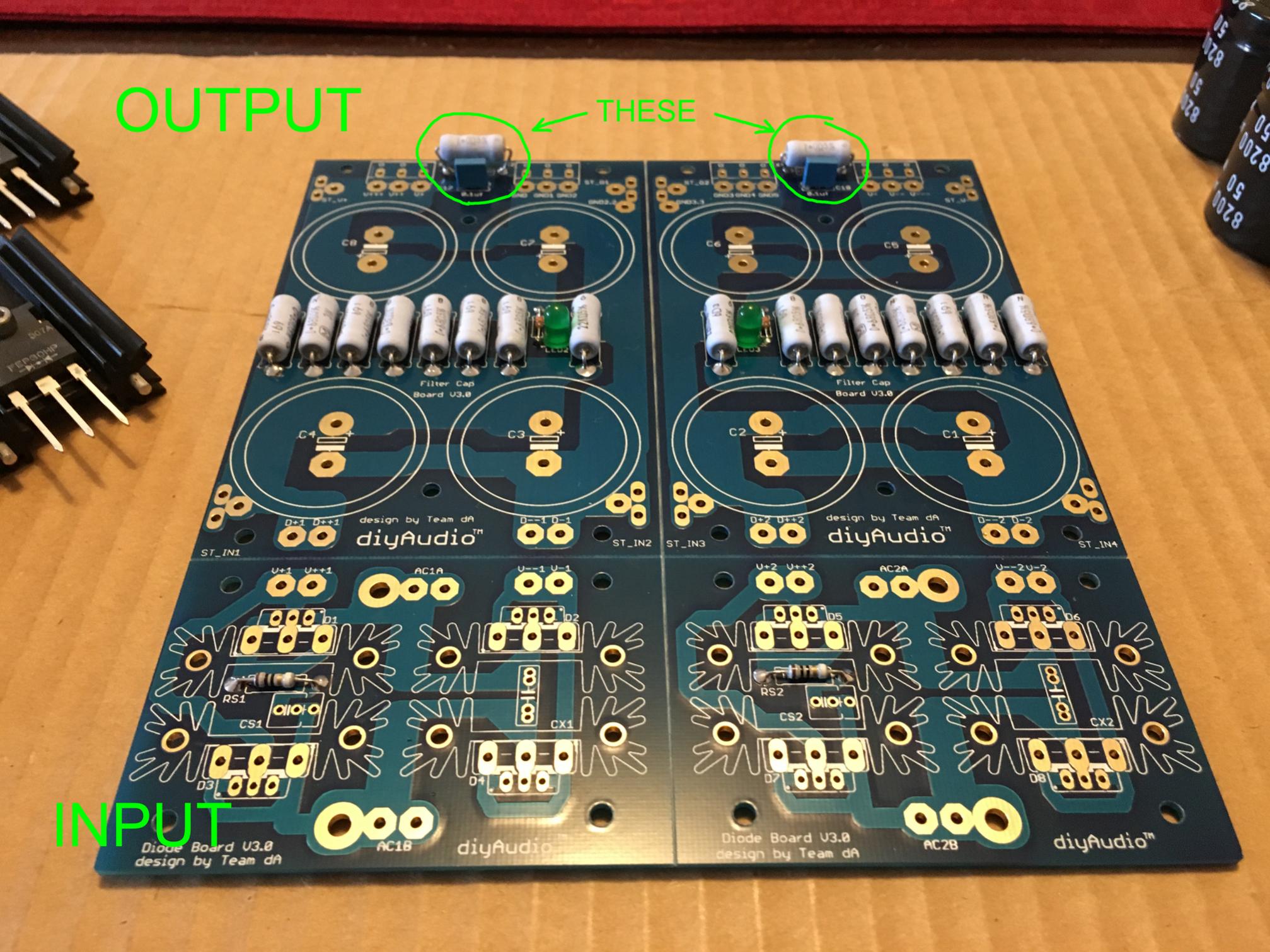

AndrewT, to help clarify, here are pictures of the "snubber" I'm referring to:
It isn't a snubber to stop ringing in the transformer from diode switching; neither is it part of a Zobel network on speaker outputs. It seems to me to be designed with the intention of dampening any ringing that might go back and forth between the output of the power supply and the actual amp circuitry/boards... that's my guess, anyway.

An amplifier output snubber/Zobel network is pretty common practice. In a power supply, I install them on a transformer secondary winding or across rectifiers to control ringing when the rectifiers turn on. (stored charge across the diode junction causes a fast current spike) A generic value is not optimum; I found it necessary to 'tune' values for maximum suppression of ringing at high frequencies. Resistor and capacitor substitution boxes make it fairly easy (try to keep wiring as short as practical).

Remember that R11 and R12 can only "snub" (alternate term: "damp") unwanted ringing, at frequencies sufficiently high that the impedance of series capacitor C17 is less than the resistance of R11. At lower frequencies, the series capacitor acts as a high impedance in series with the damping resistor, preventing the resistor from doing its job: damping.
Let's calculate that particular frequency, in the case where C17 = 0.1uF and R11 = 1.0 ohms:
  • R11 = 1 / (2 * pi * f * C17)
  • thus
  • f = 1 / (2 * pi * R11 * C17) = 1.59 Megahertz
The R11-C17 "output snubber" only has an effect upon ringing frequencies greater than 1.5 MHz. I think it unlikely that the output of the PSU will ever ring at such a high frequency. It would certainly be easy to connect an oscilloscope (AC coupled!!) to the PSU output and observe the AC waveform, before installing the R11-C17 "snubber", and then again after installing the R11-C17 snubber. Try it and see if anything changes. I'm wagering the answer will be: no.

There is nothing to 'snub' at the output of a normal linear DC PSU, so no need for a snubber. It does no harm, apart from costing money. People often add them because, like guitar amp 'standby' switches, they know that other people expect to see them.
Snubbers across rectifiers are sometimes useful.
There can be ringing due to the diodes abruptly switching off and the inductance of the transformer.
It isn't just about frequencies above 1/2piRC either, since the cap may be resonating with the transformer or wiring inductance.

The diyAudio power supply board includes additional components which snub out ("damp") transformer inductance ringing. In the photograph attached to post #4 of this thread, they are seen at the bottom. "RS1, CS1, CX1" on the left; "RS2, CS2, CX2" on the right.
The component names on this board, match the component names in the "How to snub your transformer without using any mathematics" tutorial document attached to post #1 (here)
Yes Mark, I've got the quasimodo on order and am guessing my RS1 value will be somewhere 10 ohms for my Antek AN-5220 (with caps being 0.01 and 0.15uF). This guesstimate is based on the values for similar transformers. Once I get the quasi jig I'll be able to fire it up and check the scope to get optimal value.
I'll leave my p/s output snubber in place since I've already soldered it onto the board.
