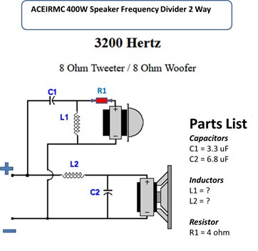

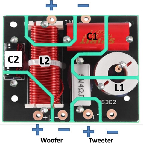

This leads me to requesting thoughts on the design of this budget off the shelf 2nd order crossovers (see images). Face it, it is cheap at $9.50 but it was a significant improvement over the original 1st order crossover I replaced. As a note, I did replace the 6.8 uF electrolytic capacitor with a poly film capacitor of the same value. That is one large capacitor!

1.What is the purpose of the 4 ohm resistor installed for the tweeter in this general application crossover? I ask this since my woofer and tweeter are within 1db sensitivity so why would this 4 ohm resister be added?
2.If I where to add an L-Pad to the tweeter, would I remove the 4 ohm resister from the XO?.

The resistor is there to attenuate the tweeter. Decrease or increase its value to increase or decrease the treble level.

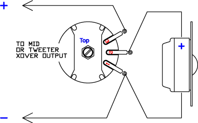

If you were to add a variable L-pad control, you would remove the resistor.

Thanks for the info so far. So in my project with both speakers being 8 ohm, Shorting the resistor would be a good place to start. If my tweeter would have been a 4ohm, then this may explain the 4 ohm resistor included in this off the shelf XO. Does that sound like a logical explaination for the resistors addition to the circuit in a generic XO?
@mteetank
The resistor is included in this generic crossover because the tweeter is usually louder than the woofer.
As has been said, the inclusion of the resistor makes the tweeter quieter. The value of 4 ohm for this resistor is only an estimate made by the crossover designer as to how much attenuation of the tweeter level is required, and the resistor might usefully be changed in value to suit the actual tweeter used.
Importantly, you should make sure the commercial crossover you are using is designed for 8 ohm drivers like yours and not for 4 ohm drivers. Crossovers come in both 8 ohm and 4 ohm types and you need to use the correct type to ensure the drivers blend together correctly.
