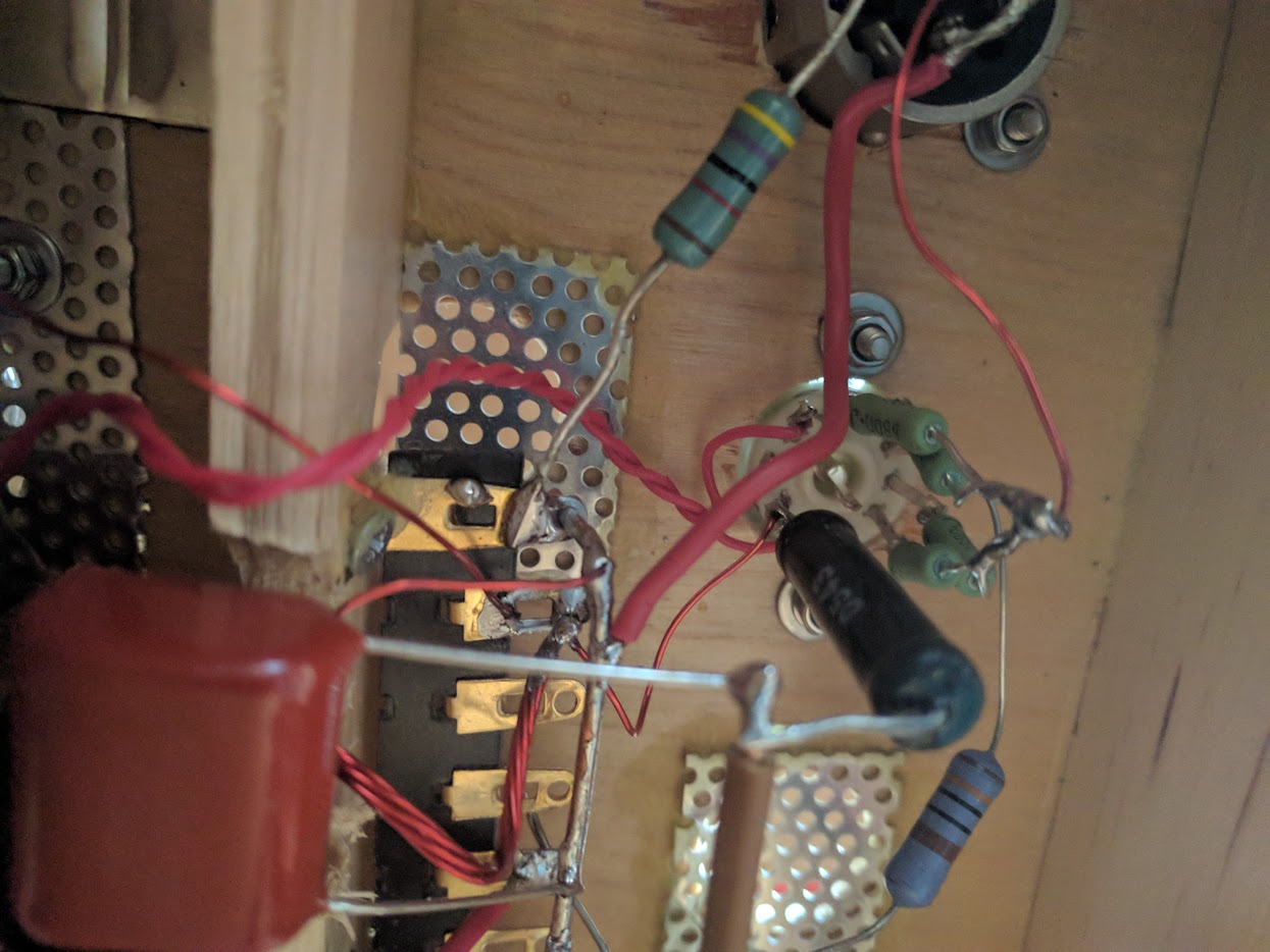

Not an answer really..but beads such as in the picture should be fine. Anything should be better than none. Also included is a picture of my 5842...without heater beads but with a cc resistor 680R on each grid (I could have cut the socket pins shorter...but I wanted to keep the socket pins intact) If I had used shitty sockets...I would have...(but these Russian military sockets are the bees knees and getting scarcer on ebay). My amp sounds lovely.
I don't think oscillation is audible? I don't hear anything amiss.
IF I ever find those little beads as in the picture in my hobby room (I know I have some)...I might retroactively fit them to my 5842.
